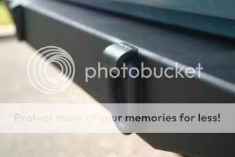

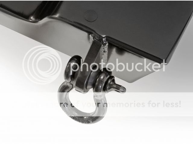

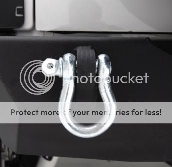

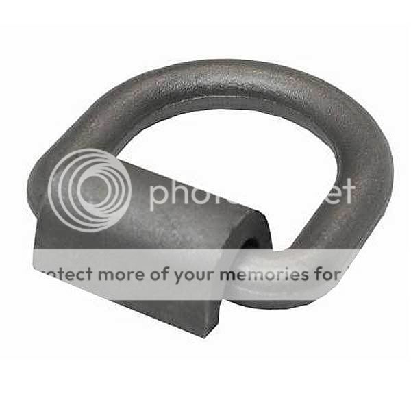

Which way do you guys prefer to hook up your d-rings? Are there Advantages or Disadvantages to one or the other.
- Tab Weld-on Style: I'd probably just buy some because I'd have to buy a 7/8 drill bit to make them which is probably more expensive.
- Tube Weld-on Style i guess it's called.. with screw on d-rings.
I like the cleveces because you can take them off and they won't make noise, you dont need a hook for them either but he D-rings are quieter. The D-rings are stronger though. It's a toss up: do you wanna have to put them on every time you need them or have to have 2 extra clevis' at all times?
Hmm, Good point. It would probably be better to go with the clevises that way i could use hooks, and or a loop style strap easily. I would also be able to take them off, so they wouldn't be annoying clanking around. Thanks once again!
