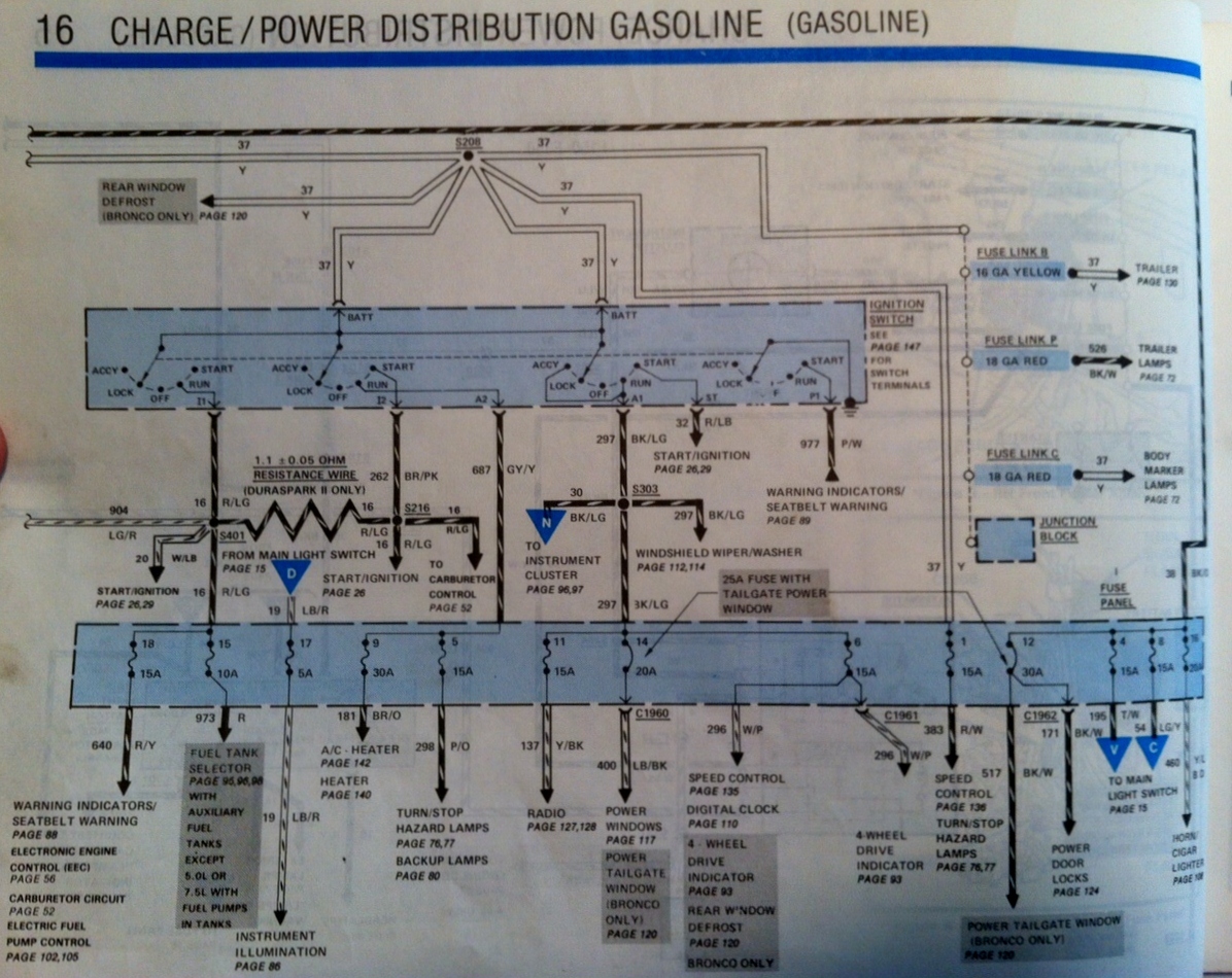

Okay so I need a little help!!
Can someone please tell me what wires do what in my steering column like what color wires operate or do what?
I am wanting to install an ignition switch panel in my ranger and don’t know what wires I need to use.
My truck ( Vegas) is a 1988 Ford Ranger Xlt 4x4 with a 2.9l V6 with an FM-146 5spd transmission.
Thank you in advance for any help/ assistance you can give!!!
  • Wiring help needed!
nice rig.
the yellows should be main power....the red green should be crank/run and red blue crank. there is a brown and a few others.
just function the switch to be certain with a volt meter.
