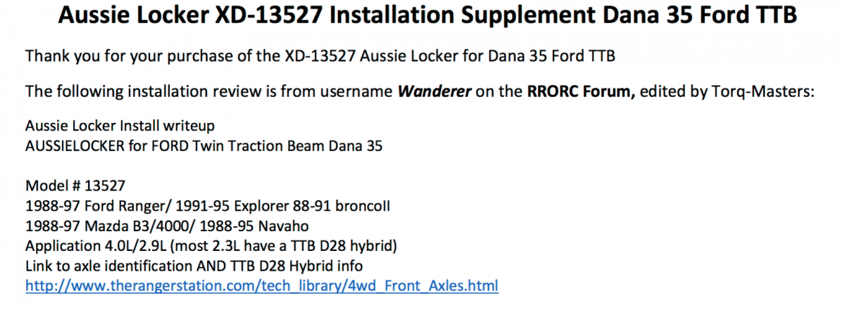

Hey guys I’ve searched and could find and which Aussie locker are you guys running, ive seen conflicting results, aussies web site calls for the XD-13527 on their supplement guide for installing on a D35 TTB but on their site this doesn’t specify any ranger, but does say 88-97 Mazda pickup front locker, then on amazon they state this is for pre 93’ truck only...
But when you search a specific vehicle on their site they call for XD-13530 for 1997-2000 ford ranger front axle, which doesn’t seem right. I have read some people getting the wrong one. Anyone know which is the correct one?

You have the D35 TTB since you have a 4.0 truck, 1997 is the last year of that axle. I believe the XD-13527 part is the right one for your truck.

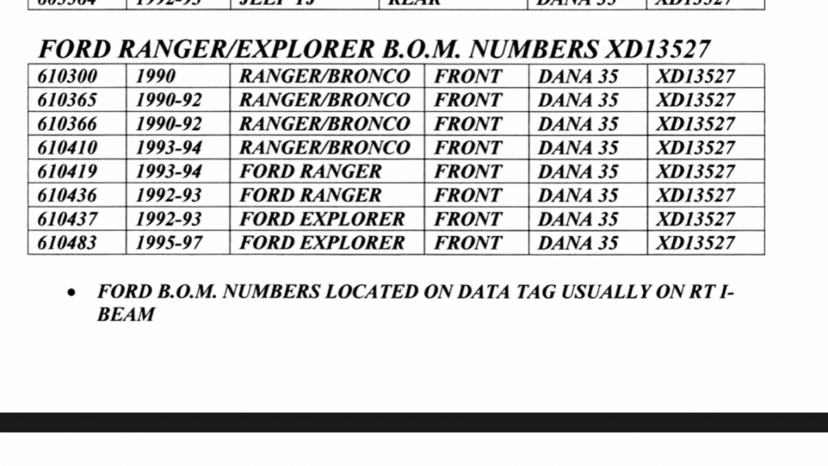

I’ll try to remember to check the parts list from my build when I get home tonight. Mine is a 93, D35 ttb . Should be same as yours

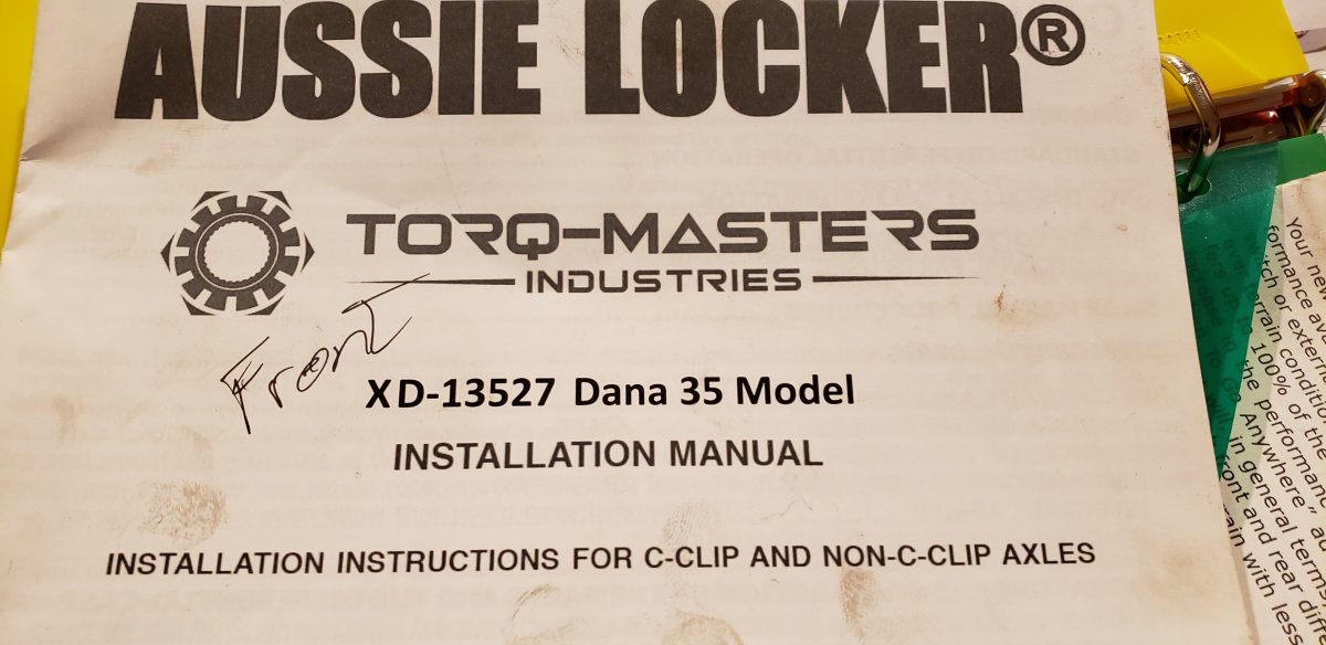

This is what I installed. Works great.

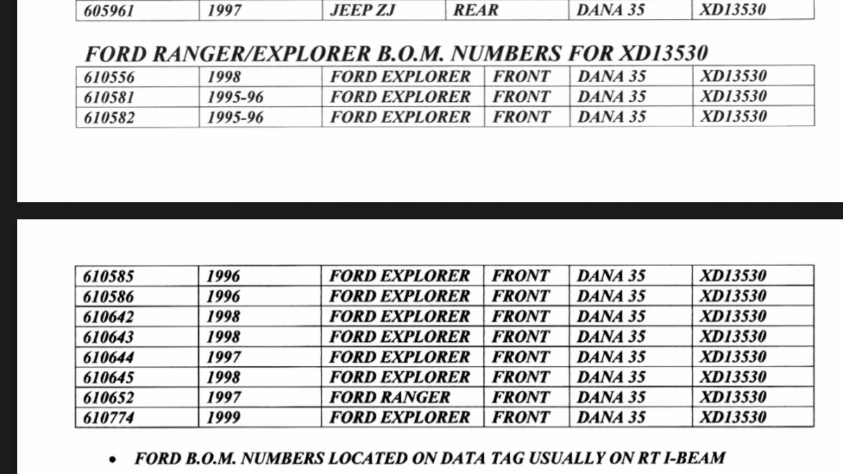

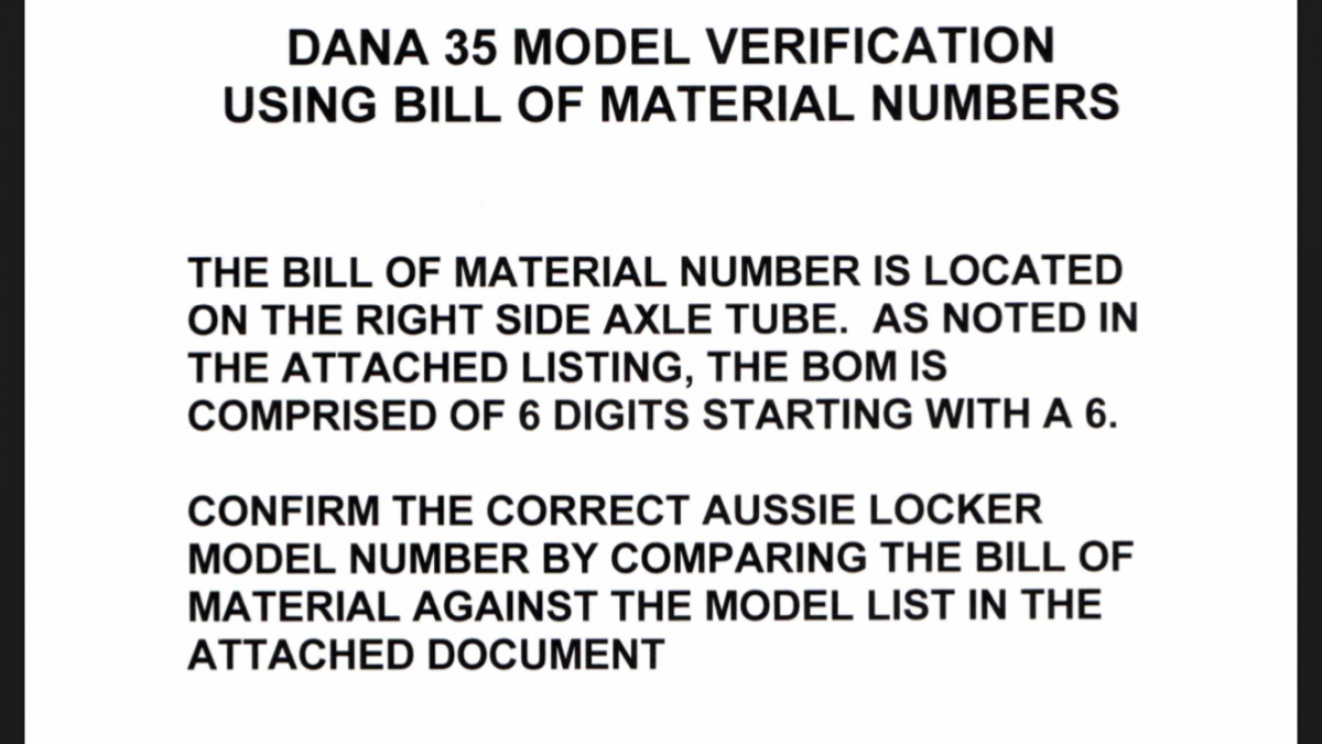

Okay, another updates, i went and looked at my axles and my BOM number is 610652, which you can see on the last chart it does say 1997 ranger front, so this now tells me i need the XD-13530 locker for my truck, i also found the thread where the guy i was talking about (Legoms013) had a similar issue and i believe he is saying he had to get the XD-13530 as well for his 96 ranger. its a little hard to follow but i think he tried the XD-13527 and it didnt work.
Dana 35 Locker thread here
So i am waiting for the guys at Aussie to call me back and lets see what they say, but that chart i just found i think is the key to all this.
Let me know what you guys think.

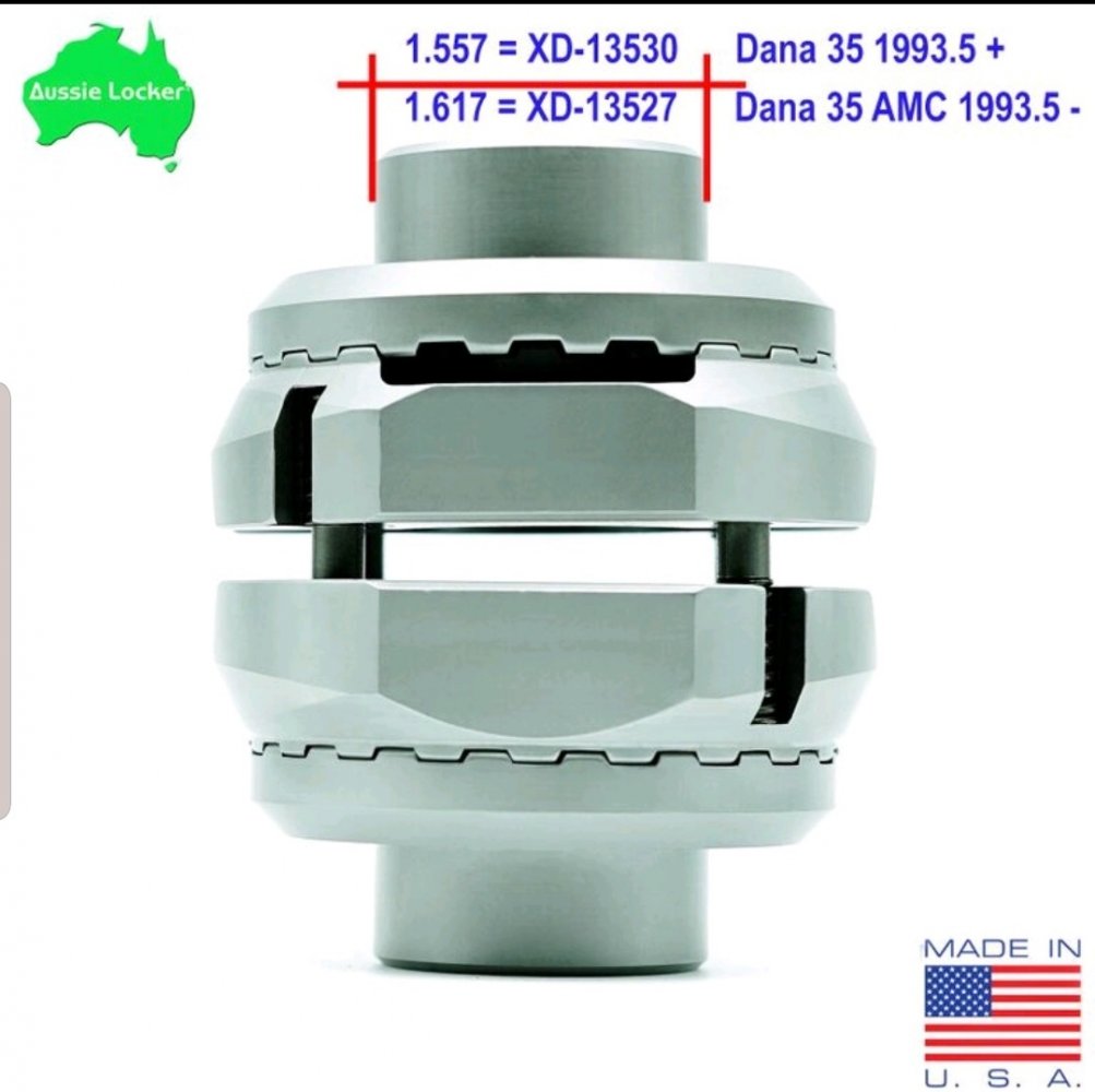

So i did get a call back for the people at Aussie, i can tell they do have wonderful customer service and that was very very refreshing after one of the worst exeriences with Skyjacker, SJ may be well built but the service is about as low as it can get unless they just never responded. Anyways back to the aussie, i was told that these later TTB's are hard because there are some variants she told me to probably go with what the BOM chart says (see above) and if thats wrong contact them and they will exchange it. Well it wouldnt get here for 7-10 days and i can get the proper lock-right here by friday so i ended up just going with the Lock-Right, i really wanted to go with the Aussie because i have heard good things but if i can get this whole front end done by next weekend ill be even happier. so without running either i would recommend both companies both were knowledgable, friendly and helpful.
but the lady helping me did give me this pictures which tell you exactly which one to get, the only caviat is you have to measure your spider gear to know for sure, so this helps if you dont mind having it dissasembled and then ordering, but i hope this following information was helpful and can help someone else with picking the right on the first time.

I would be confident in buying the XD-13527 for a '97 myself if Eric B successfully used it on his '93... The XD-13530 looks to me more likely that it's for the '98-'11 IFS D35.
Aussie is all sorts of screwed up on their applications...
