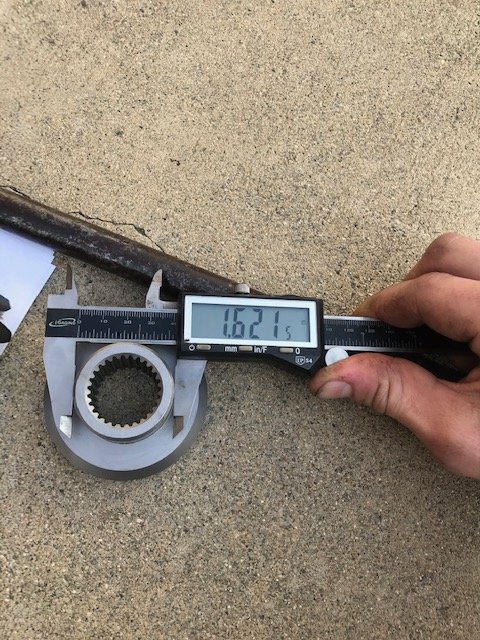

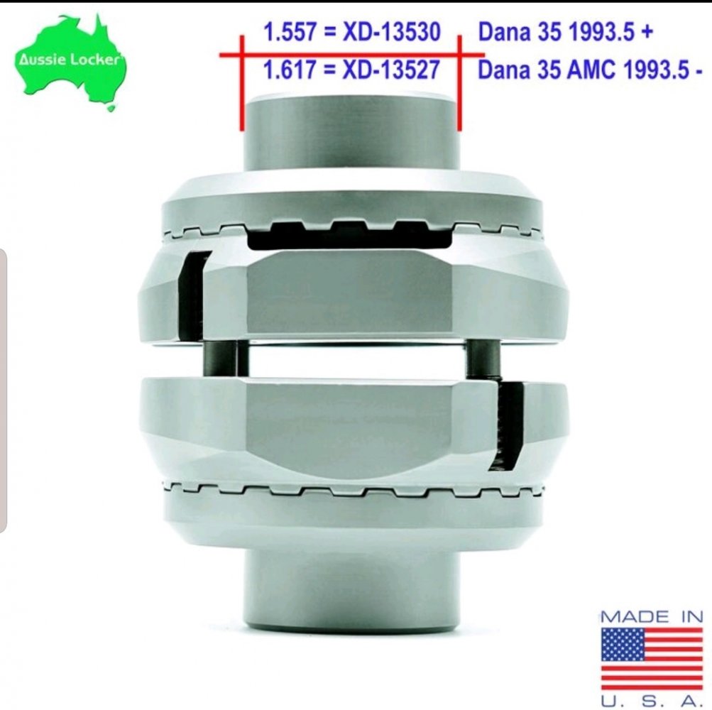

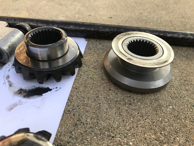

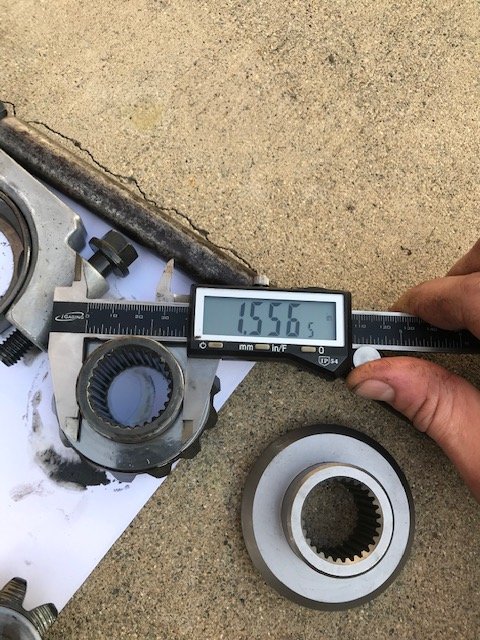

Alright well i got the aussie locker in (XD-13527) but it doesnt fit! lol i had a 50/50 shot and it ended up being the wrong one. As you cn see in the picture my original side gear and shim are smaller than the aussie locker i ordered. so i am now sending it back to get the correct one (XD-13530). so that diagram with the 2 measurements below is correct, also if i would have ordered it in accordance with my BOM # it would have been right. But live and learn and now we can pass the word to use the BOM chart for ordering, but it is interesting that there is such a variance in our front diffs. so i ordered a new one tonight and am in contact with aussie to get this one back to them for a refund, just sucks ill have to pay shipping. see pictures below for the size reference and you can see the shim from my gear sitting on the aussie and it will not fit over it.

View attachment 35625View attachment 35623View attachment 35624View attachment 35628

Damn well sorry to miss lead you, that sucks. I did order mine for a '91 D35 though.
Oh don’t feel bad it was a 50/50 shot and even the company wasn’t sure which one. I should get, but it’s just odd that the power trax guys dont run into this issue since it’s almost the same thing, anyways at least there is some good info about it now and I’m fine being the guinea pig

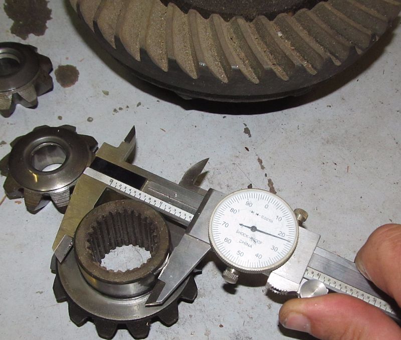

I found my old '94 carrier, took the gears out and whaddayaknow:
So now I'm wondering if '95 was the changeover year?
Anyone have a '95 or '96 Ranger carrier laying around they can measure? (or alternatively, anyone with said years have a lunchbox locker up front, and can confirm what pt# locker you used?)
(hoping we can soon get to the bottom of this)

As for the locker i did end up needing the XD-13530 it went in with only one little hiccup but it was an easy fix for my stupid mistake, i didn't line up the cut outs on it, so i just had to pull the springs and 180 one of the gears. i also decided to run heavier oild i believe 85-140, to help keep it quiet and in hopes that if there was any leak that the thicker oil will have a harder time escaping. but with all that done its time for a shake down and only a couple other little mods before the BAJA trip! this truck is really coming along.
so we know that for a front aussie locker that 1996-97 for sure need the XD-13530 and somewhere in 94-95 was the change over
