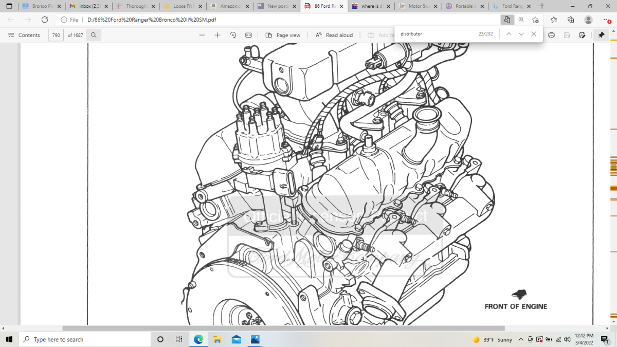

i have hunted and hunted and i cannot find this damn thing back there. i found two nuts that are 13 mm on either side of the distributor but they don’t loosen it a bit. please help pictures appreciated!

He said he can't see it...and I assume the intake is off with all he is doing.
I didn't know he has it torn down...
But he did ask for a picture... so I obliged.

Distributor hold down bolt is at the base of the distributor, screws into the block, usually has a "Y" type fitting that press down on the distributor base to prevent it from turning
You have to feel for on the 2.9l because its at the rear of distributor so hard to see it
Often 1/2" or 9/16" heads
