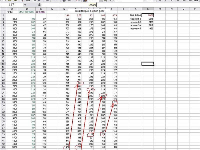

When my truck was bone stock, I could hold it to the floor in first and not get 5k rpm out of it. Opening up the exhaust and installing a cold air style open filter and I can hit 5200rpm easy in first and 2nd, but it gets a little windy in 3rd. It makes peak horsepower around 42-4500 RPM, but you if your really gettin on it you need to go past that so when you grab another gear your rpm falls back into the higher hp range rather then below it.
This is the torque curve for the pushrod 4.0, 1999 I think.
When you find the total torque in each gear it makes it pretty clear when not to shift. You don't want to give up available torque in the current gear. When you do shift it should be because your torque is falling away, as you can see at the top of third, for instance. If you keep accelerating past 4,600rpm your total torque will drop to 221ft# at 4,700 where if you upshift at 4,600 instead, you will find a 223ft# spot in 4th.
Keep in mind these are wide open throttle curves. If you aren't driving for maximum performance (racing or towing) then I would disregard the charts and drive by feel. I think using the least amount of torque necessary would be the best plan. That doesn't mean avoiding the best places in the curve, it means avoiding having to stick your foot into the throttle.

Thanks for all the info. That spreadsheet rules.
Thanks. I uploaded the actual sheet now. I did the SOHC 4.0 as well but I'll have to look for it.
