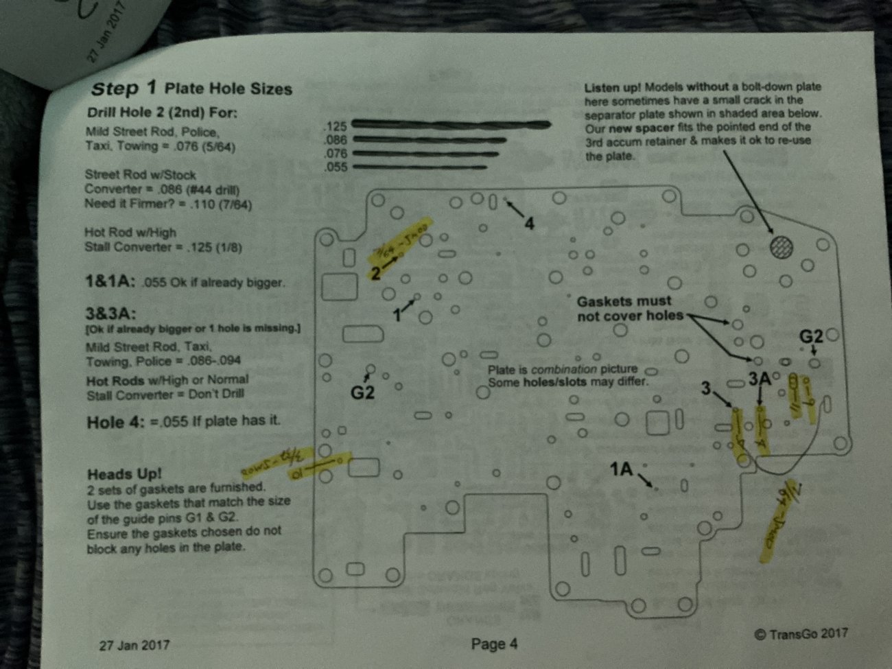

Separator plate:
Jmod says drill 5 holes to 7/64” and one to 3/32”
Shift kit has slightly different drill requirements. Some are similar and some are not. Below is a pic, I highlighted the Jmod holes.

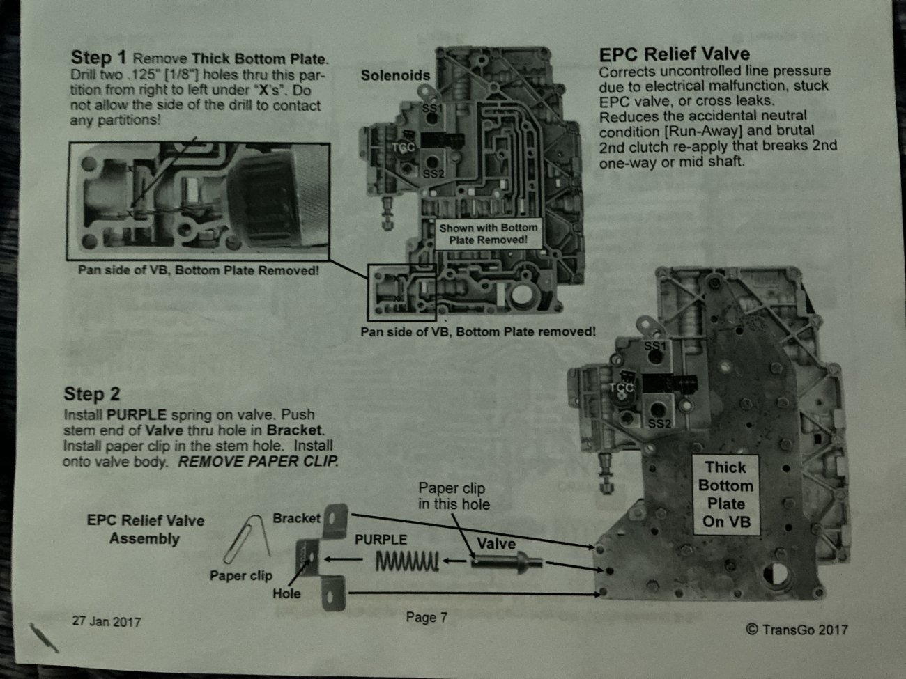

The Jmod doesn’t really seem to do anything else. The shift kit has a few valves and springs to do in the valve body which I intend to do. I’m also intending to skip the one check ball.
Last, the shift kit comes with an EPC Relief Valve. Bunch of kits I saw installed completely ignored this (everyone mentioned the Driver Command though and said don’t do it, which I didn’t intend to do anyway). I’m wondering why nobody mentions or does anything with the EPC Relief Valve.
