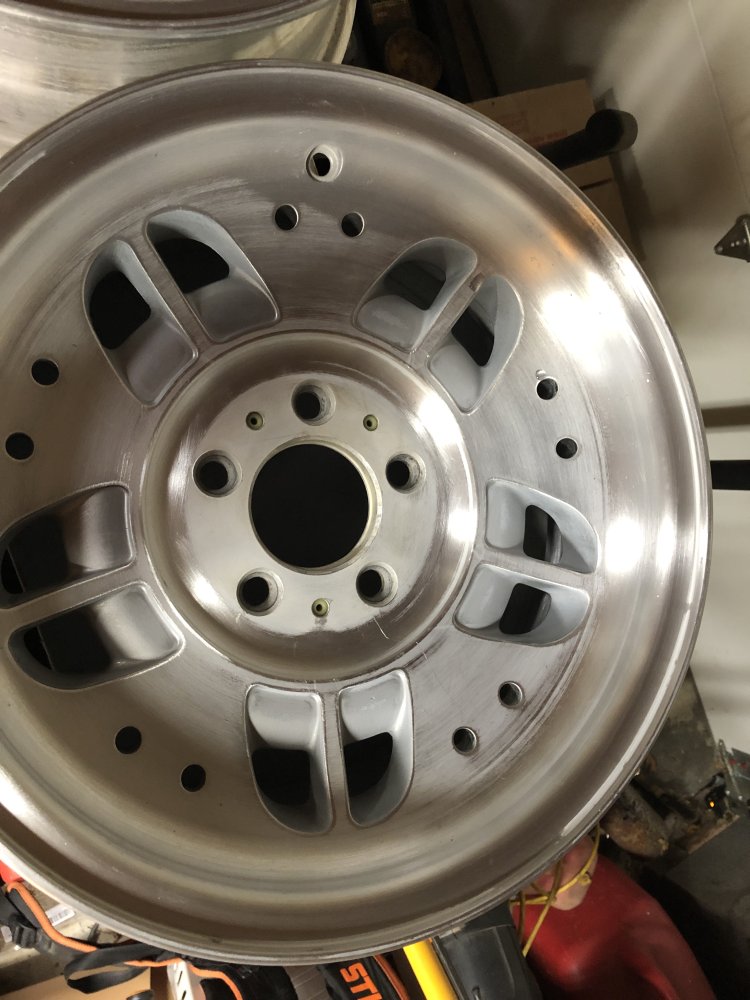

...they are going to have to be smuggled into the basement to outgas for a few weeks. I may even setup a space heater in the utility area and block off the furnace vents in there to help a little. I'm hoping i can pull it off without any notable odor so I don't get busted. I'll be sleeping in the shop if I stink up the house. I'll start taking pictures as soon as I get the surface prep done. As of now, this is where i'm at, and the photos don't really do it justice. I've gotten all of the scabby areas blended very well. ...

I'm doing final wet-sanding today as I get breaks in between phone calls. I'm having to do it in the shop with spray bottles though, it's so freekin cold outside. It's really kind of pointless since I'm trying to preserve the "lathe spun" look markings on them. I am mainly focusing on thedeer print sections where I did not sandblast so it's got some teeth to bind the primer. I'll clean and wrap them to wait for the weekend, it's supposed to burst back up to 65 degrees and I want to take advantage of that. The only thing remaining is I only have 1.0 tips for my touch-up gun, and I really don't want to run epoxy primer through my good guns either. I'm not sure what to do. I'm tempted to go get a harbor freight throw-away for that, but i also don't want a crap primer layer. The epoxy stuff is a real m****** to sand and I want to keep that minimal. I should have gotten a little bit extra so I could mix it up today and do some test sprays with a crap gun (that I don't even have). I saw a touch-up gun at HF for like 15 bucks, but I'm skeptical about it's ability to lay down a decent coat.

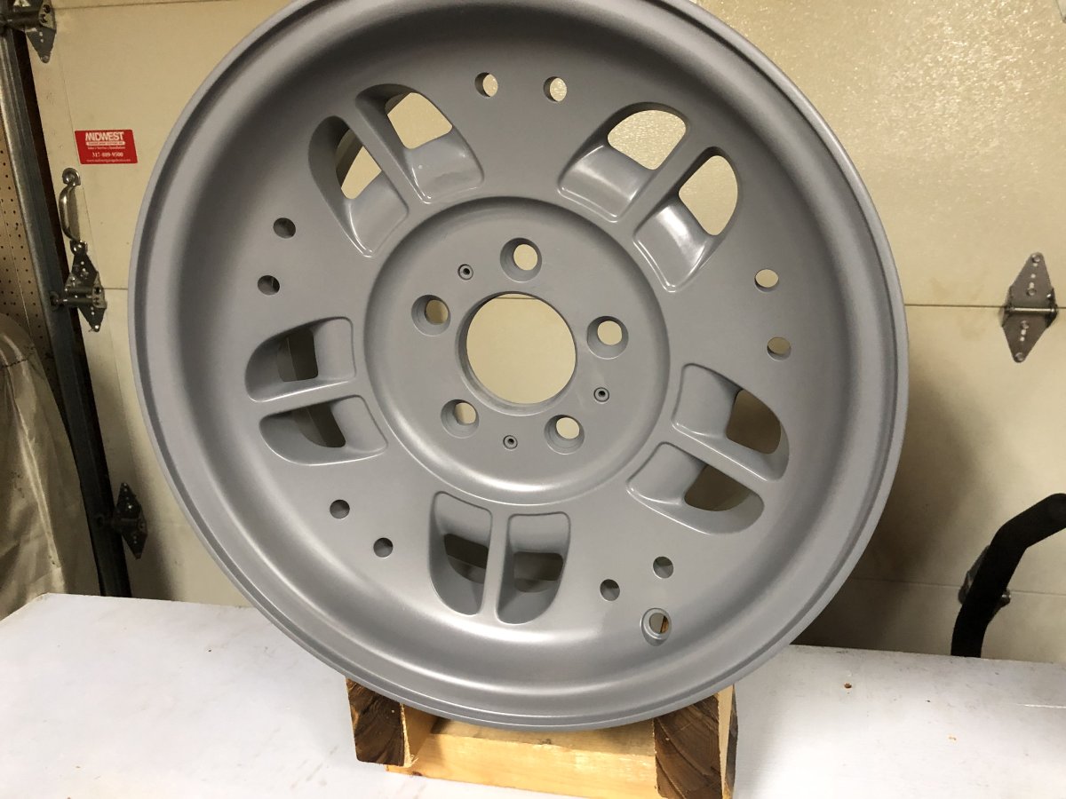

I got the wet sanding done and all the prep. Chinese rigged some little stands for the wheels for spraying and curing. got the epoxy primer sprayed today.
I have them inside now with the shop heater set to 85. i'll leave it like that til I'm ready to spray tomorrow evening.

I'm relatively happy with the result. I got a couple of runs in the tight spots. I had to use my normal size gun for the 1.7 tip, plus my pressure regulator broke so I was wingin' it a little. The runs are real minor and i can hit it with some 240/320 before the next coat. These are beater wheels, so i'm not going to fret too much over them. As long as what I spray on there stays on there i'm good.
Fortunately, I'll be able to use my touch-up gun for the color because I have proper size tips for it. After 3 hours, the epoxy primer is already hard and dry, so I should be good for next coat by noon tomorrow. i'll keep the shop @ 85 degrees overnight to be sure. My IR thermometer shows the wheels staying around 82 so I'm in good shape.
The only thing that bugs me are a few spots that were corroded real bad. I should do a few coats of sealer/primer and sand to fill them in, but I just don't care enough to get that detailed with this job. No one will ever notice it but me. These old wheels were beat to hell so this will be a big improvement regardless.

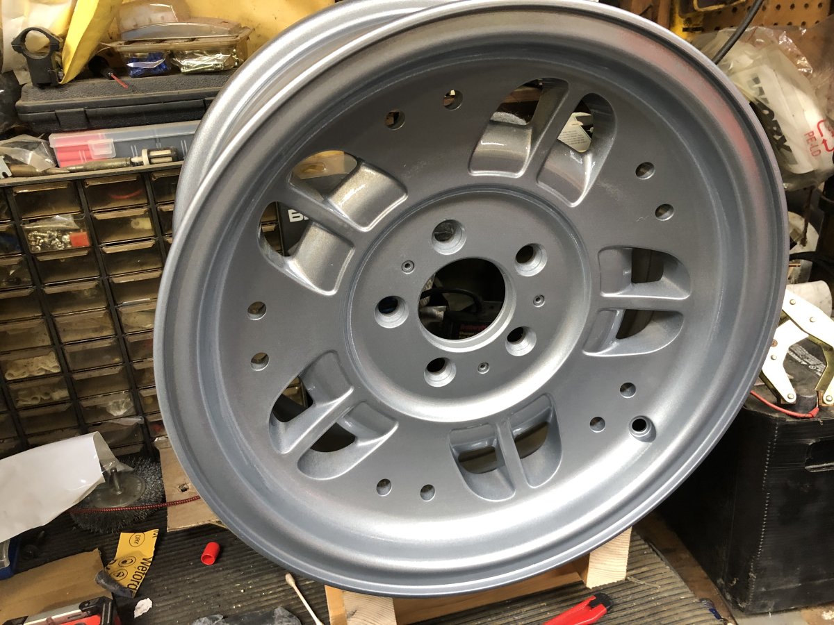

Well, got them wrapped up tonight. They are nothing impressive, but they look decent. I am not happy with the color. It is heavy with the flake, but the base color is WAY darker than the sample I picked out.
It's hard to get good pictures of them inside, but the clear coat turned out pretty dang good. Very minor orange peel, but better than some Ford factory paint I've seen. I don't think i'm even going to bother buffing them down. I'll see what the shine looks like after they gas for a few days.
Overall, goodnuff
Now i'm wondering.... how long do you think they should cure before I get rubber mounted on them? I don't want the tire bead to bond with the paint and rip it off next time. Any ideas?
