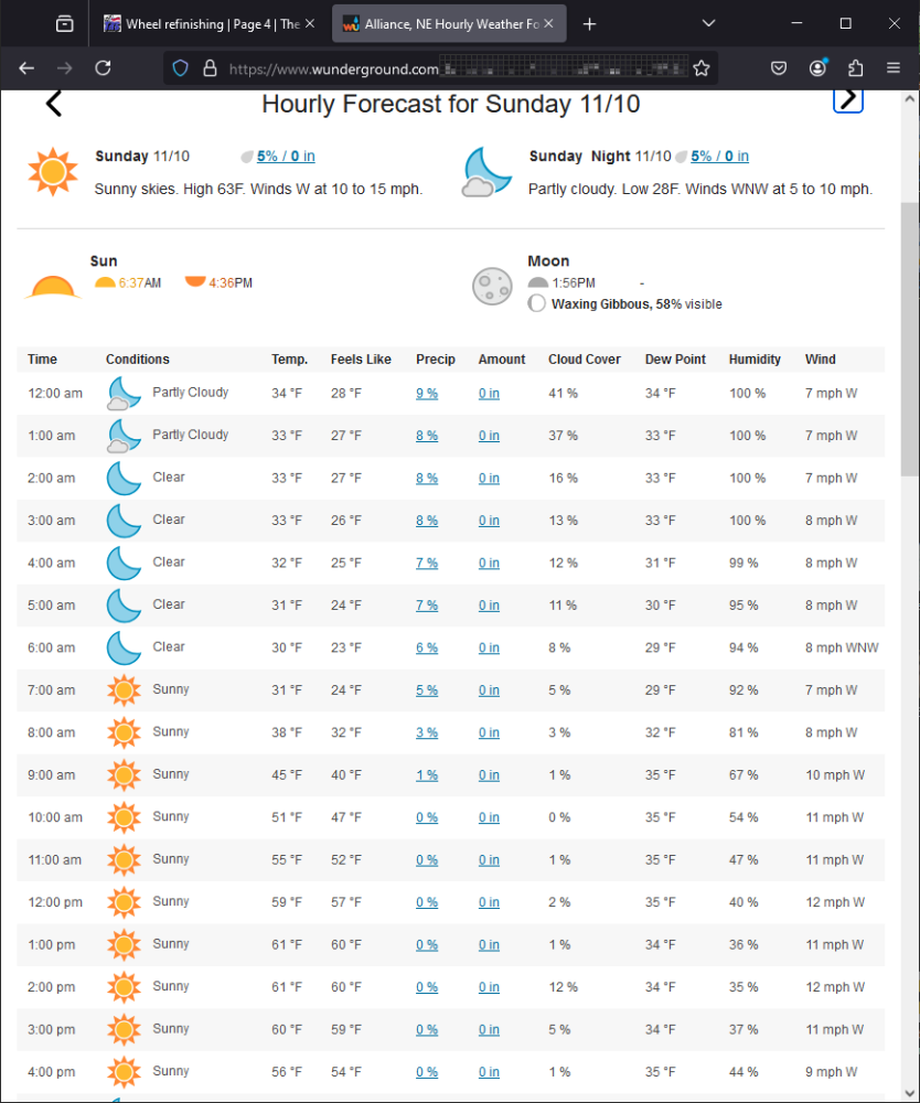

Well if you are still waiting on me, I think I am skunked till spring.... Paint says minimum temperature is 60 and max humidity is 60%.... It's been 100% humidity since it started snow/rain/sleeting 3 days ago and the forecast for sunday (when humidity finally drops) is a dead high of 60.
I'm still going to try to squeeze the paint work in... but it's going to be really hit and miss... one hour window to do black, wait 5 days till the next window for clear, wait 5 more days etc.

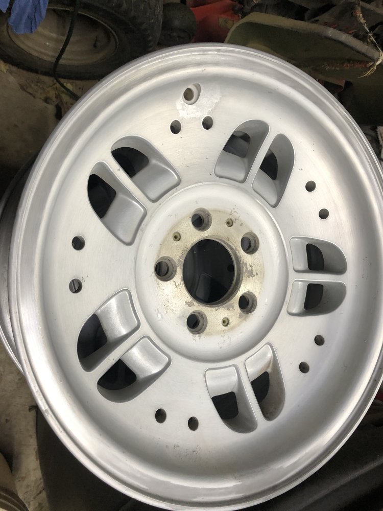

SO.... I'm really close to having the wheel surface prepped. I'm hoping to start spraying primer tomorrow. temps are in the low 60's for the next 5 days with some rain in between. The issue is that with the temps, I'm going to have to do all of this, then when I'm done and it has cured enough to handle safely, they are going to have to be smuggled into the basement to outgas for a few weeks. I may even setup a space heater in the utility area and block off the furnace vents in there to help a little. I'm hoping i can pull it off without any notable odor so I don't get busted. I'll be sleeping in the shop if I stink up the house. I'll start taking pictures as soon as I get the surface prep done. As of now, this is where i'm at, and the photos don't really do it justice. I've gotten all of the scabby areas blended very well. I just have to do the center sections (couldn't do it on my Russian axle lathe due to lugs in the way). I also need to scuff up the "deer print" areas a but more with some 320.
I really really wanted to try that process as you explained it, and I might till one day. but for now, I just have to get these looking decent and sealed up good to protect them so I can get some decent tires. It kills me because I don't like making concessions for utility reasons... but here I am.
