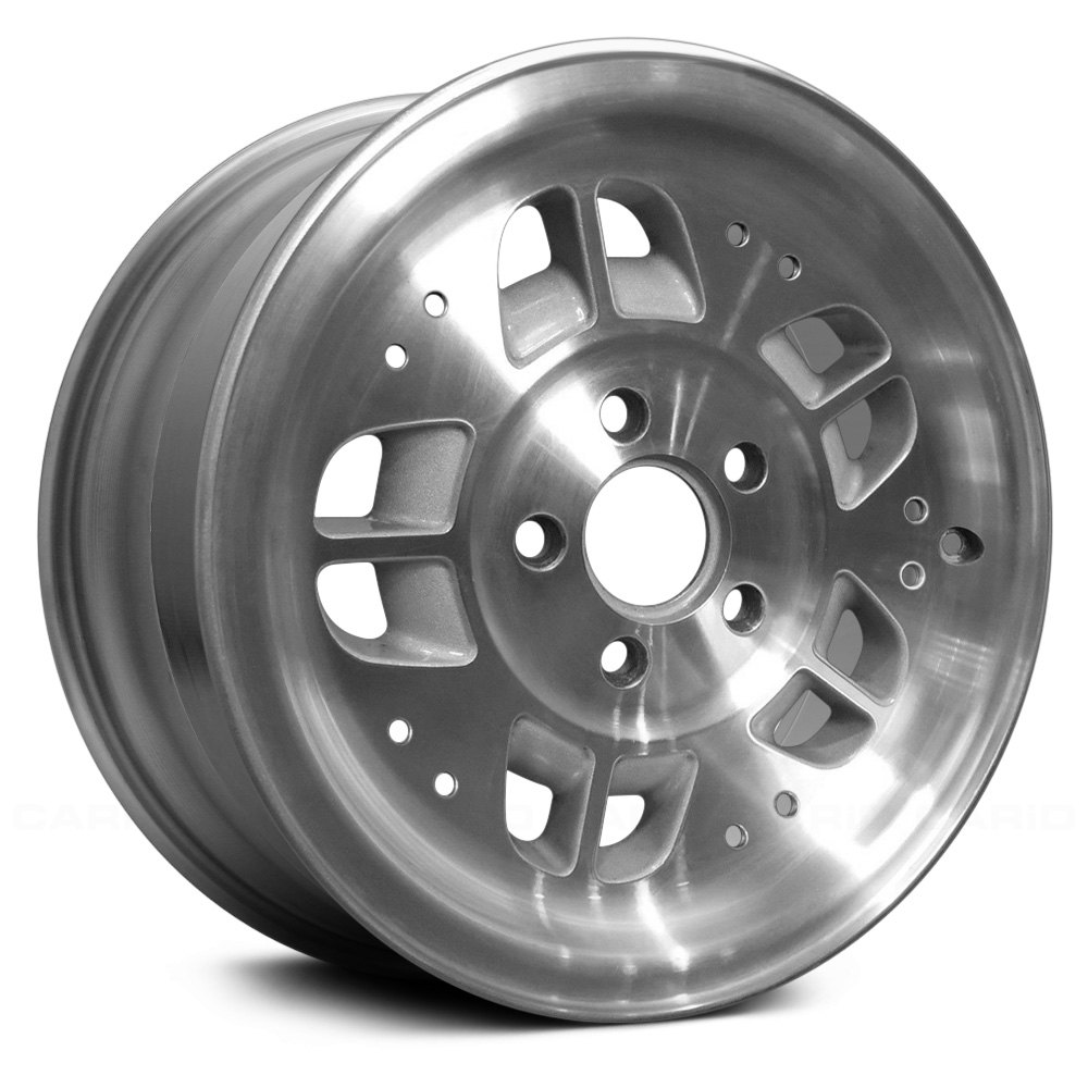

I'm on another quest with the money pit. I need new tires, and options are slim for 14" stuff now. So I found a set of the alloys that people call "deer print" (I have the same thing on the Ranger now, but they are 14's). they are at a boneyard on a '94 Ranger but are 15x7, just what I need. Problem is the finish is just terrible. So I wanted to ask if anyone here knows how the professional shops refinish these things. Are they painted then sprayed with clear? If so, does anyone have any info they can point me to on the process? I don't know if these things are aluminum or some weird cheap alloy. I can spray pretty decent, but I want to put something on here that will last the test of time and road salt. I'd like for them to just look the same as OEM when i'm done. looking for some general thoughts from you guys. I have the equipment, a good spray gun and proper compressor/dryer setup.
things that are most important to me is durability. I wouldn't want to use a standard clear that is normally sprayed on cars, the stuff is simply too dang soft, but I don't know what options are out there really.
Any thoughts on the proper way to do this and what materials are ideal?
This is another one of those things Iv'e never done before, but am interested in trying to DIY it, so as always, I appreciate any input or advice you all might have on this before I dive in head-first.
