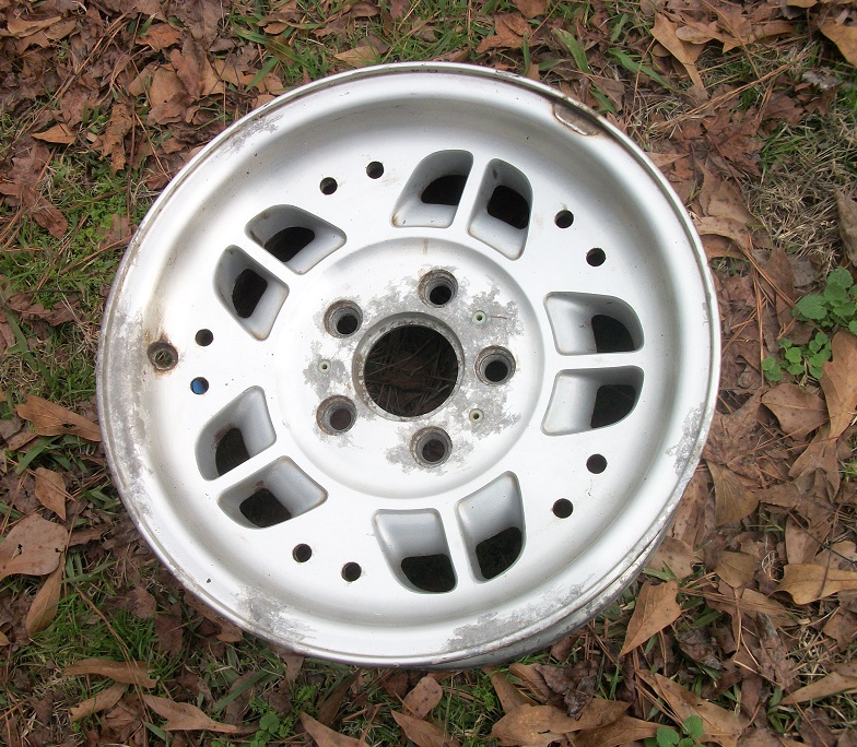

I'm on another quest with the money pit. I need new tires, and options are slim for 14" stuff now. So I found a set of the alloys that people call "deer print" (I have the same thing on the Ranger now, but they are 14's). they are at a boneyard on a '94 Ranger but are 15x7, just what I need. Problem is the finish is just terrible. So I wanted to ask if anyone here knows how the professional shops refinish these things. Are they painted then sprayed with clear? If so, does anyone have any info they can point me to on the process? I don't know if these things are aluminum or some weird cheap alloy. I can spray pretty decent, but I want to put something on here that will last the test of time and road salt. I'd like for them to just look the same as OEM when i'm done. looking for some general thoughts from you guys. I have the equipment, a good spray gun and proper compressor/dryer setup.
things that are most important to me is durability. I wouldn't want to use a standard clear that is normally sprayed on cars, the stuff is simply too dang soft, but I don't know what options are out there really.
Any thoughts on the proper way to do this and what materials are ideal?
This is another one of those things Iv'e never done before, but am interested in trying to DIY it, so as always, I appreciate any input or advice you all might have on this before I dive in head-first.

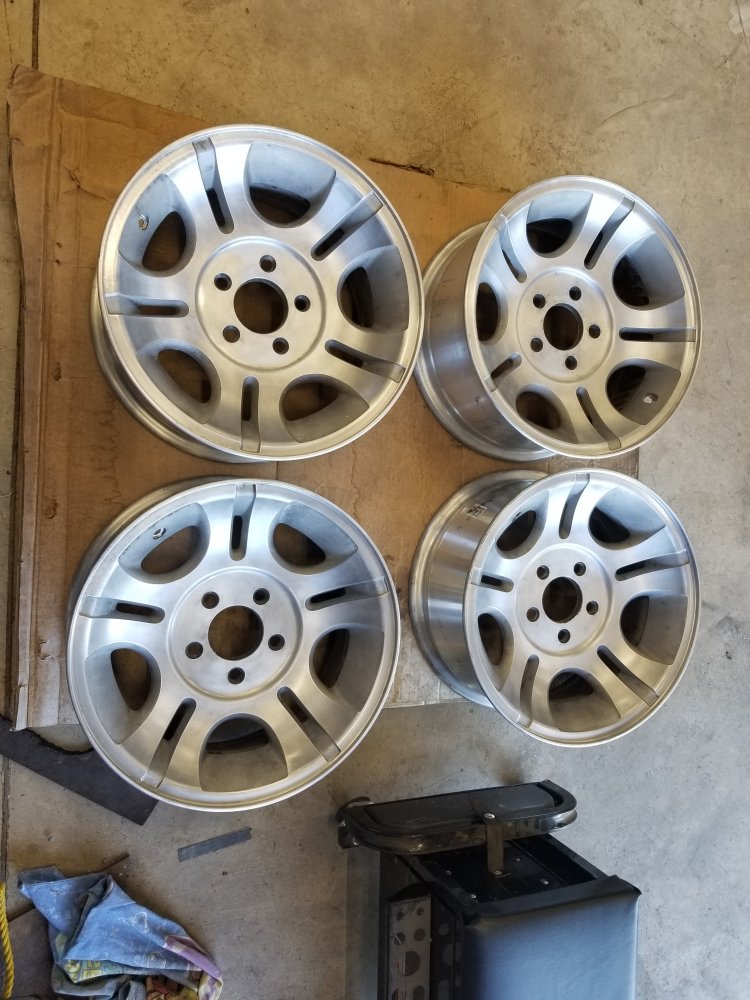

I have cleaned up two sets of these same wheels. First set (15") was OK but not great; I only sanded that set.
The second set (14") turned out much better because I used Aircraft Paint Stripper to get the original clearcoat off.
The biggest problem that I found with the deer prints is corrosion spots that eat into the metal (I think that they're aluminum). The small outer rims are smooth polished but the entire dish area has fine lines in the finish, like the wheels were spun. Corrosion that's eaten into these fine lines is really hard to remove and look right afterward. I used a hell of a lot of patience, 60 grit sandpaper and various drill and hand wire brushes to get some semblance of the original lined finish back.
There may be other options with sand blasting; I've never tried that approach (yet).
I used spray-bomb wheel clearcoat on mine; brand escapes me but it was a costlier clear made for wheels.
Before and after pics of my better second set:
Wheel refinishing
Wheel refinishing
Not perfect, but passable for a beater. You can still see where some of the corrosion was, like around the hubcap mounting holes.
Best advice I can offer, is when you're wheel hunting try to get the ones with the least amount of the deep corrosion that spreads under the original clear. You can see what I'm talking about in my before picture.

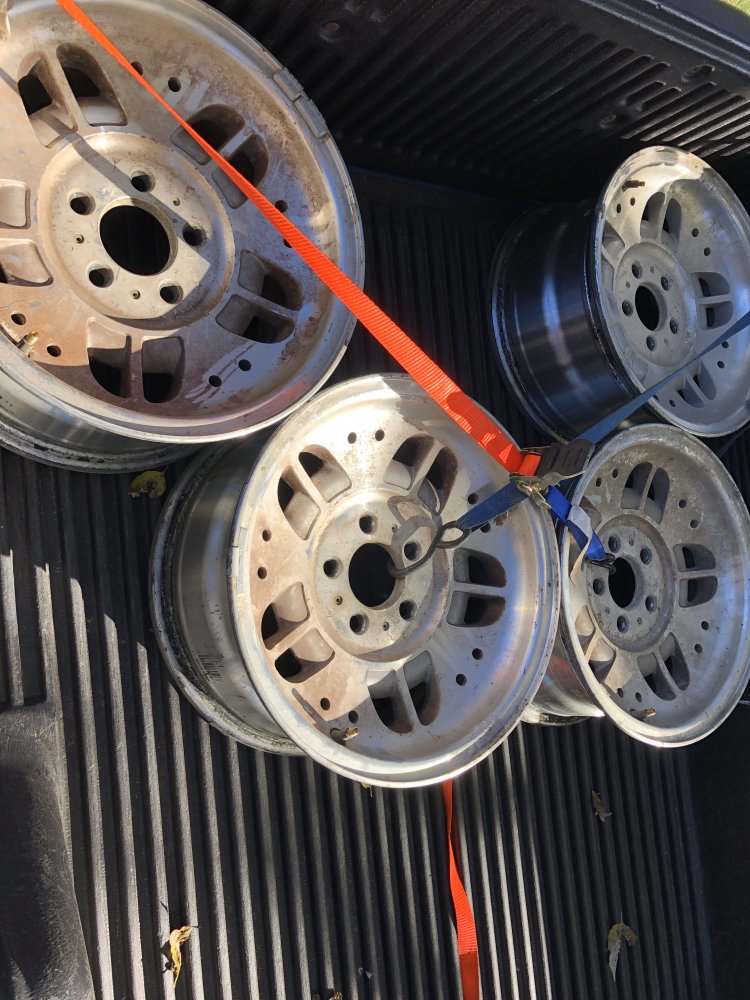

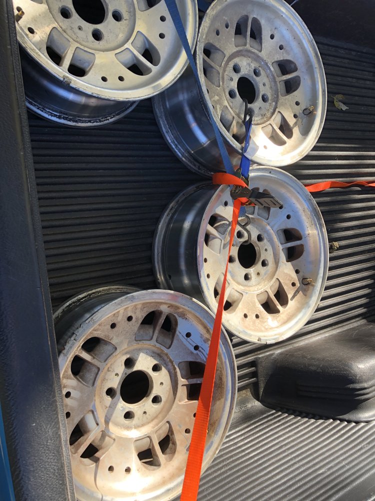

Well, road trip today and picked up the wheels. I'm hoping I didn't make a mistake, these came off of a 4x4 and I didn't realize that. I'll try to test fit one this weekend beffore I start stripping them. At the very least, i'm going to need 2 center caps without the hub cut-out. they are dirty as sin. Overall, I can't complain for 30 bucks ea

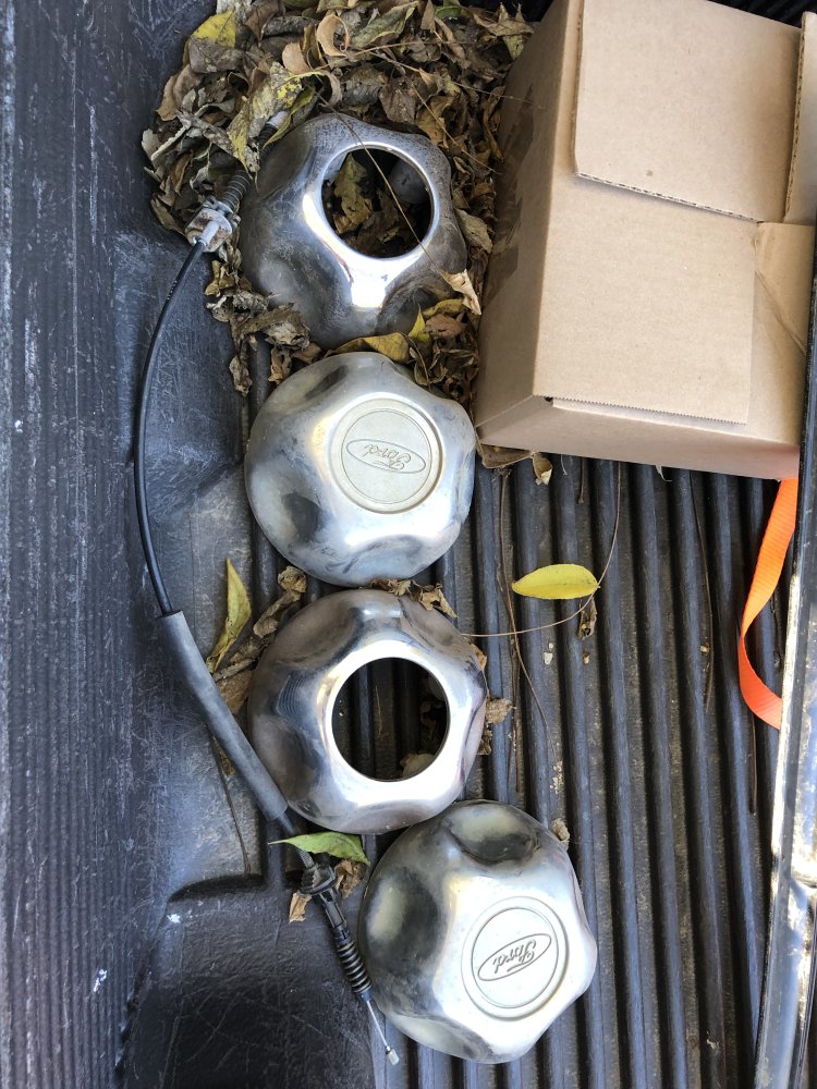

Would the newer style center caps interest you?
Wheel refinishing
I have these here and am never gonna use them. I'd hate to just toss em. Four are the three clip style and the fifth is the 5 clip style. All the same from the front side.

I'm not sure just yet. I noted that these 15's have the 3 holes with plastic inserts to accept screws so I'm wondering if my current center caps from the 14's will screw right on there. If they do, I'm going to go that route to keep it looking as original as I can. I'll be trying it this weekend when I get some time to see if they fit or not. I'm assuming thats what they are for though... even has 3 holes like the center caps.
I do appreciate the offer!
Sounds like you already have what you need. The lug pattern on the wheels is the same so I bet Ford just copied the blueprint for those 3 screws.
No the center caps you have will not screw on. The center caps you have are meant to clip on to the lug nuts, yes they are a different style lug nut. I have a set of the deer print 14" that came stock on my truck that are the same style you have. I have yet to put the one of the other center caps on there to see if they cover the 3 screw holes but I think they will.
The big question is if the mounting surface of the proper lug nuts to hold those center caps is the same as the rims you have. There are different angles to lug nuts and if you don't have the correct nuts then you can have wheels come loose.
