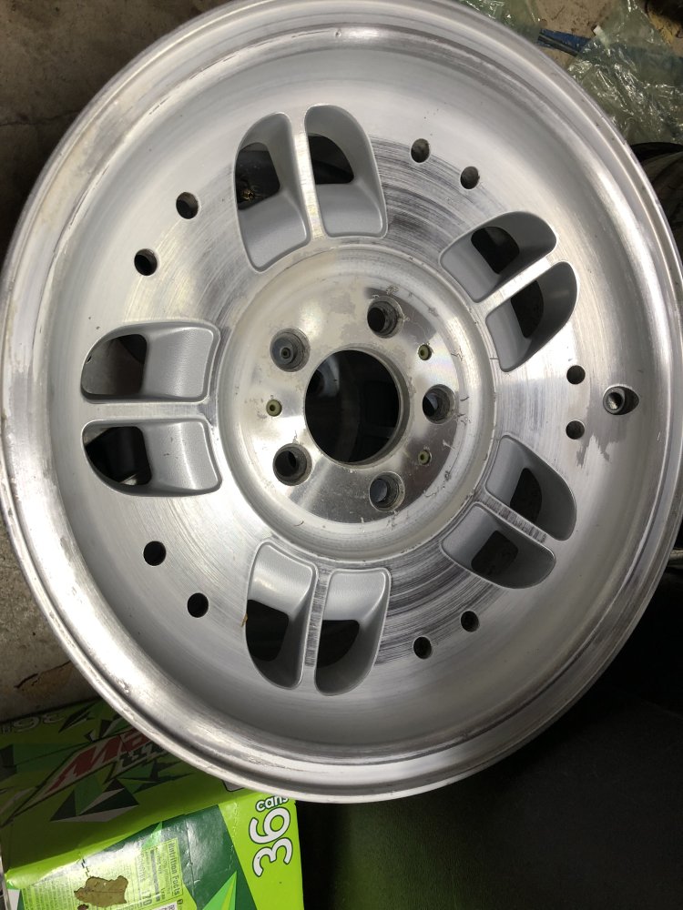

Well I did a quick test run on the hillbilly polishing method and it works pretty well.
So now I have to collect materials and prepare to spend a day doing this. I completely sandblasted the back, but the front I'm just going to take it down as far as necessary to remove the spots with the corrosion. then I'll use the MC00 chrome, then clear. I just need to get some various grits of proper paper, probably going to go to 320 or so before I spray. This one is nowhere near done, I was just testing out the method with some 100 grit
