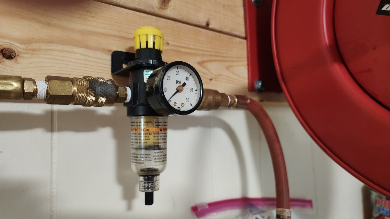

I thought about doing a sediment/ ball valve set up. the compressor does have a valve at the bottom, and the pipes are all much higher than the compressor. still think I need a ball valve and trap? I would likely put one at the workbench and another at the hose reel if needed.
I drained about a gallon of water out of the compressor itself last fall. never drained it before in 13 years. will be more diligent in doing so going forward..

Usually the compressor has one. Then the main line is started at the highest point from there, and slopes down until you get to the end, then have another drain. Best practice, you should have a valve at the bottom of every drop from the main line.
Yes, it's recommended. You'll still get some condensate out there. Heck. I have drains on my drops and I empty them. And I still occasionally see water vapor out the exhaust of my die grinder. Of course, I live in South Carolina, the humidity Capitol of North America.
Make sure you put drains on all the drops and low spots. You don't want water to collect there.

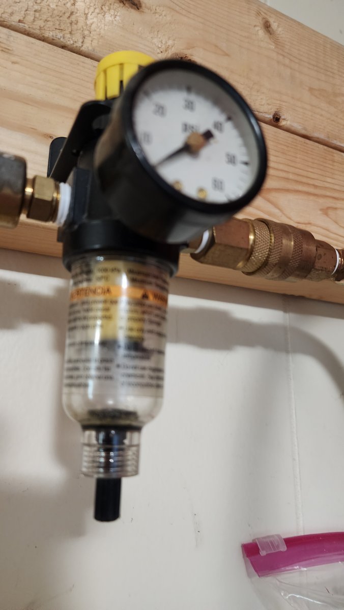

at work (when I worked at a factory) i saw actual sediment bowl attached to a valve similar to the one i have hooked up to the reel that you can undo a drain nut at the bottom of the bowl to blast out the crud. the fancier ones had an automatic setup as soon as the bowl filled, they would automatically open, but those were on the main plant air lines which I have no need for a 1 or 2 inch air line lol. there is that feature in the pressure valve I have attached to the reel. That valve is already at the lowest point of the line (when I put it in) for the hose side. the best part is you can see the water/ condensate fill up. in the last 13 years, that bowl never got water in it where the tank itself did. But the last house did not have near as much pipe as I am putting in this one and i manually hooked up a soft line to the workbenches if I wanted air to them.
If this a good setup, I may just get another one of these valves and hook it up just before and below the workbench pipe on the other side of the garage.
so to the masses (lobbing another grenade back @Rick W if nothing else to put a small dent in his helmet, would this be an acceptable clear out point? attaching close up pics of the valve system in question
AJ
Water/Oil separation is exactly what those are made for. We try to keep one on every air-powered fixture at work.
AJView attachment 124658View attachment 124659
