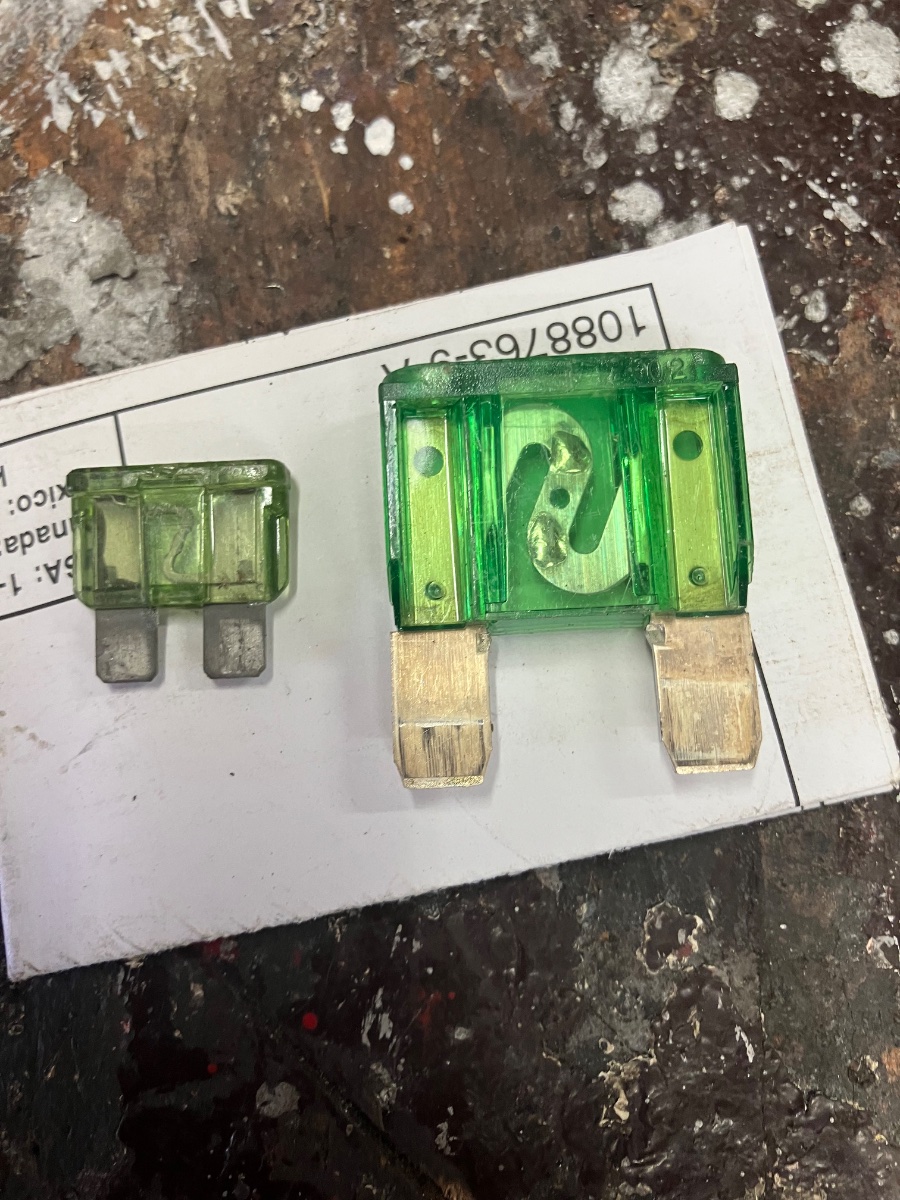

30amp fuses. I don’t have a picture of the even smaller more modern fuses like this that I believe also come in 30 amp.
If I’m going to run a wire from here to there in the truck to power whatever, are these two fuses interchangeable because they’re both 30 A? Or does the big one somehow carry more whatever? My thinking is a 30 amp is a 30 amp is a 30 amp, independent of the physical size, when working in the same 12 V circuit.
I’m looking for the correct overall answer. Specifically, at the moment, I’m wiring in some electrical horns and also the little compressor for some air horns.
What am I missing? (I was going to ask if I was crazy, but I knew the flood that would come with that).

Yes, they will both carry 30 amps. If you were going to run it on a circuit that was constantly pulling higher amps, I would say go with the maxi fuse instead on the ATC/ATO style on the left. But if it’s just an air horns, you’ll be fine based off duty cycle.
International had an issue on the 40 amp ATC style injector driver module fuse in the DT466s. They would draw right at about 37-39 amps and overtime it would melt the fuse and holder. Turns out, the standard contacts on the fuse holder and ATC fuse couldn’t really handle the constant 35+ amps, even though it was a 40 amp fuse. The tabs would start to warm up and pull away from the fuse, making everything even hotter. Then you’d get a no start road call for a melted fuse and holder. They solved it by switching out the harness to a different alloy on the connector at the fuse. We solved it by replacing the ATC fuses with maxi fuses.

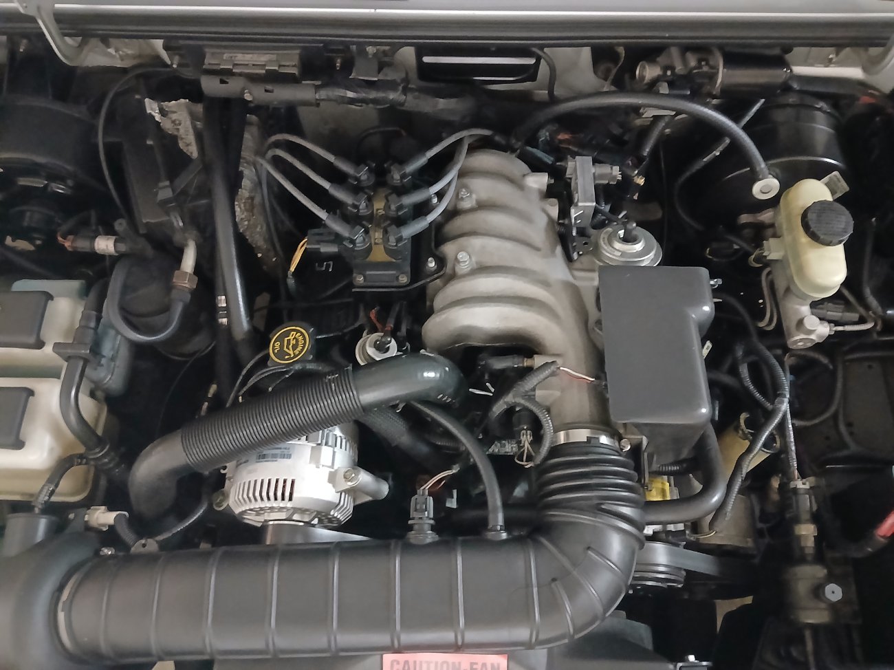

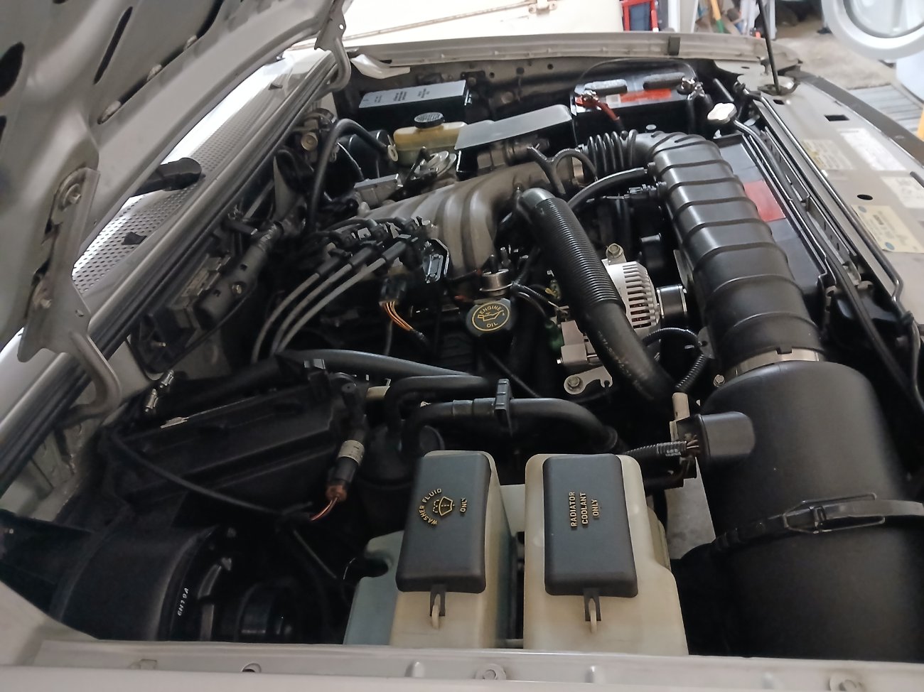

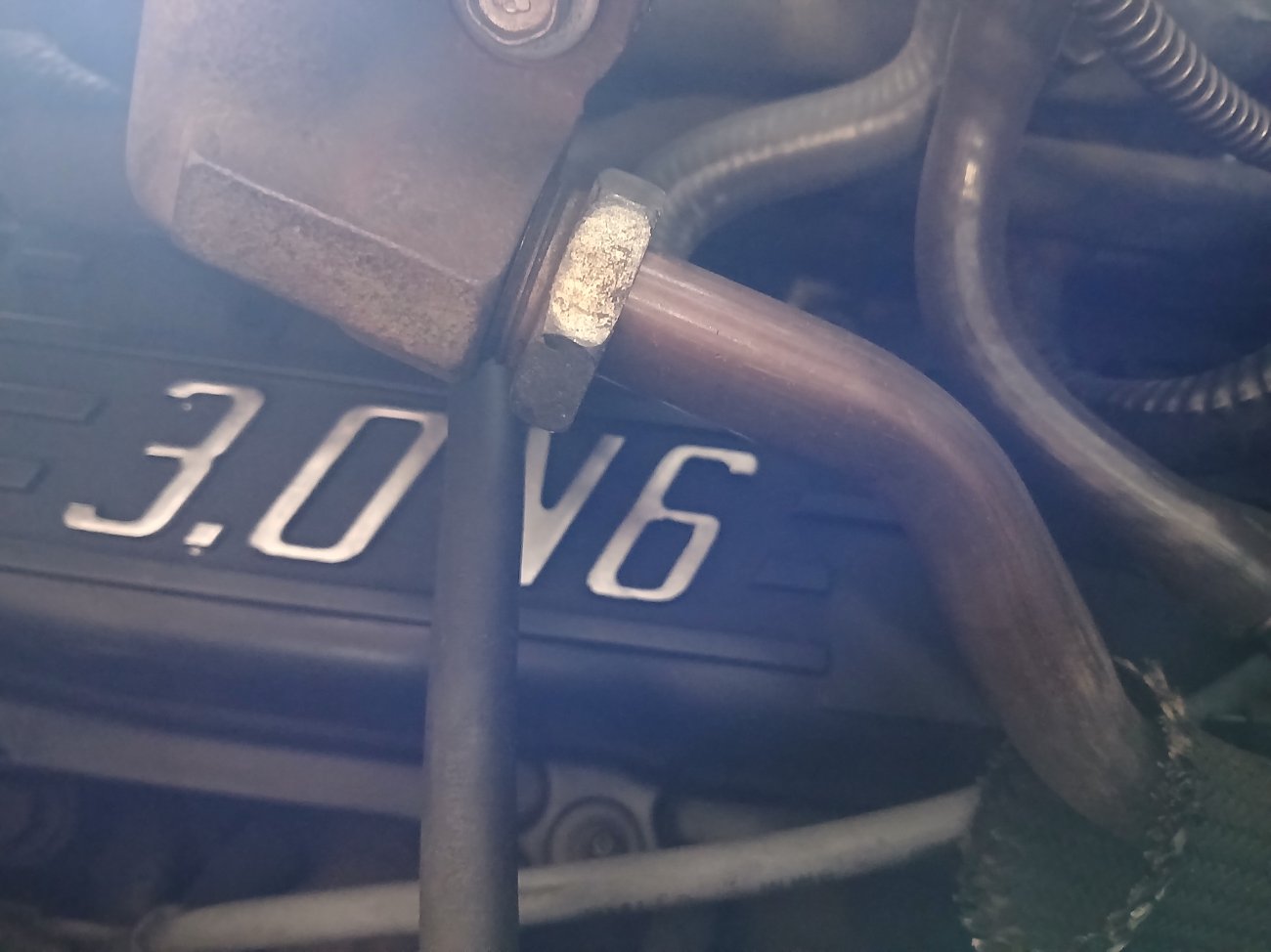

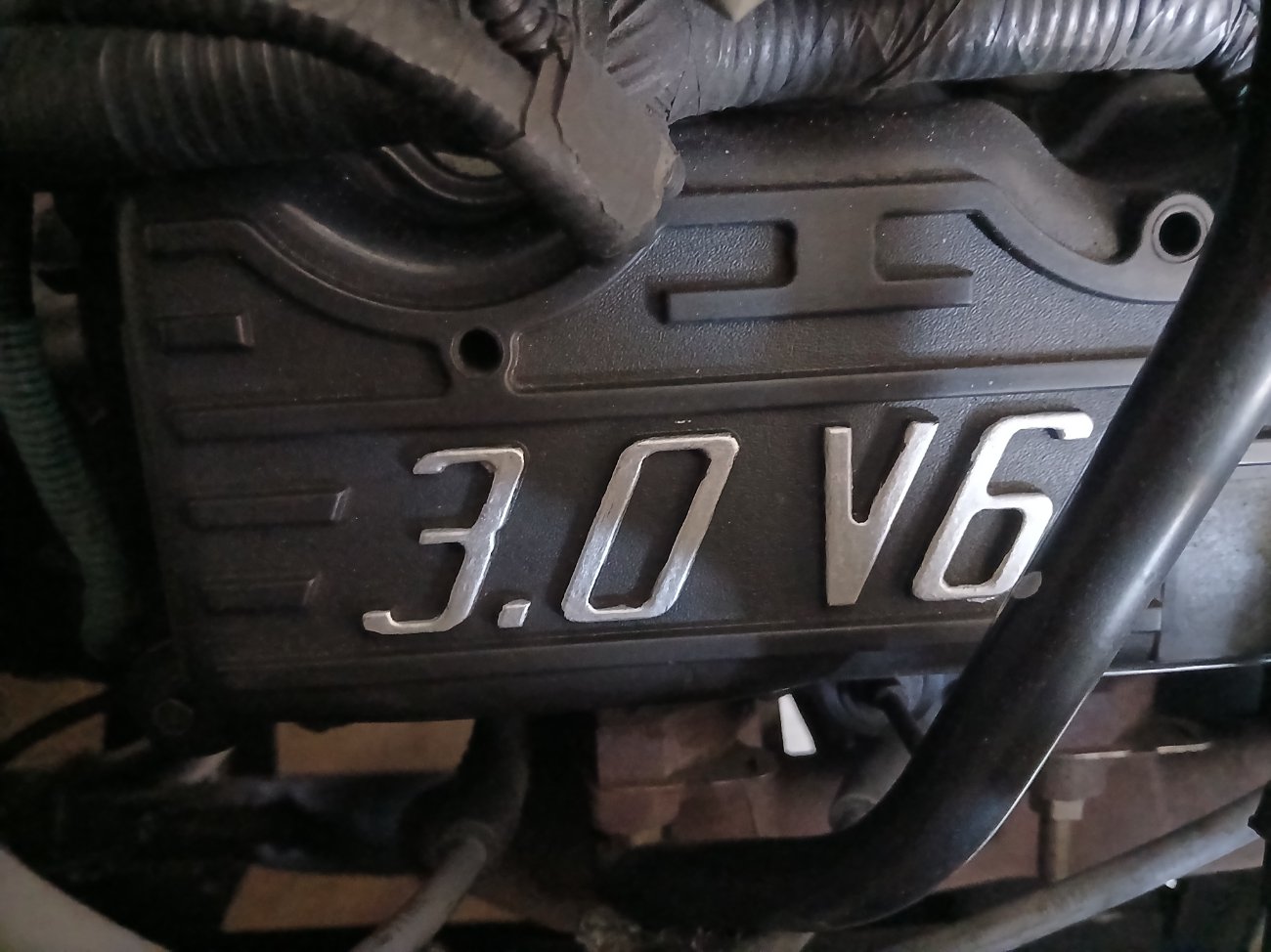

As for what I've done to my Ranger today, it's dumb... my '97's been loosing coolant for a while and I was under the hood looking at something for someone here so I investigated... saw the thermostat gasket wet so thought I found it then found the heater return hose resting on one runner of the exhaust manifold! It was just starting to seep until I touched it... I tried rednecking it with a piece of 3/4" hose slit and held on with 3 hose clamps but that made it worse... then I wandered the garage for anything that might be 5/8" OD tube wise, ended up spotting an empty CO2 cartridge for a pellet gun, checked and it was about 11/16" OD so close enough! Cut both ends off and deburred in and out and grabbed some hose pinchers and cutter and it's now fixed!
Update: it turns out the cam synchronizer did the trick. The Road Ranger is roadworthy again!
When I finally got the sync in the other day, I was out of time that afternoon, so all I could do was rev it. It had the same warble that it had before I ever touched it. @Peter_'86_2.9L_Auto was over here today to help out, and we did a couple things to his truck. He must’ve brought me luck! After he left, I did a test drive in the Road Ranger, and it purred like a kitten under acceleration and under load. I’m sorry for the thoughts of gooey lizards and slimy frogs on all you guys because you put your lives, your wives, your families, your jobs, etc. in front of fixing my truck that you’ve never seen from a thousand miles away. You are all out of the doghouse.

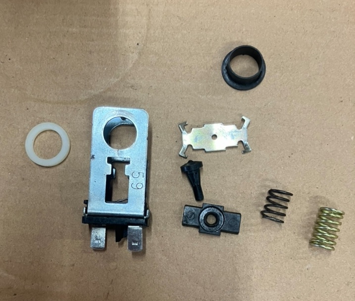

On the other front, I took the new brake light switch on and off and apart and back together another 20 times on the Missing Linc.
Two brand new switches, and a new bushing kit, and it was still doing the same thing it was doing before: you could push it lightly, and the brake lights would come on, push it further, and then pull back on it, no lights, and then step on it again and brake HARD, no lights. No lights when you were braking hard. Not good.
Stupid design. The really stiff spring actually holds the switch open as you step on brakes. Eventually, if you step hard enough, it compresses the spring and makes contact. To fix it, I finally replaced the spring (which was NOT designed to be replaced) with a thinner/softer wire spring with a much lower spring rate. I had to do a trial and error about seven or eight times, taking a little bit off the spring each time, but I finally nailed it. I can now take that switch in and out with my eyes closed.
In retrospect, I’m thinking the linkage between the foot pedal and the vacuum booster/master cylinder may need adjustment to remove any slack in the motion in the connection. In any case, the lighter spring ended up doing the trick.

Update to the update on the brake light switch and actually a confession and some progress. And I finally put my air horns in in addition to doing a whole bunch of wiring cleanup behind the grill on the Missing Linc.
It turns out the original design of the brake light switch assembly may not have been the problem. The problem is the replacement parts. I know, for sure now, that the reason my brake light started being intermittent, was simply because the contacts had become corroded and carboned up from decades and hundreds of thousands of miles of use. When I put in the new switchs, which are fine, I also put in the new little black top-hat bushing - that bushing is the problem.
I called out to the two local Ford dealers I use, everyone born way after that truck was made, searching for the old fart like me who might know about it. Both of the guys I used to deal with were retired. I asked the manager at the one if he could have that guy call me since he wouldn’t give me his number. And he did call me, great guy, I miss him.
The cylindrical stud that comes off the side of the brake pedal is supposed to be able to wiggle about a 16th of an inch inside that black bushing. The only purpose of that bushing is to avoid a “click” noise when you step on the brakes, from metal to metal contact. It is supposed to float on that stud, and be tight outside in the eye of the push rod that goes to the vacuum booster/master cylinder. I ended up buying three of those bushings, and every single one of them was snug to the stud and was also snug inside the eye - no motion - so the push rod would not move to depress the spring and close the contact.
Someone said it, I apologize. I couldn’t find it right now, but simply removing the bushing solves the problem, and I can’t hear any click with all the other rattles in that 40 year-old truck. Very frustrating, but it’s all working properly now.

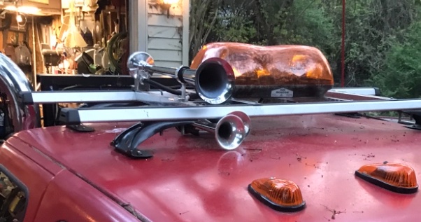

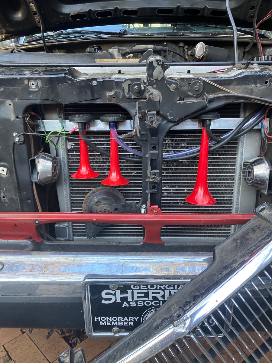

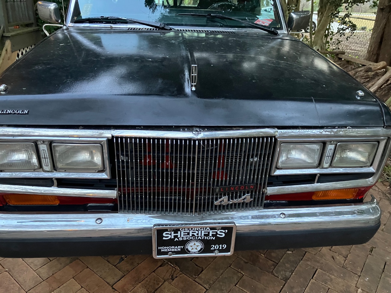

Now for something REALY important, the air horns and Lincoln Star hood ornament. When I got the truck, the guys before me had it stripped down and they were charging through the woods with it. Can you imagine anybody doing that? It had been banged up a little bit with a bronco hood, fender and door. The wiring behind the grill was a little suspect to say the least.
When I put the engine in and had the brainstorm to put in the Lincoln grille and quad lights, I always like to improve things, so I put in a whole lot more suspect wiring behind that grill. When I put the hood star on top of the grill originally, it didn’t clear the hood. So you would have to tilt it forward a little bit to close the hood. I’d forget that about every 10th time, and it finally snapped off the spring below it. That meant I had to take the grill off to fix it.
I basically redid 90% of the wiring behind the grill. I installed the airhorns facing down in front of the radiator, and I tossed the activated carbon vapor canister (which probably hadn’t been hooked up in decades), and I put the air compressor in it’s place.
If you look at the first picture closely, you can notice two chrome marine horns on either side of that opening, and an old fashioned deep toned Cadillac trumpet from the 60s or 70s below my red horns (both from SOM). The truck still has the two horns behind the headlights that came with it. I’ve done this before. They’re wired through a relay that also runs the compressor, but I left the original horns on the original circuit, which I tapped into to trip the relay. That way, if the fuse blows on all the extra ones, the two original horns will still honk.
EDIT: I also wired the quad headlights the way they’re supposed to be. When I originally wired them, I accidentally reversed a ground and a hot lead, so on low beams, the interior lights would glow a little bit, and on high beams, the interior lights would be bright and the exterior lights would glow. It’s a pretty cool effect, but I think it was burning up my multifunction switch, so since I was in there anyway…
My Lincoln grill and hood star were not the prettiest in the world, I’ve always been dissatisfied with the way the top of the grill sat under the hood, and the fact that the hood star was in front of the hood instead of being on top of it. It looked like some old fart did it laying on his back when he was sick. Oh, wait, I was. So while I was doing all this, to eliminate the problem of clipping it with the hood, I moved it up on top of that central rib. I had to fabricate a new spring system, so it would spring back instead of break off. It’s some of the best wire coat hanger work I’ve done in quite a while.
If you look close, shows better in daylight, you can see the red horns behind the grill. I ran out of time, but my next step is going to find an appropriate piece of stainless trim that I can cut and fabricate along the top of that Lincoln grill so it looks more finished.
How do the air and factory horns sound together?
I pulled a 2 trumpet air horn and a compressor out of an '87 Ranger in the junkyard, similar in size to your two red ones on the left in your photographs. The compressor was wired in as a replacement for the factory horns on that one. My factory horns still work though so I didn't want to go that route. While debating on how I wanted to switch them permanently I've just been tripping my relay by shoving a wire that I ran into the cab down inside the cigarette lighter to touch the middle contact, but that isn't too convenient.
Come to think of it, my cousin gave me another air horn that's longer than any of the spaces I could mount it in under the hood. I hadn't thought about trying to mount it behind the grille like that.

You might try removing the little plastic bushing that goes on the shaft that the switch rides on on the pedal, the little plastic cylinder that takes up the gap between that rod and the switch. When I first got my Ranger it didn't have brake lights at all unless I really stepped on them, like yours is doing when you ease off and then press harder, but removing that little plastic cylinder made them work like they should starting from barely touching the pedal. I don't know why and it probably isn't a permanent fix, but at least they work.

Altogether, it’s loud, but it sounds a little like an off-key Symphony. I’ve had those airhorns for a long time, and I wanted to put louder horns on that little truck, and I’m cheap, so I used them. The truck is red and black, and the original plan was to put them up by the lights on the rack, but I’d have to move stuff around to do that and I didn’t feel like doing that.
Wiring them all together was just to get them in and get them working. I’ll keep the electronic horns on the steering wheel, but I’m going to put the air horns on a pull chain hanging from my overhead CB/switch panel like I did on the Road Ranger (97), I put in one of the deep tone, 17-inch trumpets and two chrome trumpets about the same size as the two larger ones in this red set. I had to mount the two air compressors in parallel and put in a larger hose for them to work right They sound awesome.
If you look close, the little one is to the right of the one on the bottom. That was my original thought, but again they won’t fit this one unless I move stuff around, and that isn’t worth it to me.
When I get the switch installed overhead, I’ll be able to hear how the airhorn sound independent of the steering wheel horns. Then I’ll make a final decision on another chrome trumpet up top.

I was thinking that they would probably be loud but sound a bit off.
That chrome horn on eBay looks identical to the long one my cousin gave me, except mine is black. I've only ever honked it with a bicycle tire pump in the bedroom of my apartment...

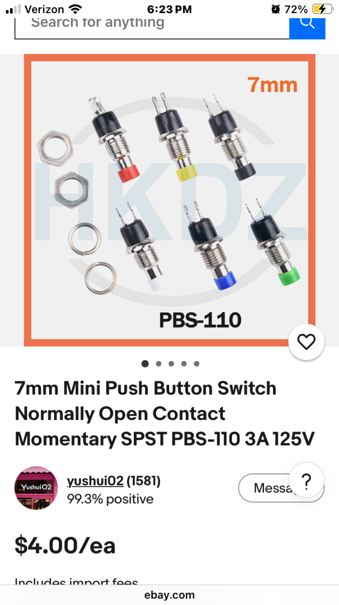

I had thought about rigging up a pull cord but I never got past finding a momentary pull switch online. If you don't have a switch in mind for it, someone said that the air horns on his fire truck were actuated with a Cole Hersee 9109. Those switches are $15 or $20 though.
And thanks for the last picture. I've been debating on whether to mount my CB to the roof, in place of the ash tray (mine is small enough to fit in there), or under the dash, but I'm trying to get an idea of what it would look like before I commit to anything. I've also been thinking about putting a switch panel somewhere, and that positioning would take care of both. Then I would just have to decide where to mount my off road lights. My body is too nice for me to be comfortable drilling holes in it willy-nilly and I haven't come up with any bolt on bracket ideas that I like.
Changed the oil on the '97, good to go for another 5k...

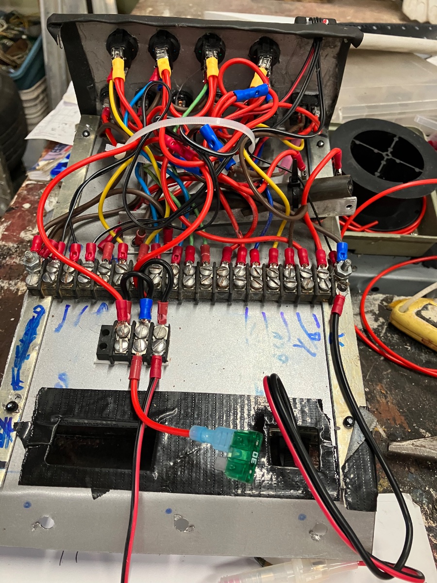

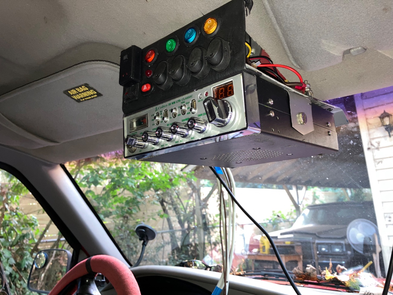

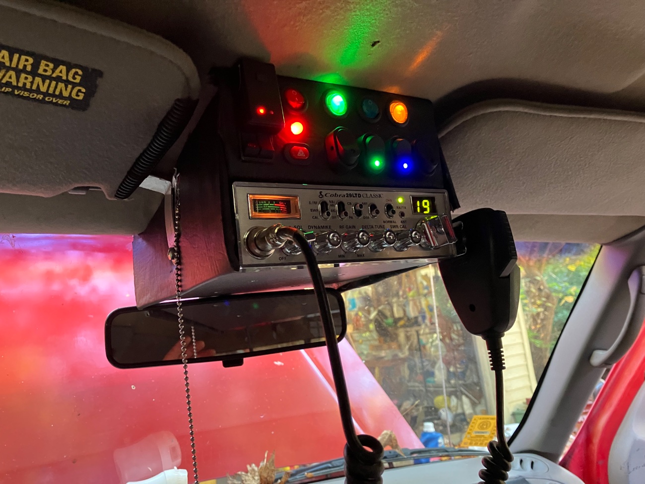

For the pull down cord, I just used a very cheap micro switch. Normally open momentary contact. eBay
When I made the housing to hold my switches, which is pretty much just a folded over piece of sheet metal, I took a 4-5 inch long little piece of aluminum angle, maybe 3/8 of an inch by 3/8 of an inch by 1/8 thick, but you can use anything. I mounted the switch pointing up, put the angle on top of it with a pivot in the center of the bracket, and left it sticking out about an inch on the driver side, and put a chain on that. The little switch is strong enough to hold it open, you pull that chain to honk, you let it go and it pops back up. I just used beaded chain.
This might help too:
The trucks have a double roof. There’s the roof you see on the outside, and then there’s a second skin about a half inch or an inch inside of that which is actually what you touch from the inside above the headliner. I just used some super short, self drilling, self tapping screws to put a little angle on the front side and a little angle on the backside to hang my switch panel. Note a trick: I always use a little goop/E 6000 when I put in the screws. The screws hold tight, the glue keeps them from vibrating loose.
I did it so I can slide it in in the front, and then push it up in the back, and put a couple screws in it in front to hold it in place.

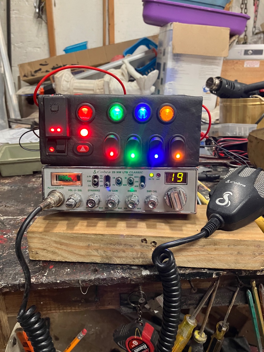

I ran a pretty stout wire from the battery, and one from the ignition, both fused 30A. Then I used a terminal strip, and tapped off that for the different lights and horns and whatever. If you look on eBay, the smaller illuminated switches on top are rated at 20A, and the bigger switches on the bottom are rated at 30A. They’re dirt cheap. On some of the heavier things. I also have an individual fuse.
When I made my panel and put in the switches, I put in four or five more than I needed for what I was doing at the moment. I ran the same number of extra wires from the roof down to inside the firewall. One of the problems is getting that many wires through the windshield molding and the molding on the A pillar. If you have a lot, you can run them to both the left side and to the right side to under the dashboard, and then route them wherever. I’ve done it many times before.
It looks like spaghetti, but if you do them one by one, it’s a very simple thing that you just do over and over. Beyond the shadow of a doubt, absolutely, use different color wires, and write down the color codes. I used an Excel spreadsheet to track all the terminals in the switch panel, track the wires where they came to the corner of the firewall, and then where the batteries ran behind my cab into my toolbox where I have my second battery. I printed it out which switch does what in a graphic and laminated it, and I keep that on the top side of my sun visor.
The switch panel has to be mounted pretty firmly to the roof to hang the CB off it. Even a little CB has a lot of momentum and tries to break loose as you go over bumps and go up and down. Note also, I ran the power to the CB from the wires I ran into the switch panel.
Finally, at the urging of some of the guys, I took a little piece of fabric backed vinyl and glued to the switch panel. I folded it over the edges and held them in place with those tiny plastic clamp things you get at Harbor Freight, and some binder clamps. Once it sets, you can cut a hole in the middle of the switch holes, and then just used a round file across the edges of the holes to cut the vinyl off even with the switch hole.
I like the CB and the switches up there, because it’s a quick flick of the eye to see them or see the knobs and meter on the CB, so you don’t have to take your eyes off the road. I hang my microphone off the right side of the CB: you can grab it and put it up and down without even thinking about it. If you install a mic clip, angle it upwards about 10° or the mic keeps popping loose when you hit bumps.
Important point, if you’re going to use a full-size radio like a 29 LTD, you definitely want the one that has the microphone coming out of the front and not out of the side.
Finally, the big radios I use interfered with the sunshades. On the 87, there’s a vinyl edge, sewn around the visor edge. I carefully used a razor blade under that vinyl to cut the threads and pull that edging back. Then I cut the visor shorter, and I glued the edge back with the goop/E 6000 using the little clip clamps. The 97 has the felt sunvisors. I just cut them where I needed them, and then I used a piece of the plastic wire loom to make a finished edge on the inside side. On both of them, that’s so I can fold the driver side down without moving anything. On the passenger side, you have to pull the mic to drop the visor down.
When it was all done, I took a couple pieces of cardboard and covered them with vinyl. I cut them to fit the sides of the bracket and the radio, and just used one of the screws from the radio to hold them in place. On the other one, I did the same thing, but I just put Velcro on the sides of the radio and the switch panel, and stuck the felt on there. That worked really well for some irregular surfaces.
