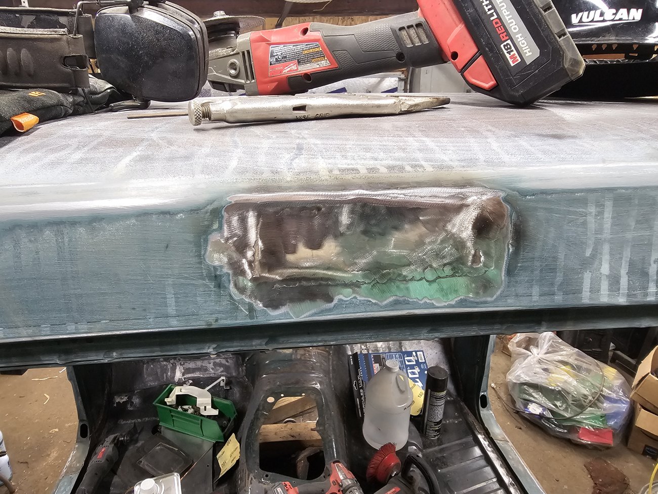

Today I filled in the cargo light hole on the back of my replacement cab, I had forgotten about the hole being there until I started prepping the roof for paint the other day, haha.

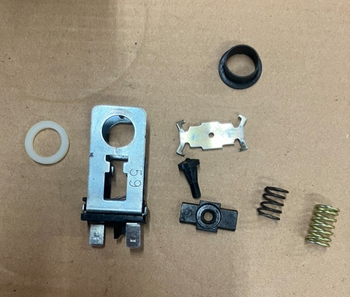

On the other front, I took the new brake light switch on and off and apart and back together another 20 times on the Missing Linc.
Two brand new switches, and a new bushing kit, and it was still doing the same thing it was doing before: you could push it lightly, and the brake lights would come on, push it further, and then pull back on it, no lights, and then step on it again and brake HARD, no lights. No lights when you were braking hard. Not good.
Stupid design. The really stiff spring actually holds the switch open as you step on brakes. Eventually, if you step hard enough, it compresses the spring and makes contact. To fix it, I finally replaced the spring (which was NOT designed to be replaced) with a thinner/softer wire spring with a much lower spring rate. I had to do a trial and error about seven or eight times, taking a little bit off the spring each time, but I finally nailed it. I can now take that switch in and out with my eyes closed.
In retrospect, I’m thinking the linkage between the foot pedal and the vacuum booster/master cylinder may need adjustment to remove any slack in the motion in the connection. In any case, the lighter spring ended up doing the trick.

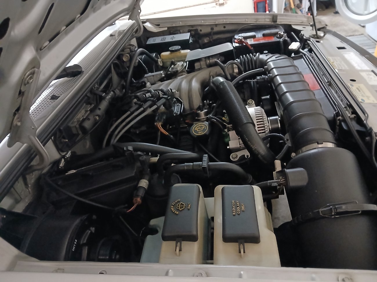

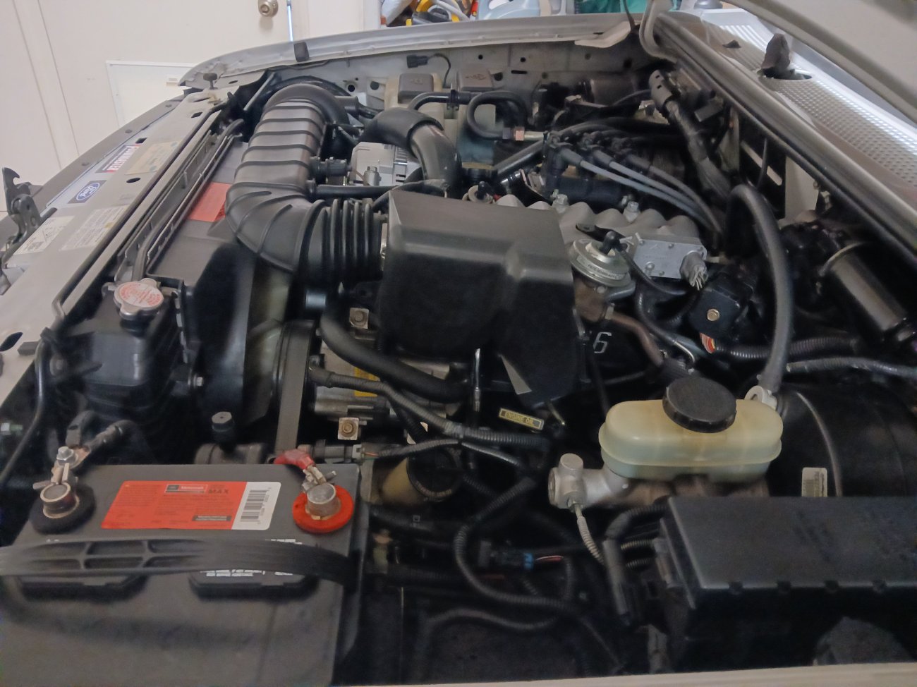

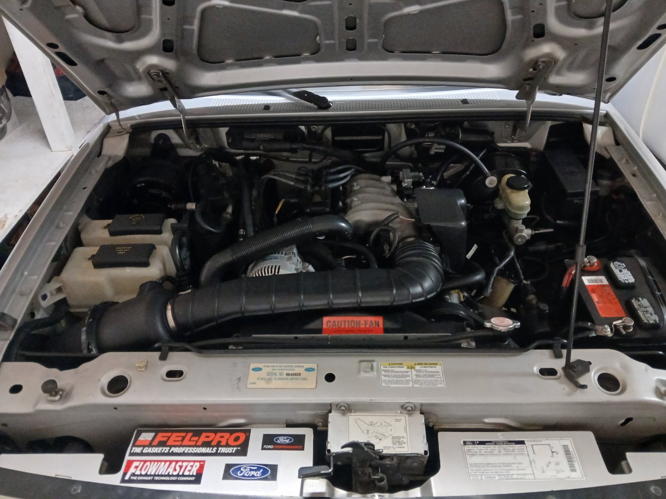

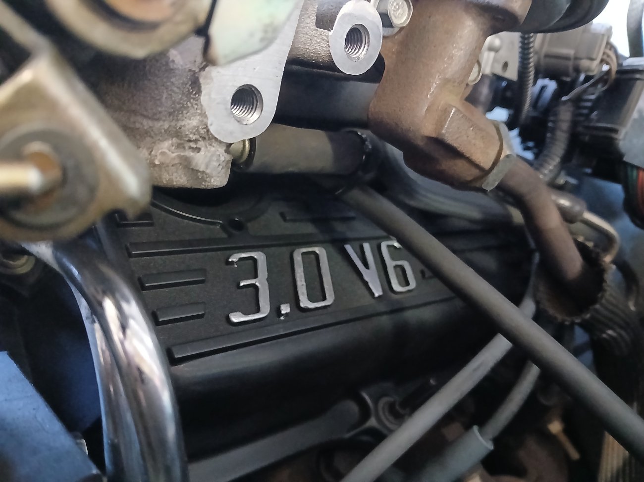

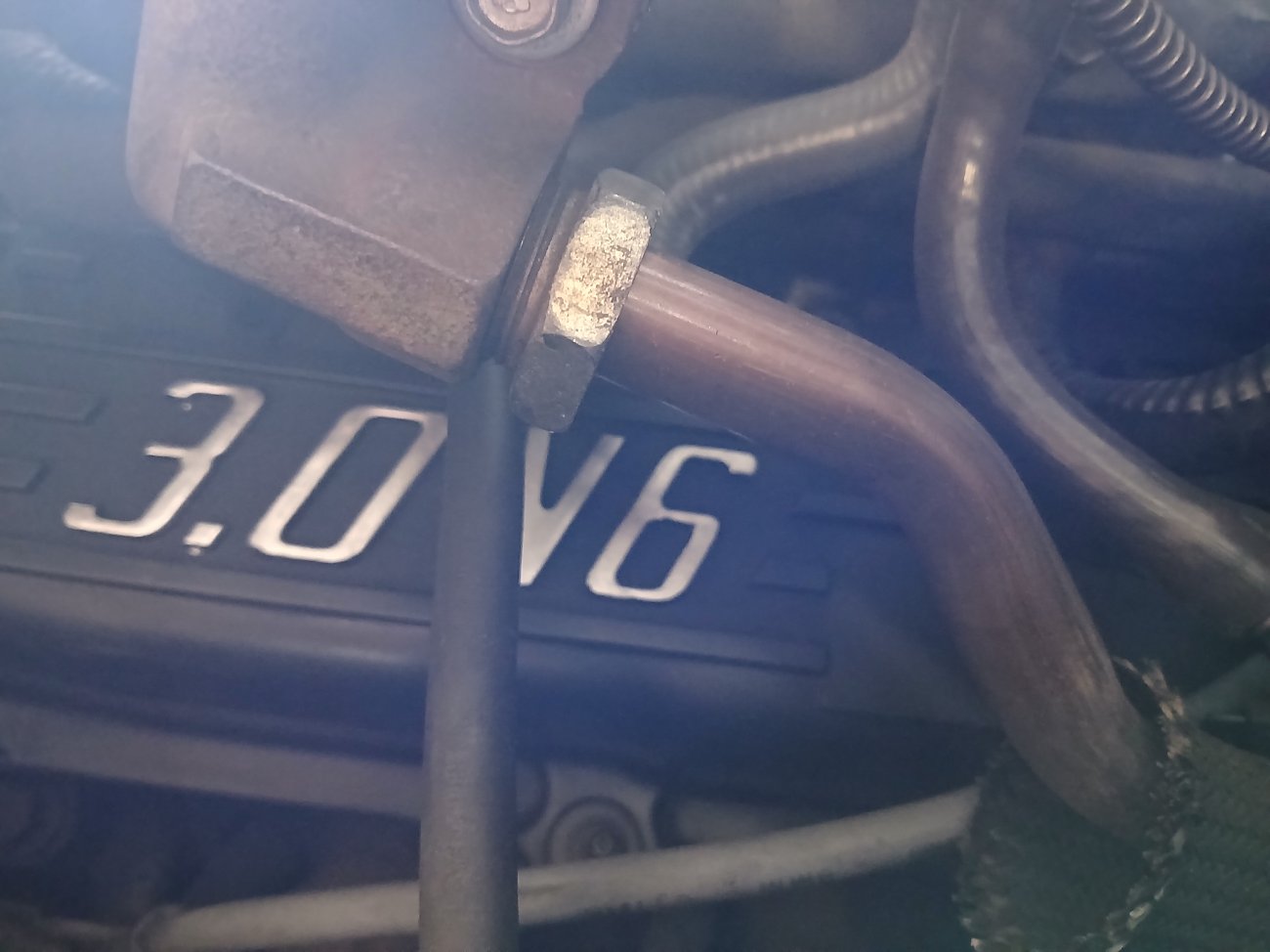

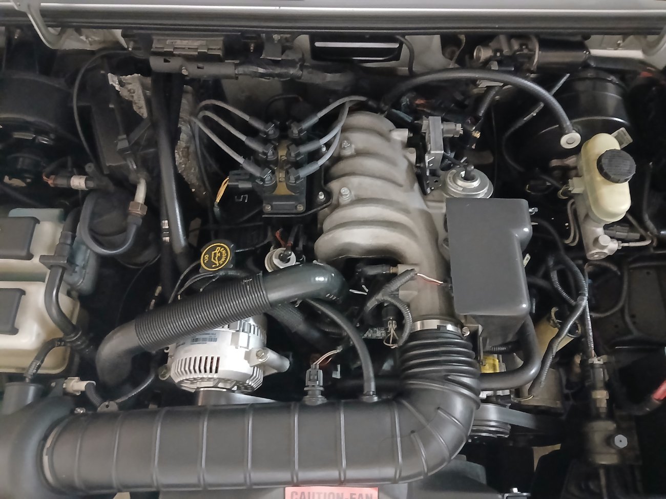

Through the weekend spent sometime in the engine area checking somethings as I'm still monitoring this truck. Everything is looking and sounding great. Still putting miles on it as I am able to. This truck has come along way since I have owned it.

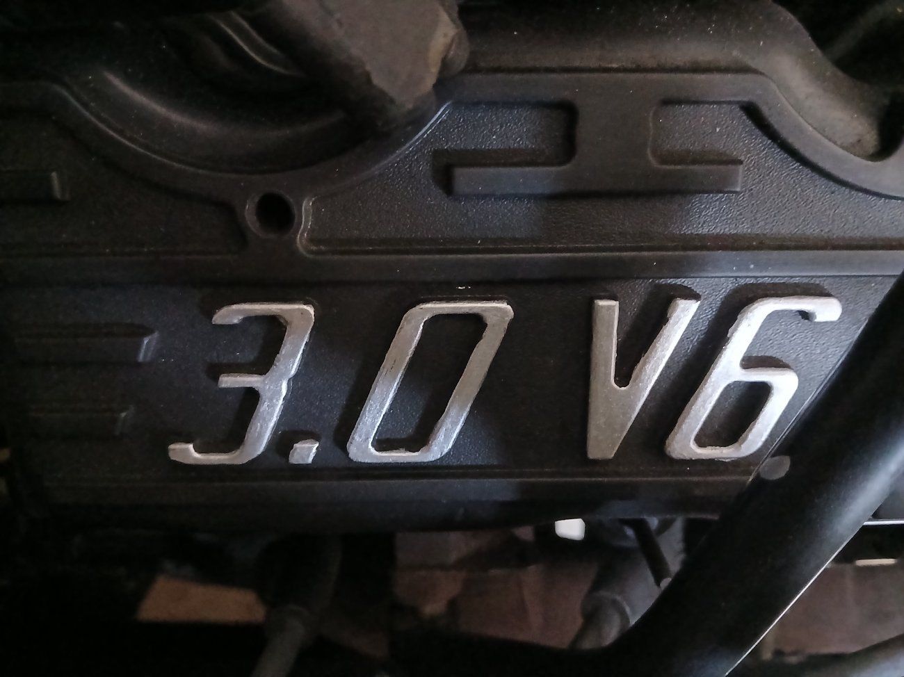

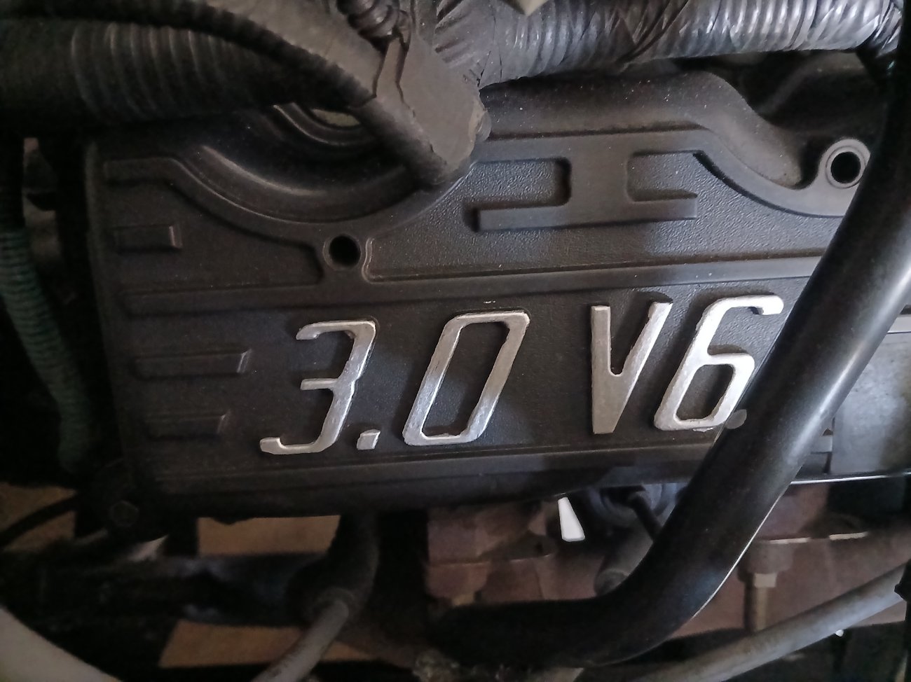

Did some cleaning and painted the numbers and letters on both valve covers. As some of you may remember I did this on my 94 3.0, that was in green. These are silver to match the truck. For a stock 3.0..I'm satisfied with how it sounds, still need to remember this engine is stock. Sometimes i believe its the 3.0 in my 94
..I need to be a little easier 😁. It still gets going really good.
Redid the stickers also..Just to stay busy at times to take my thoughts off my health issues.
In long terms of what and who I've learned from including here of the indepth of mechanic knowledge on evey levels to what it does to get it done...we've all been there. From how this truck was when I bought to how it is now especially the engine with all its had done to how it performs and sounds is absolutely amazing..despite my poor health issues, I still have my mechanical knowledge and abilities to a certain point of what i can do. Other times i need to have my mechanic handle the work.

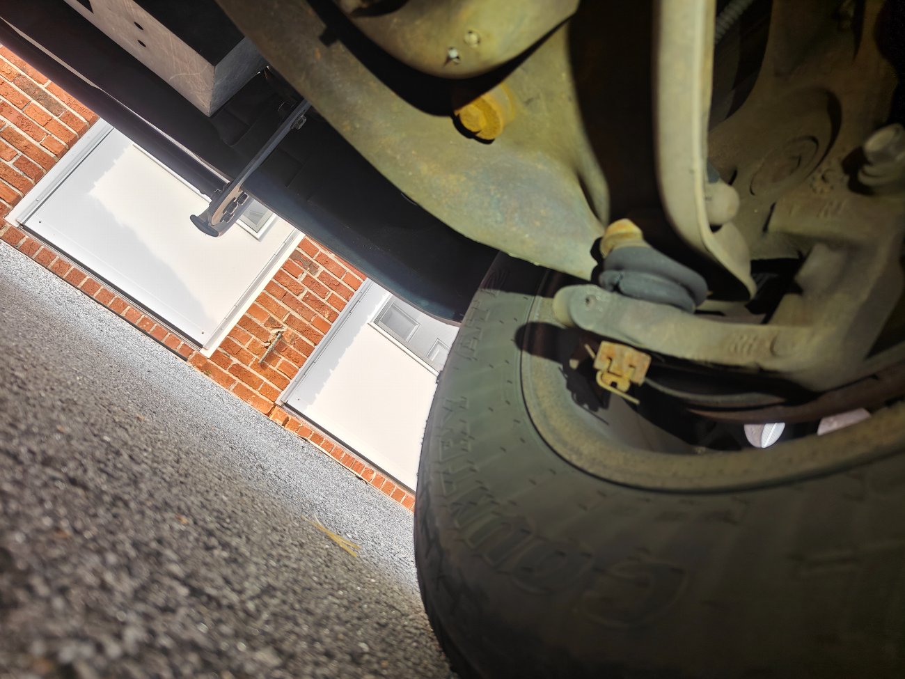

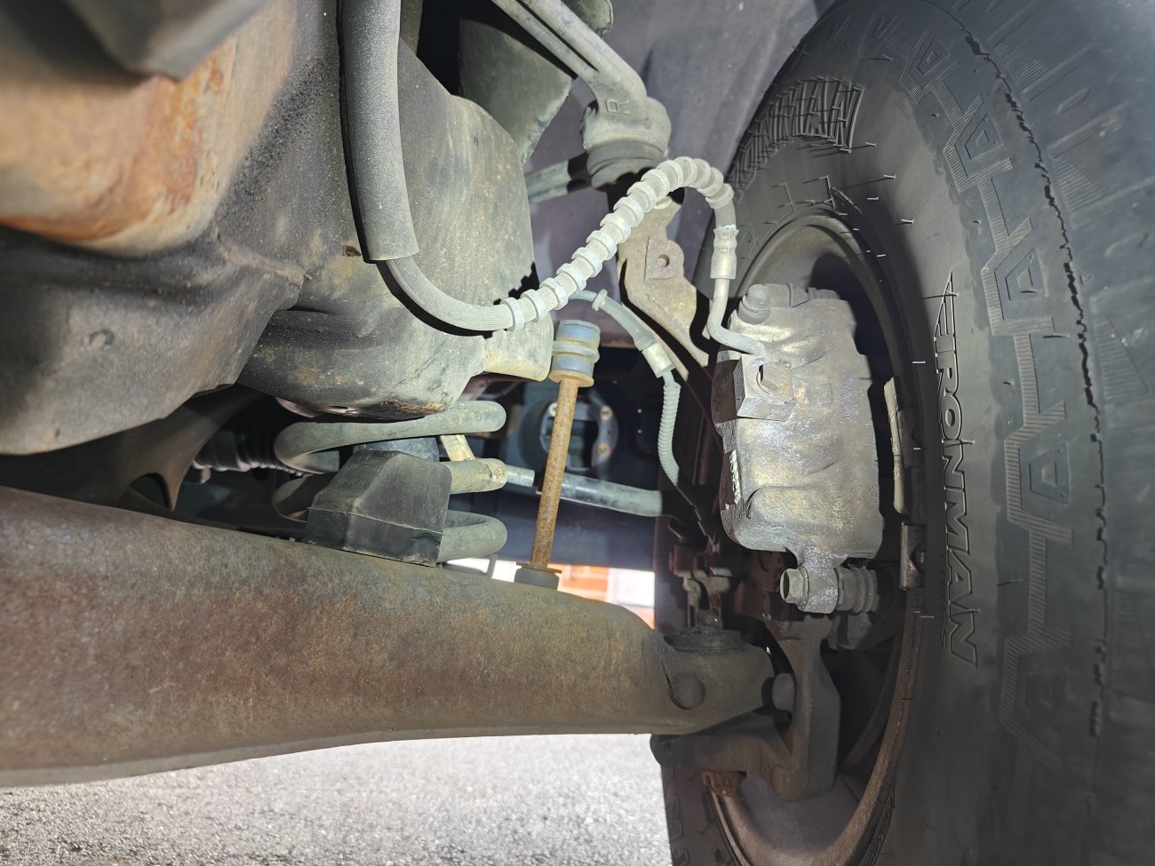

Got up under it today. It's shaking. Bad. Every single one of the bushings is cheese soft. The aptly-named Walker Ford Ranger is actually walking. It looks like the sway bar is moving back and forth, and so I'm basically just going to replace everything in the front end from hub to hub.
It also looks like I need to replace both coolant hoses, the power steering pump and rack, possibly the tensioner pulley, rebuild the transmission, replace the rear main seal, install new engine mounts...
Time to start a thread.

If it's shaking tires vibrate around 55 when they blow a cord, otherwise I would look at tierod ends first, sway bar bushings won't make it shake, that's more of a symptom than a cause.

Good to know, thank you! These tires are pretty much EOL.
