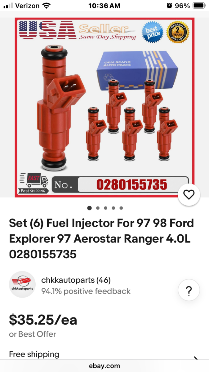

With all the things I’ve tried and the advice I’ve received from TRS, I finally came around to a dreaded thought: fuel injectors.
I had that reaction because every time I ever fooled with fuel injectors on what I used to drive, it always started in high three $$$ digits. I had an equally positive reaction when I looked online and realized I could buy a set of six for $35. Ordered. Woo hoo!!
Question: is checking the injectors as simple as connecting and disconnecting the electrical on them one by one to see if it makes a difference in the engine, like you pull spark plug wires? I’ve had to pay to fix them before, but I never diagnosed them.

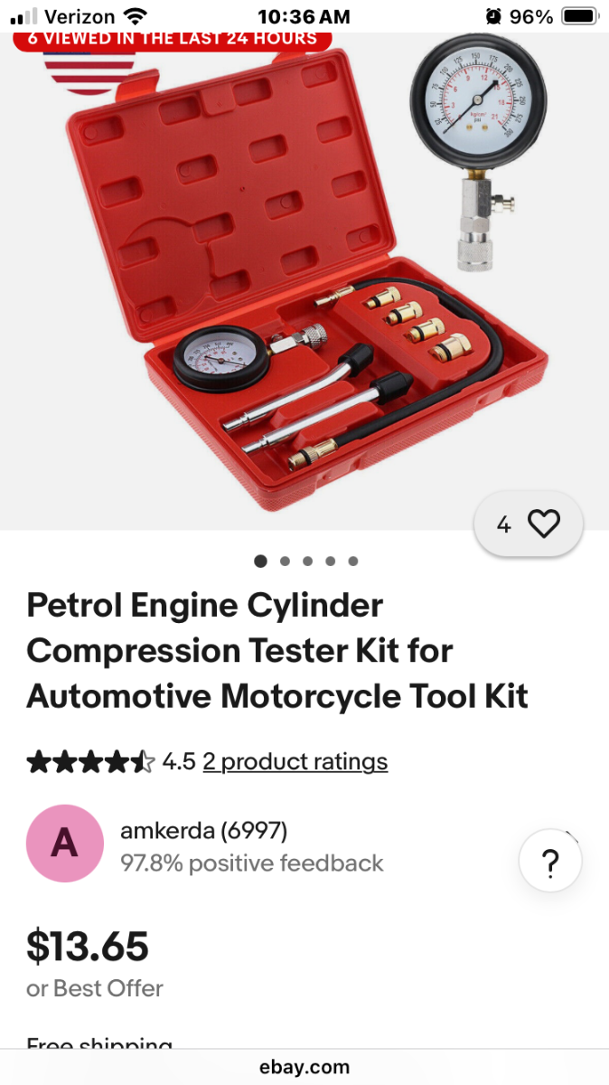

The compression test kit came in, so I’m going to try that.
If that doesn’t reveal anything, I’m going to put the injectors in. Is there any way to test if they’re good so I can save the good ones as spare parts?

That injector ad says $35/ea. Sure you’re not going to get just one injector?
Plenty of y-tube videos about how to test/clean injectors if you look. Simple benchtop procedures.
This. I've seen plenty of these games on sites, even on Amazon. Don't be surprised if you actually get just one injector.

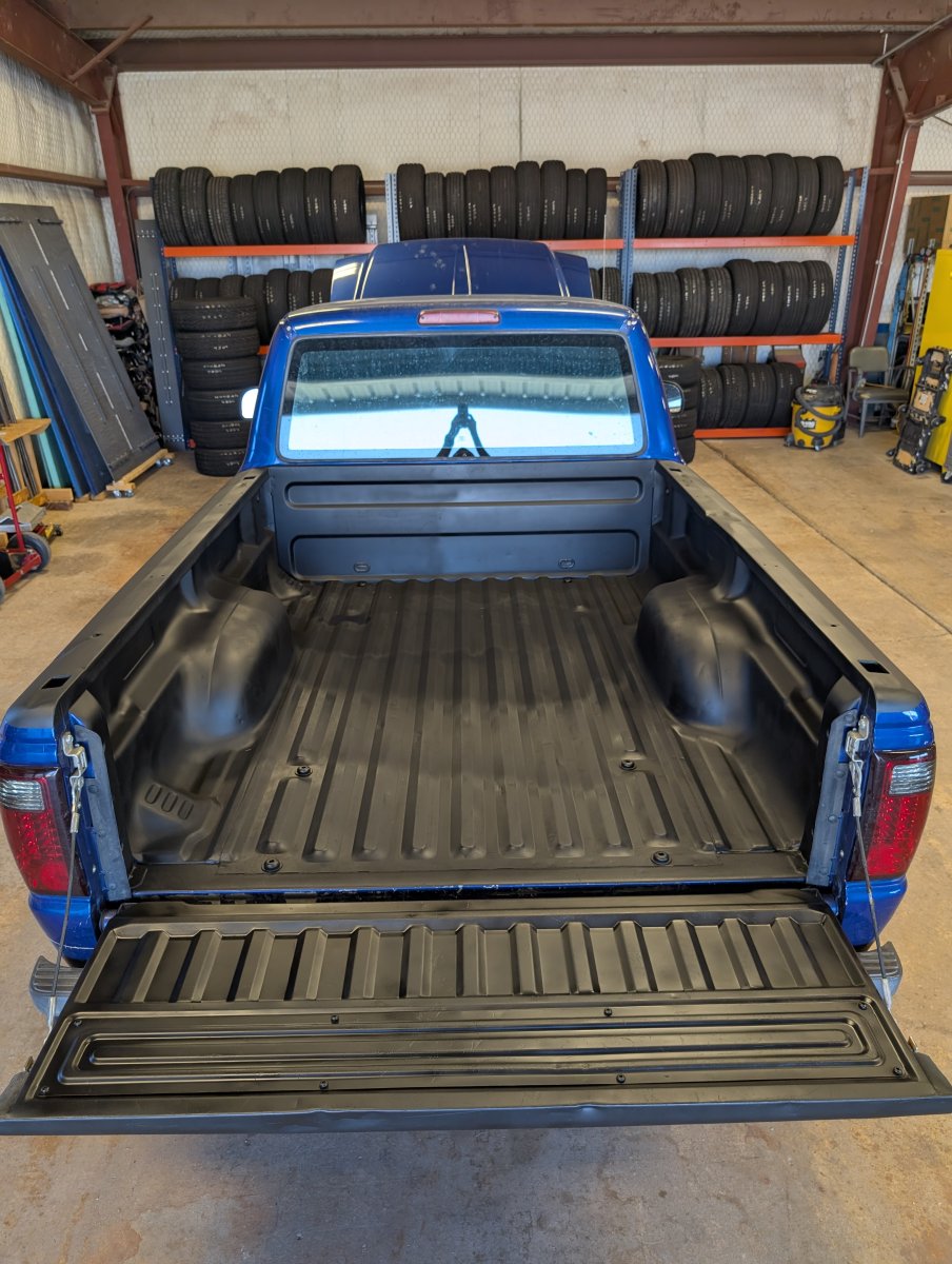

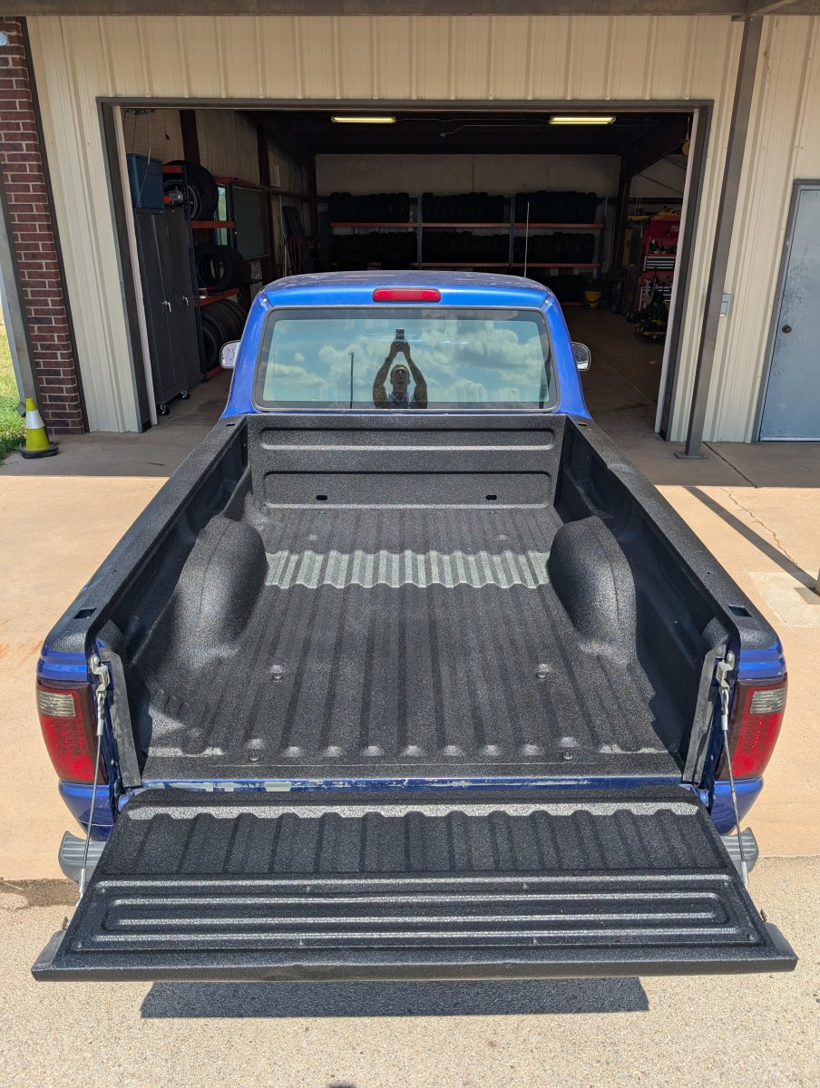

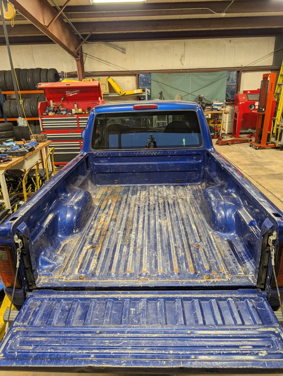

Spent some free time during the week working on the bed of my 2003 regular cab.
What it looked like when I got it:
After I prepped it and put a coat of primer:
Finally finished with the Herculiner Pro DIY spray kit:
It turned out really well. Looks like I paid for it. I guess we will see how well it holds up.
The kit was really easy to use. Beware though, the over spray is A LOT so make sure you cover everything up well.
& @ekrampitzjr
I’m not an eBay virgin, I read the ad a bunch of times. The cars I drove in the past were a little bit more exotic.

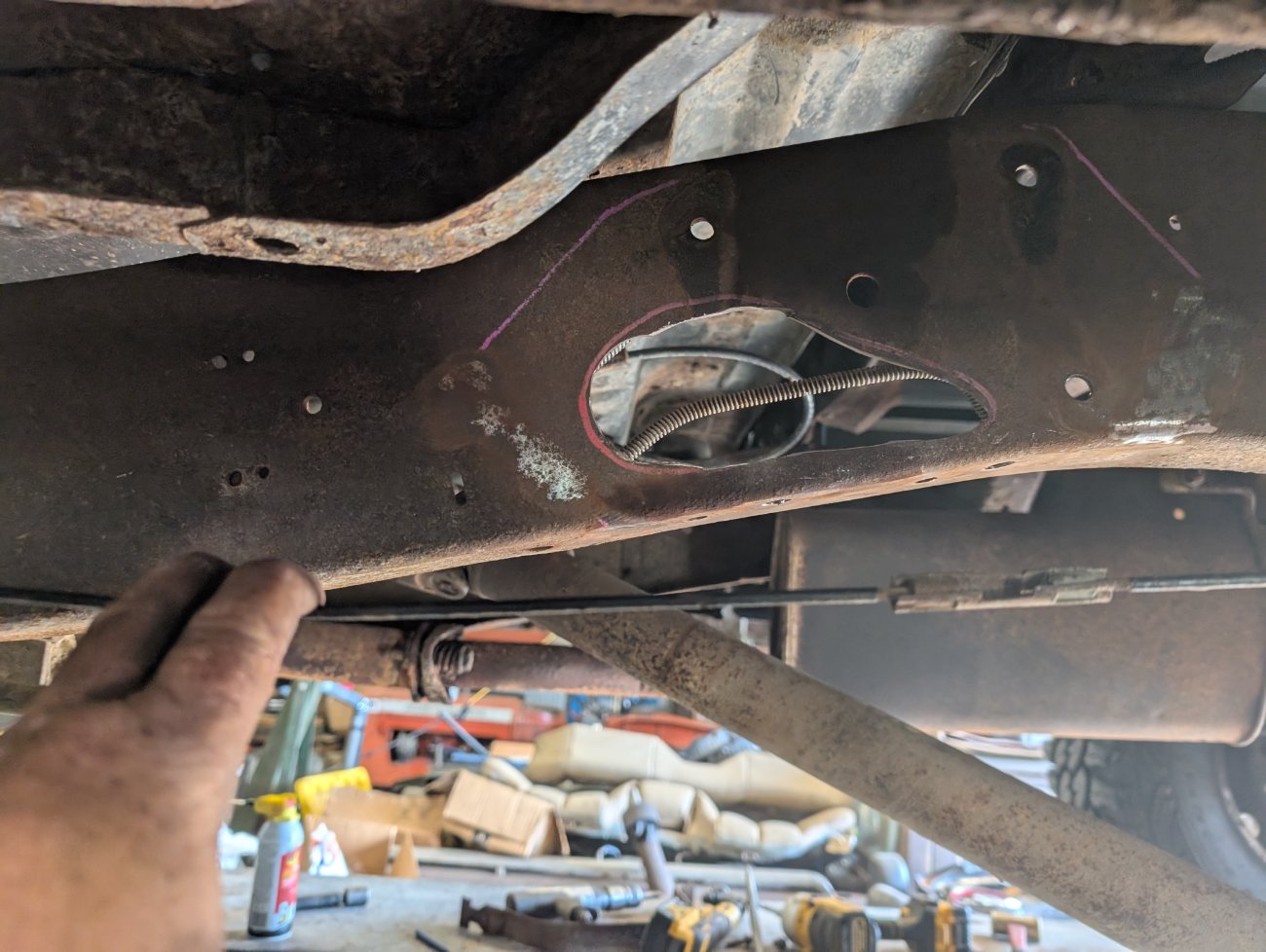

I cut a big hole in my frame.
#ohiothings
Are speed holes still popular? LOL
