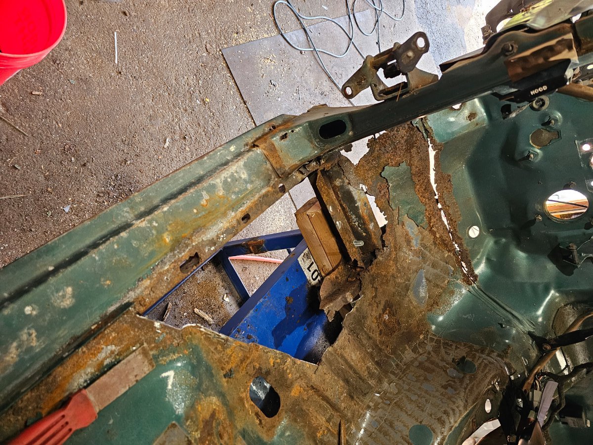

Got my replacement cab moved into my garage today and started messing with it a bit. I found lots of small holes here and there but its still better than the cab on my supercharged truck by a long shot. It'll give me something to work on during the fall and into the winter. Going to try to fix every spot I can find in the hopes I never have to do this again.

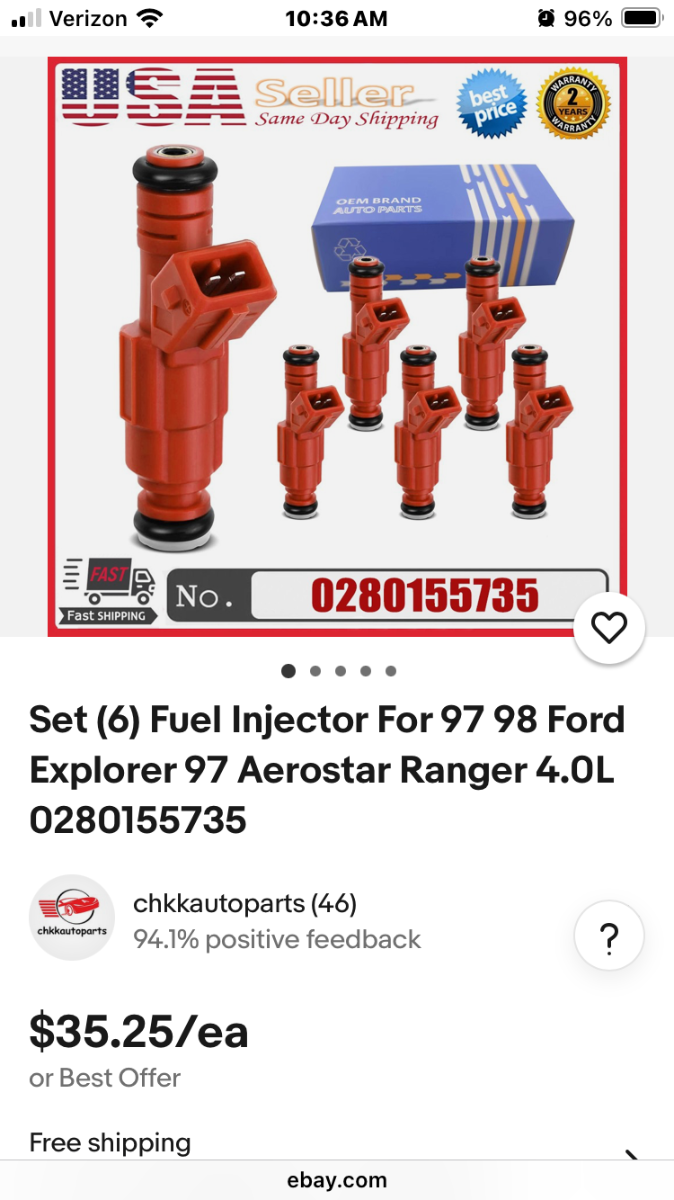

With all the things I’ve tried and the advice I’ve received from TRS, I finally came around to a dreaded thought: fuel injectors.
I had that reaction because every time I ever fooled with fuel injectors on what I used to drive, it always started in high three $$$ digits. I had an equally positive reaction when I looked online and realized I could buy a set of six for $35. Ordered. Woo hoo!!
Question: is checking the injectors as simple as connecting and disconnecting the electrical on them one by one to see if it makes a difference in the engine, like you pull spark plug wires? I’ve had to pay to fix them before, but I never diagnosed them.
So here’s the current plan. I’m going to fiddle with the fuel injection wiring and see if that makes any difference, if maybe I have a bad connection somewhere.

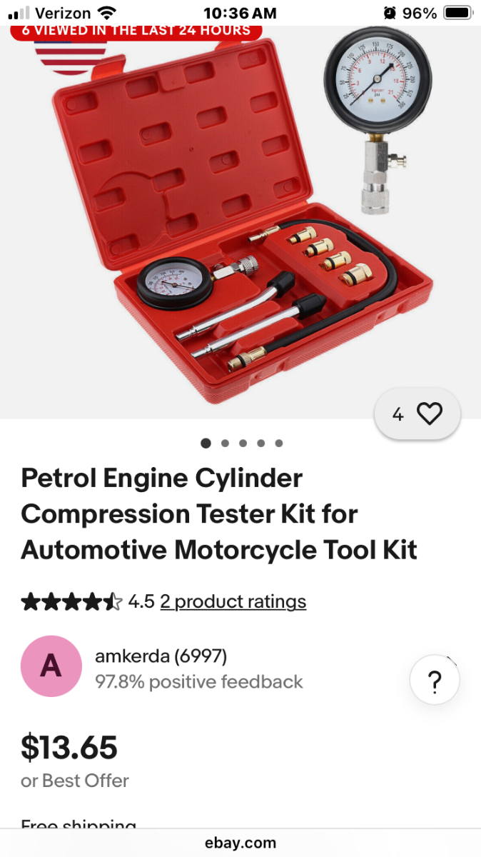

The compression test kit came in, so I’m going to try that.
If that doesn’t reveal anything, I’m going to put the injectors in. Is there any way to test if they’re good so I can save the good ones as spare parts?

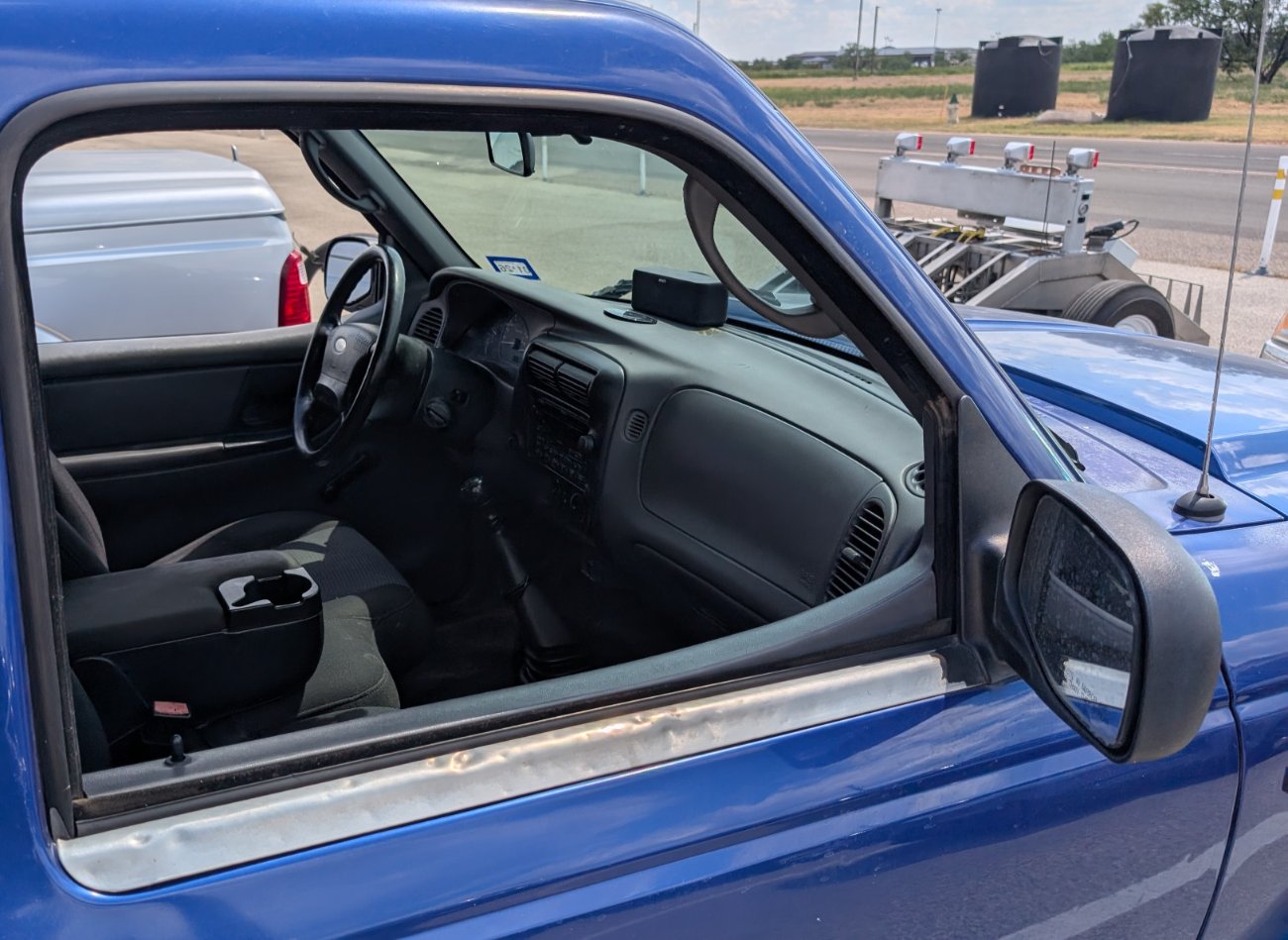

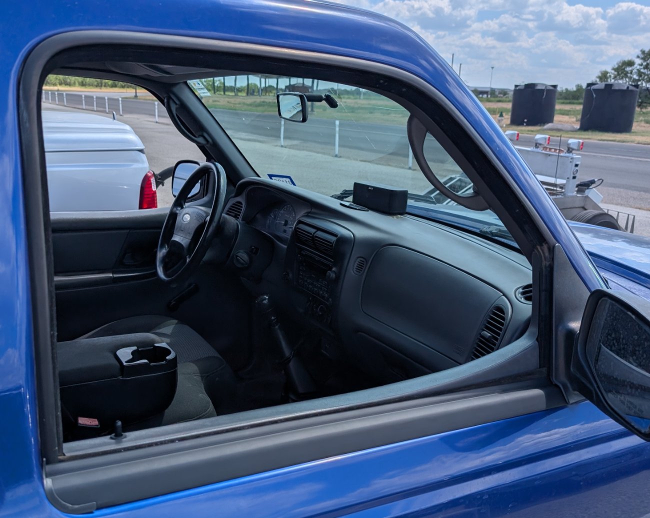

Re-patched my tailgate paint job where my ranger was missing a chunk of paint due to a "Commercial Vehicle" sticker from hell that pulled all the paint off down to the metal except for the letters that said "Commercial Vehicle". I had previously painted that over but the clear coat hadn't cured before I accidentally hit it with some bed liner overspray on Friday and then I wiped it with acetone. It was a mess.
Next was replacing the following:
Headlights (plus aiming them)
Fog Lights (one was busted but I replaced both)
Corner lights (went from clear to amber)
Door trim moulding (both sides)
Mounting passenger grab handle
Cleaning/prepping my tool box for mounting tomorrow

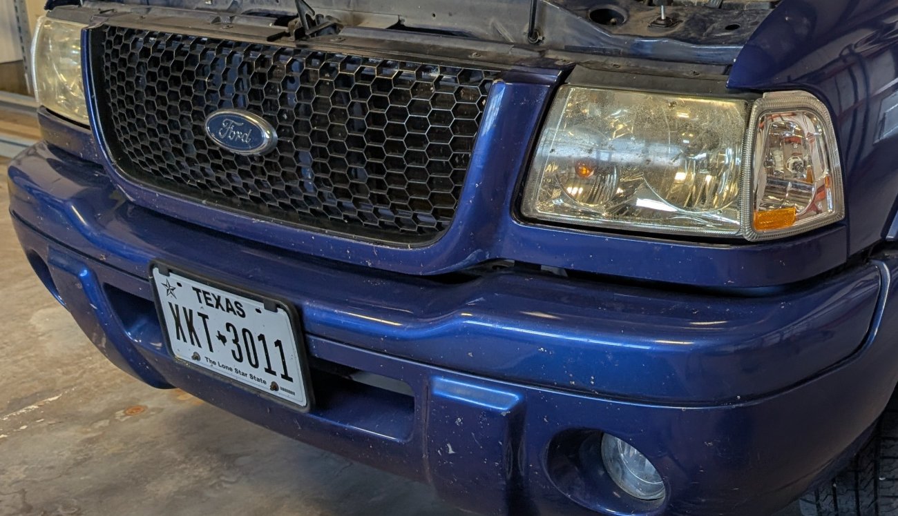

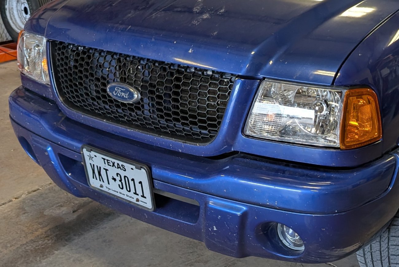

A few before/after photos:

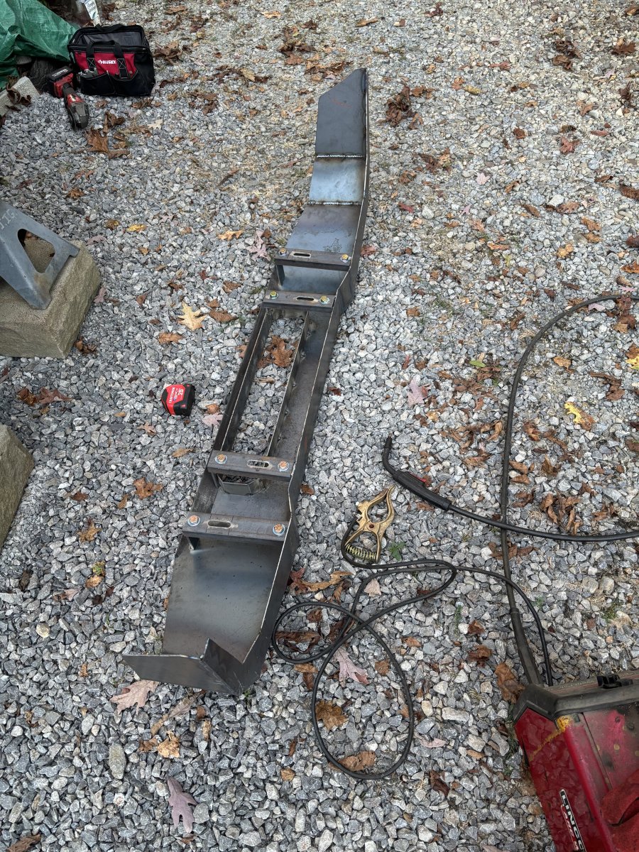

More progress on the front bumper. Need to finish weld the mounts and the center stuff yet, probably a little bracing, and I need to make the fog light mounts, then it’s finish weld the outside, do my tube work, and off to paint… (that, is also my job, and @Rick W can sleep soundly tonight because it will be Rustoleum).

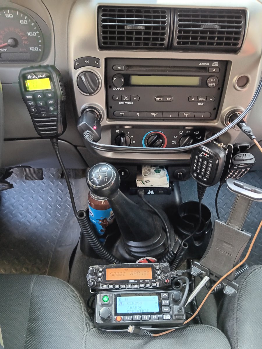

The new digital radio is in and programed. While it may not look like it, it did clear up some of the clutter. Now to get used to using it. DMR radios are less than user friendly. The new radio is the one with the white display. The orange display is the quadband radio that is analog only but can do 6 meters and 10 meters along with 70 centimeters and 2 meters, but can only do two at a time. Thus part of the reaaon the digital radio is there. The GMRS radio is tucked under the dash and controlled with the handset that has a green display.
Finally the quad band is off center and canted on purpose. The shifter was touching the left dial and changing frequencies on me and the radio needed to be slightly canted so it is easier to read the display. Light from the windshield was washing out the display regardless of backlight setting.

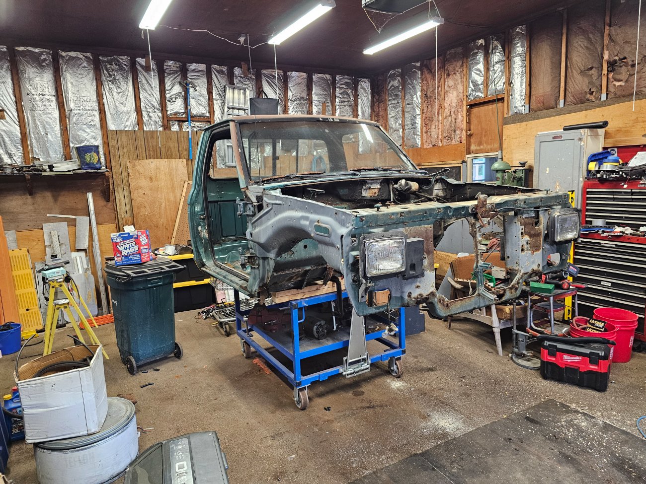

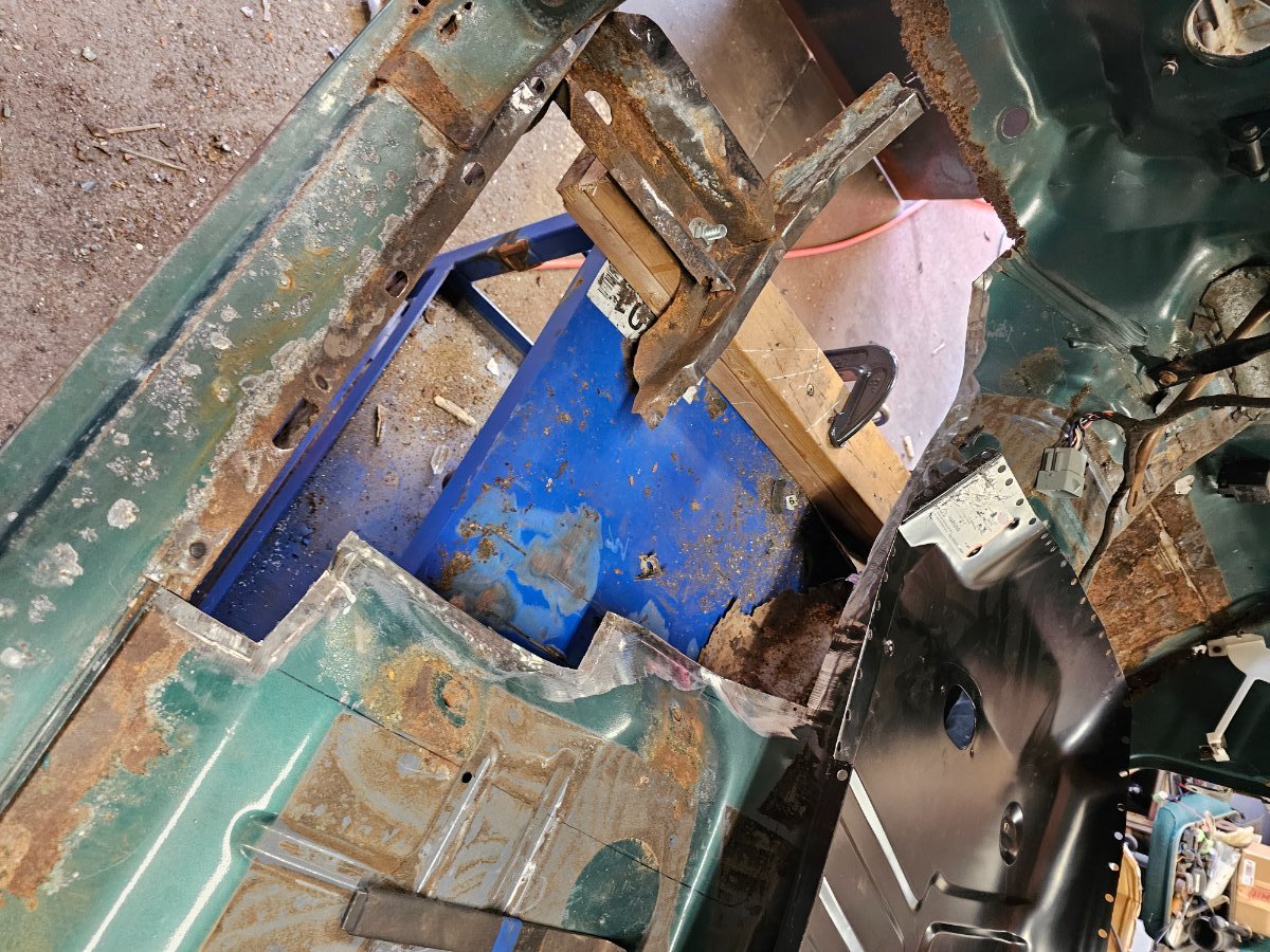

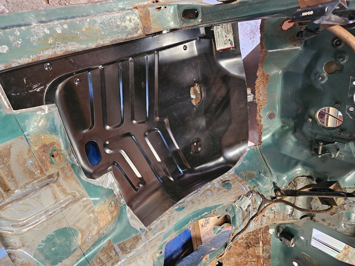

Got further on my rust repairs, fit the driver side floor in the replacement cab. Need to drill some holes for spot welds for the reinforcement then hit all the edges with weld through primer, then its ready for getting stuck together.
