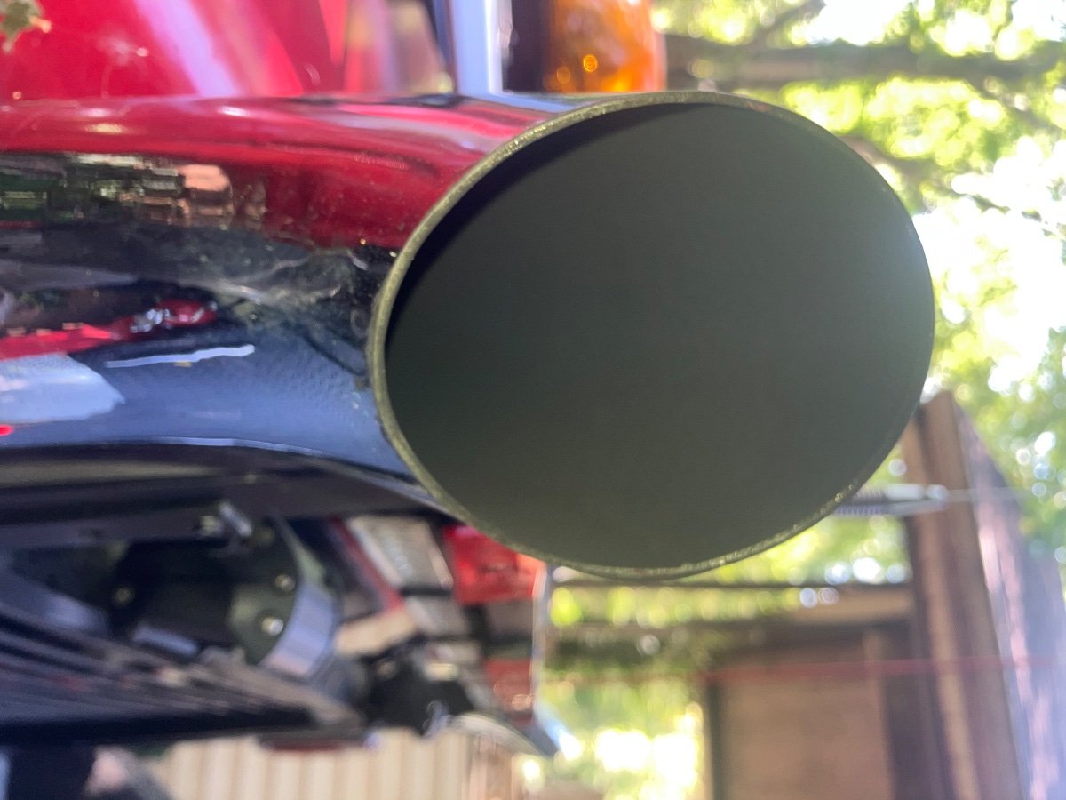

have access to an IR thermometer? check all exhaust runners for consistent temps.
to me that second pipe looks too clean to be true. :dntknw:

FYI Second pipe is run from the original exhaust system. It was two into one and went down the passenger side. The guy cut it and capped it at the Y, the passenger side is the original cat for all six cylinders, runs through a small glass pack, and turns up through my 3 inch chrome stacks.
The driver side was a new universal small cat, then run through the small glass pack, and up the 3 inch stack on the driver side.
No leaks on either side. I hate to cut into the relatively new work, but I’m thinking of getting or making a straight pipe and just swapping it where the cat is on the driver side to see what happens. Using clamps.

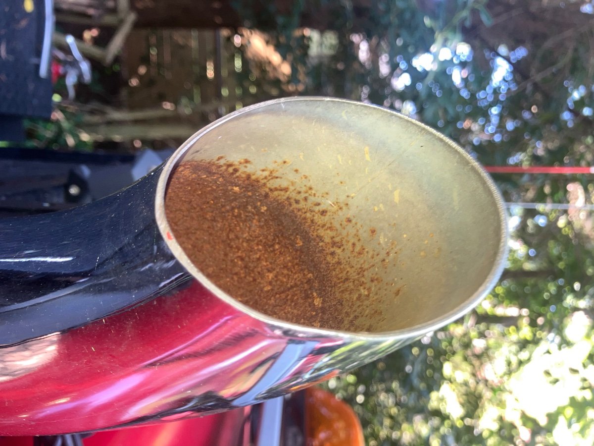

Oh wise ones, I need some help, some wisdom.
That 97 4.0 has been running like a top ever since I got it. 300,000 miles, one owner, extremely well maintained, now 320, and I didn’t think to tune it up until I had a miss coming back from Ford nationals in June. Actually, I couldn’t really feel a miss, but I feel like I had a slight loss of power. It’s still runs very strong, but doesn’t seem to run as strong as before, but it might be in my mind.
When I got home, the left exhaust pipe was full of soot, and there was soot on the rear fenders on the left side. A lot.

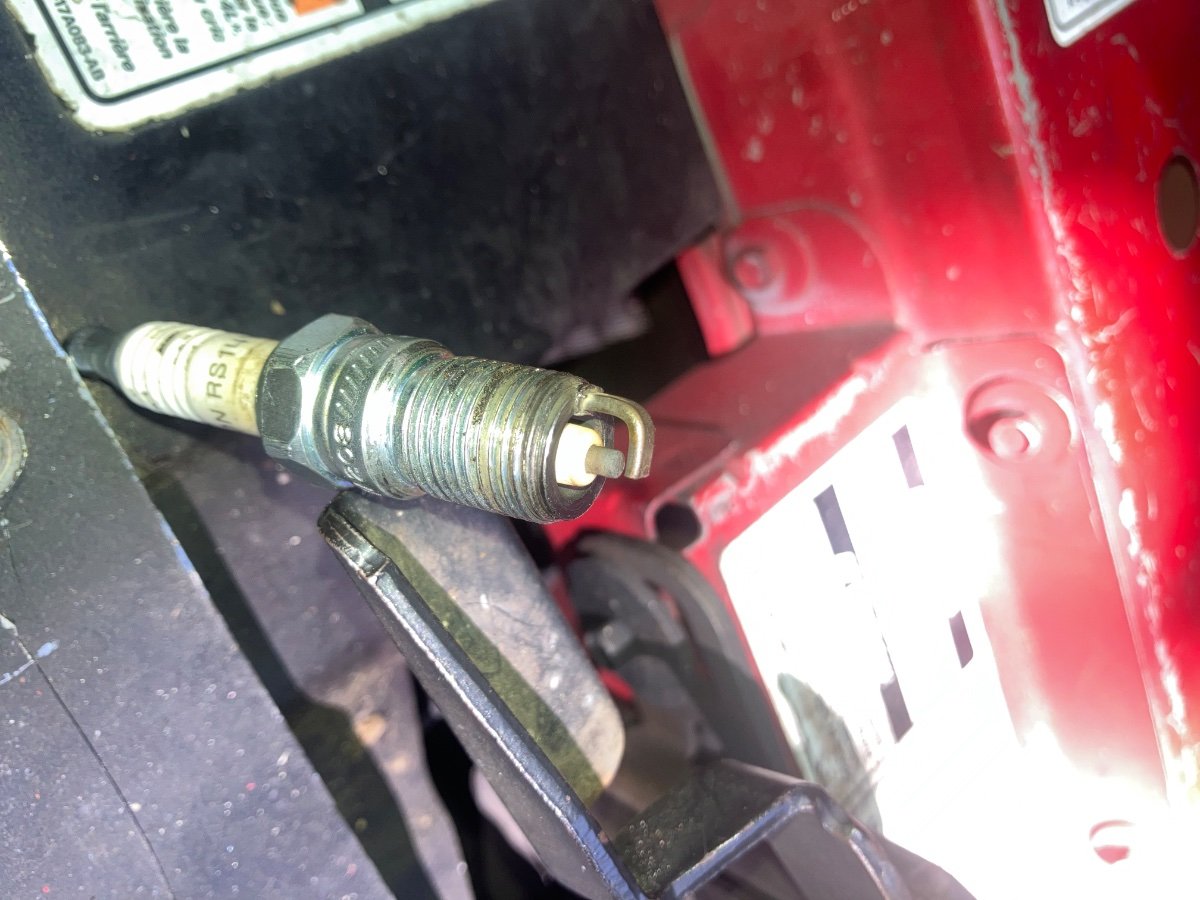

When I pulled the plugs, the driver side front spark plug was actually loose, it was still in the threads, but it was loose enough to wiggle it and remove it with my fingers. When I pulled it out, it was covered with soot. I put the new spark plug in, and it tightened down like normal. I don’t remember ever having a loose plug in the last zillion miles on any of the dozens or hundreds of vehicles….
I put in new plugs and wires. I haven’t put in an I haven’t put in an PCV valve yet, but I find it hard to believe that would be the problem. After driving it a couple hundred miles at highway speeds and temps,, I still have some soot in that left pipe. Left compared to right, today.
View attachment 133456View attachment 133457
Last week, I ran the gas tank down to less than a quarter tank, and I put in a can of seafoam. I ran it long enough to make sure it was hot and all through the system, and then I parked it for a couple days. Then, when I was almost out of gas, I filled it with premium. I don’t think that made any difference. I have a few hundred miles at 70 mile an hour at highway speeds since changing the plugs.
It seems to be hitting on all cylinders, but it still seems to have a slight lack of power. Not a dramatic lack of power, just a little from the way it was running when I got it. I can’t tell if it’s got a miss at lower RPMs, but I do still believe there’s a lack of power. I’m not sure if the miss is in my mind.
Today I pulled that spark plug, and it looked fine.
I’ve wondered off and on if it had a blown head gasket, but it just runs too well. For unrelated reasons, I took the top radiator hose off a couple times, and it always takes checking it after some miles a few times to get the radiator topped off. But I think that’s because there’s no good way to burp it, not because it is consuming radiator fluid. It was full when I checked it today after a couple hundred miles.
So here’s my need. What do I check next?
I’m going to buy the gizmo to do a compression check. It’s in the mail. Btw, it’s not using any oil I can notice.
Could I have fouled the catalytic converter on that side? That cat has less than 10,000 miles on it. I understand the science, and if I was feeding hydrocarbons into it when the spark plug was loose, once I fixed it, running at highway speeds and temps, shouldn’t it burn off the carbon off fairly quickly? Before, when I’ve had a cat that was plugged, the vehicle ran like absolute crap. It’s still running pretty good. ???
What else can I check short of pulling heads?
Plugs working loose happens sometimes, even if you install them with a torque wrench.
Soot generally means the engine is running rich. The Seafoam you put in the tank should address the injectors, if they were the problem. Just keep an eye on the plugs and see what happens.
As far as the soot in the exhaust, once it is there, it will never completely go away. It's kind of like trail dust or desert sand. It gets into everything and you are never completely rid of it.

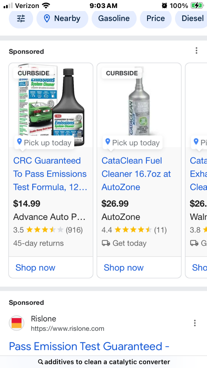

Understood. I don’t really care about the soot in the exhaust pipe, the concern is the catalytic converter being half plugged up with soot.
A few questions for everybody:
Has anybody used either of these?
The Cataclean on the right has very good customer ratings. It’s a little pricey, but of course it’s fraction of the cost of the mechanical repair. I think I’m going to try it, but I would be curious to hear your feedback.

Short of hosing out the catalytic converter with a garden hose, I don't know of anything that will remove carbon build up.
I suppose you could do what I've heard some have done in the past. Remove the cat, dump gas in it, light it on fire, shove the metal tube from an old school vacuum (with the hose connected to the exhaust port of the vacuum) into the catalytic converter and let it burn until it burns itself out.
The above might work but I've never tried it or knew someone who has and mentioned that they did it.
