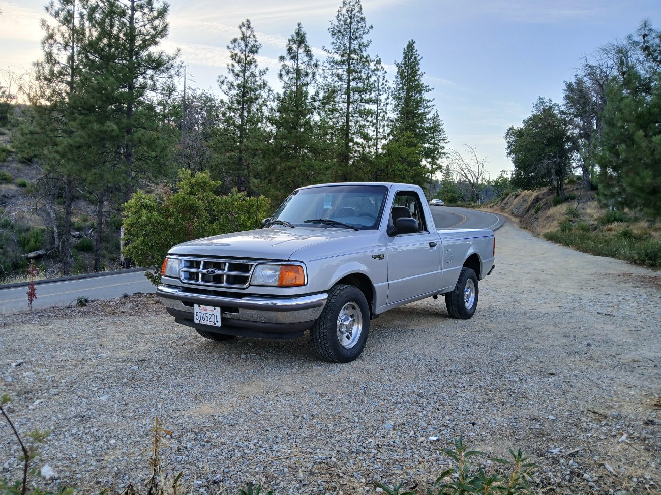

Went to the lake this evening for some nature time. It's been a slow process to drive that way again...I'm going as I can.

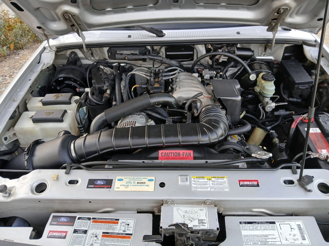

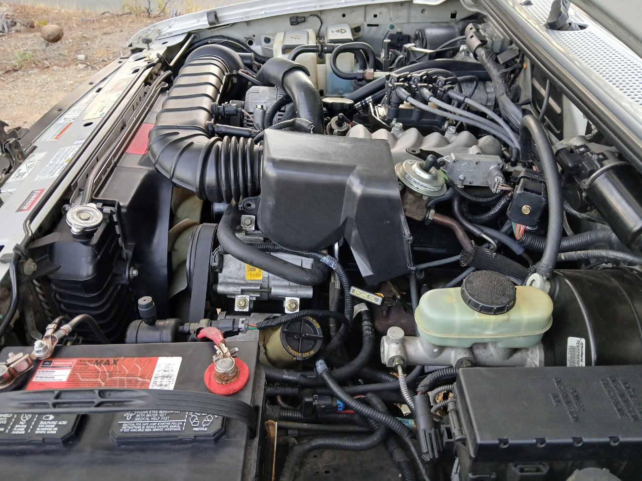

A couple of pictures of the lake and my 97, and the Ole 3.0..still working to keep it clean and reliable. Still dealing with alot of health issues and the pain is intolerable, yet I'm still alive and going.
It's now registered in california, what is left of it. After the state bent me over backwards and forward then backwards again on these high fees..it's done.
Glad to see you got out and got some pictures to share with us all! Always love seeing what you capture.
That first picture of the Ranger would be great for the next calendar.

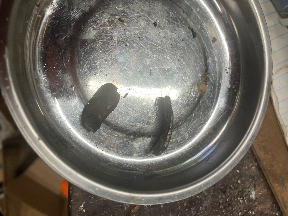

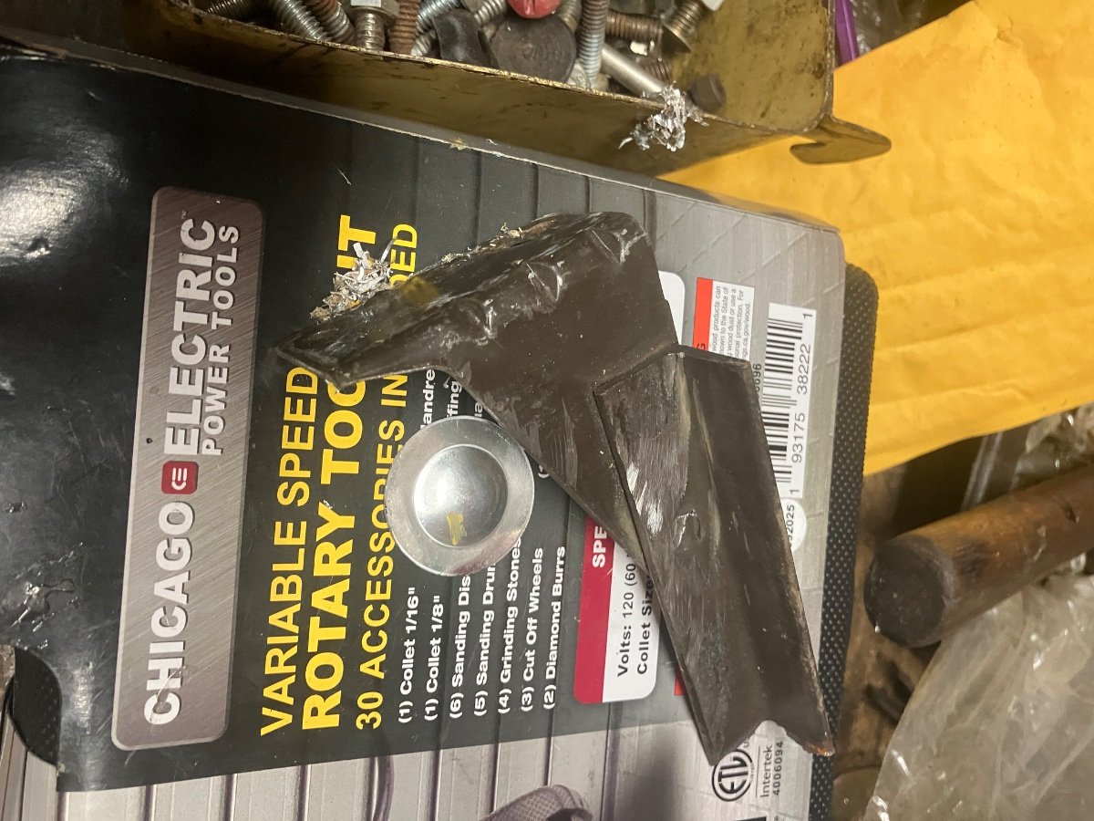

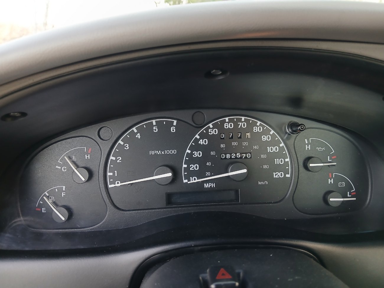

The Road Ranger battery light has been flickering. The gauge looks like everything is just fine. So first thing I did on catching up on nit picky things on the truck was to pull that alternator. It’s a relatively new rebuilt 130 amp. I was thinking it might be the voltage regulator.

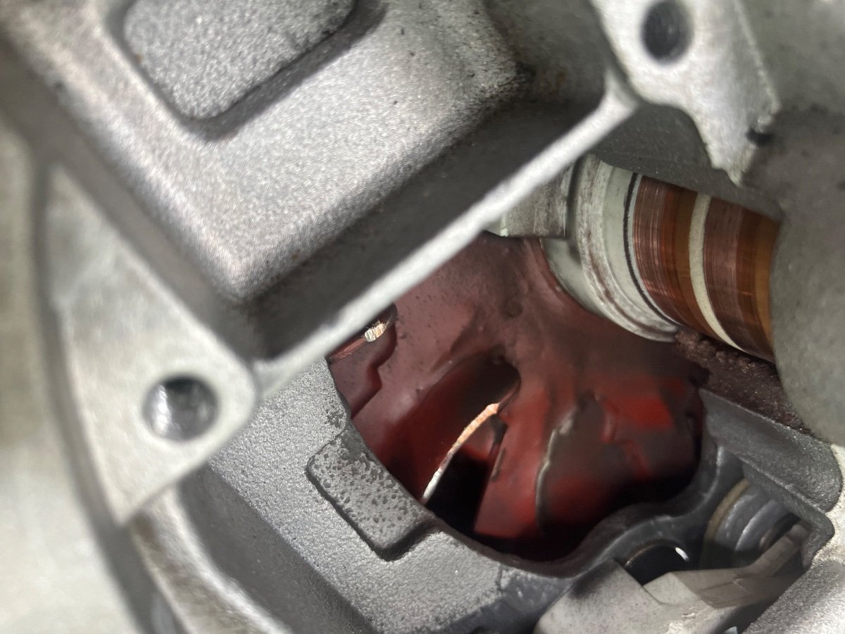

When I took it out, and I took it apart a little, I could see that the fins on the red wire winding were scraping.

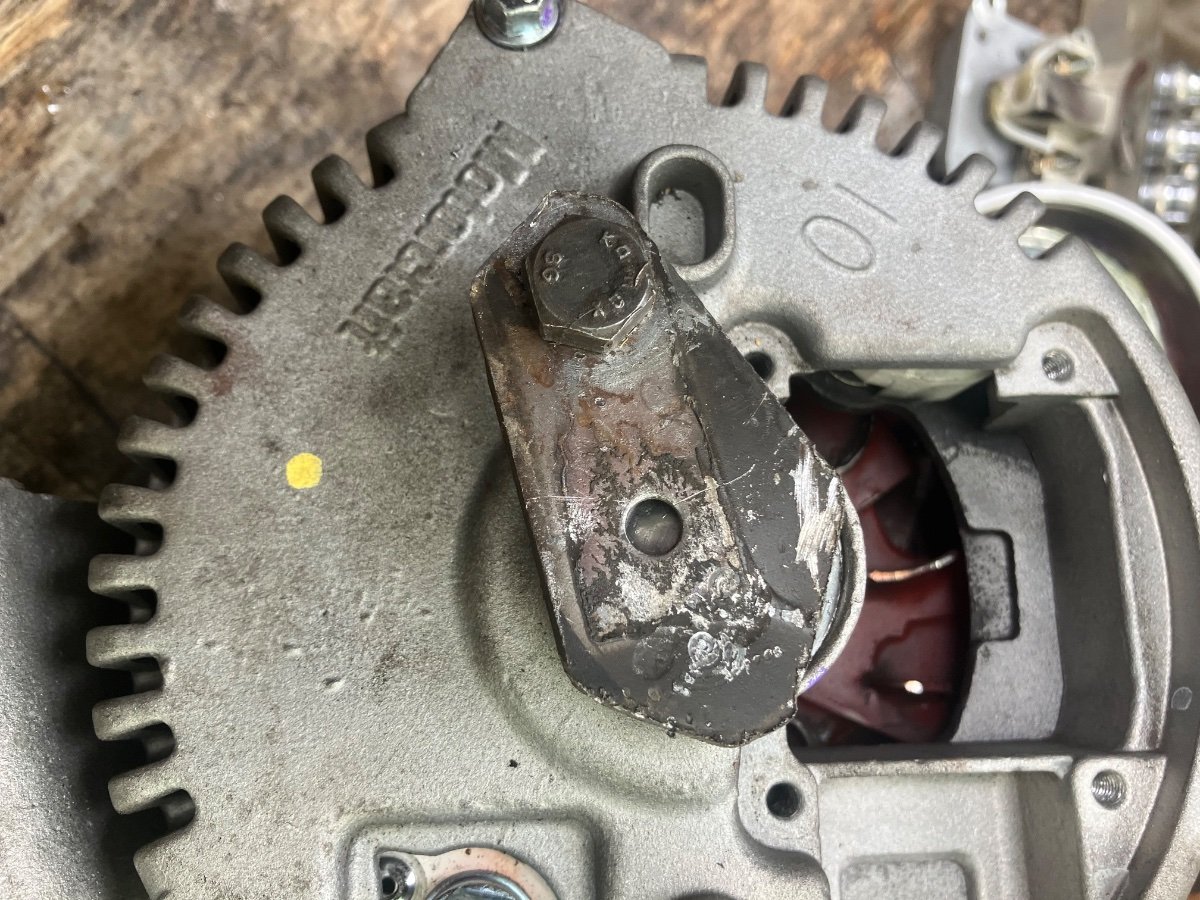

As I fiddled around, I realized that you could push the shaft in and out about an eighth of an inch or maybe more. I don’t remember an alternator ever doing that. I took off that top cover, but I couldn’t see anything there. As I was wiggling it around, one of those little fins actually fell out, having broken off.
When I looked at the back, there was a cap with a little dimple on it that went over the bearing on the backside. As I looked at the housing, there was an empty bolt hole next to it. Virgin, nothing had ever been in that hole. I think that was for a little flat bracket to keep that cap seated all the way down. I couldn’t find a picture of anything like that anywhere. So I did the most logical thing:
I went into the shed of miracles, and I picked up a little piece of bedframe that holds the pin for the casters. I ground off the rivets, and then I cut that little leg thing up, so it would go under the bolt and keep the cap compressed. Cap and “new” bracket.
When I put it all back together, it seemed to be spinning perfectly, nothing rubbing. The sun was going away and it started to sprinkle. I covered my portable workbench (a student desk from Goodwill, I added lawnmower wheels) with a tarp. I’ll put it in and test it tomorrow.
Assuming it all works correctly, if anybody wants the specifications on my new bracket, PM me and I’ll send you the blueprints….

When I went to put the alternator back in, another one of those cooling vanes was sitting underneath where the alternator sits. So I pulled the voltage regulator off again, and I just spun it slowly. Sure enough, two of the vanes were broken off, two that were next to each other. The top of all the rest are scuffed.
Didn’t make me happy, but when I put it all back together, I don’t have any alternator light and the voltage gauge seems to be reading correctly. I’m probably going to pick up an alternator from the scrapyard for a truck box spare or maybe even just buy another 130 amp rebuilt, even though this one is working. I don’t know if I’ll ever trust it. But it was a good experience, taking it all apart and putting it back together.

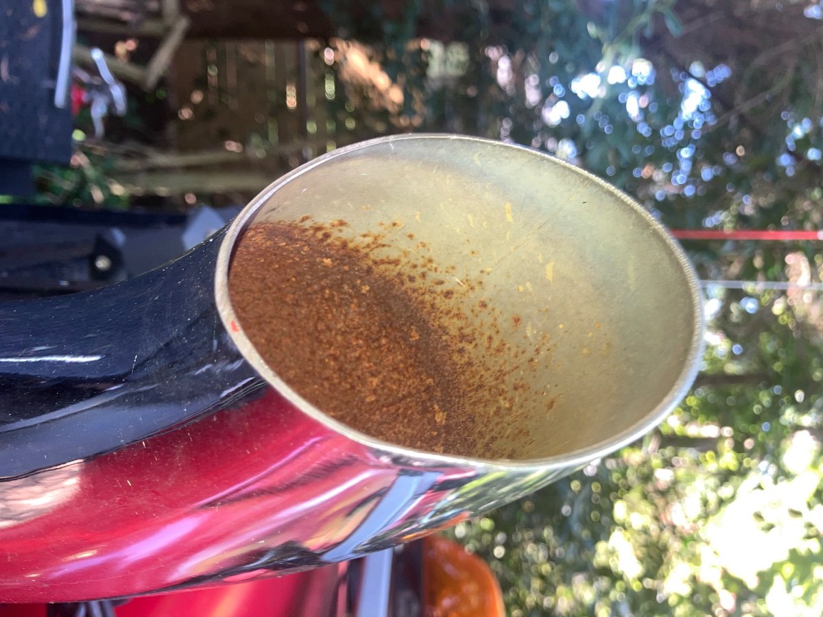

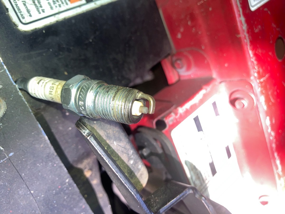

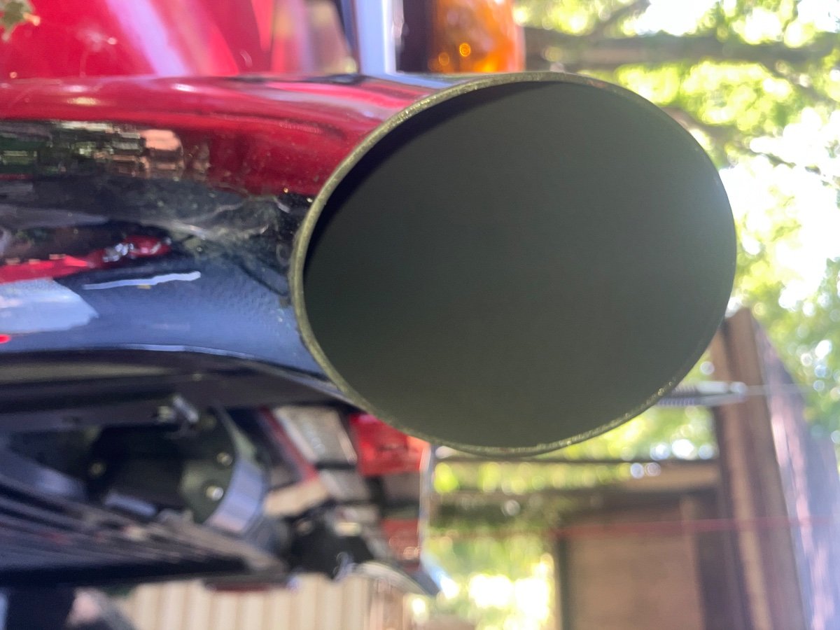

Oh wise ones, I need some help, some wisdom.
That 97 4.0 has been running like a top ever since I got it. 300,000 miles, one owner, extremely well maintained, now 320, and I didn’t think to tune it up until I had a miss coming back from Ford nationals in June. Actually, I couldn’t really feel a miss, but I feel like I had a slight loss of power. It’s still runs very strong, but doesn’t seem to run as strong as before, but it might be in my mind.
When I got home, the left exhaust pipe was full of soot, and there was soot on the rear fenders on the left side. A lot.
When I pulled the plugs, the driver side front spark plug was actually loose, it was still in the threads, but it was loose enough to wiggle it and remove it with my fingers. When I pulled it out, it was covered with soot. I put the new spark plug in, and it tightened down like normal. I don’t remember ever having a loose plug in the last zillion miles on any of the dozens or hundreds of vehicles….
I put in new plugs and wires. I haven’t put in an I haven’t put in an PCV valve yet, but I find it hard to believe that would be the problem. After driving it a couple hundred miles at highway speeds and temps,, I still have some soot in that left pipe. Left compared to right, today.
Last week, I ran the gas tank down to less than a quarter tank, and I put in a can of seafoam. I ran it long enough to make sure it was hot and all through the system, and then I parked it for a couple days. Then, when I was almost out of gas, I filled it with premium. I don’t think that made any difference. I have a few hundred miles at 70 mile an hour at highway speeds since changing the plugs.
It seems to be hitting on all cylinders, but it still seems to have a slight lack of power. Not a dramatic lack of power, just a little from the way it was running when I got it. I can’t tell if it’s got a miss at lower RPMs, but I do still believe there’s a lack of power. I’m not sure if the miss is in my mind.
Today I pulled that spark plug, and it looked fine.
I’ve wondered off and on if it had a blown head gasket, but it just runs too well. For unrelated reasons, I took the top radiator hose off a couple times, and it always takes checking it after some miles a few times to get the radiator topped off. But I think that’s because there’s no good way to burp it, not because it is consuming radiator fluid. It was full when I checked it today after a couple hundred miles.
So here’s my need. What do I check next?
I’m going to buy the gizmo to do a compression check. It’s in the mail. Btw, it’s not using any oil I can notice.
Could I have fouled the catalytic converter on that side? That cat has less than 10,000 miles on it. I understand the science, and if I was feeding hydrocarbons into it when the spark plug was loose, once I fixed it, running at highway speeds and temps, shouldn’t it burn off the carbon off fairly quickly? Before, when I’ve had a cat that was plugged, the vehicle ran like absolute crap. It’s still running pretty good. ???
What else can I check short of pulling heads?
