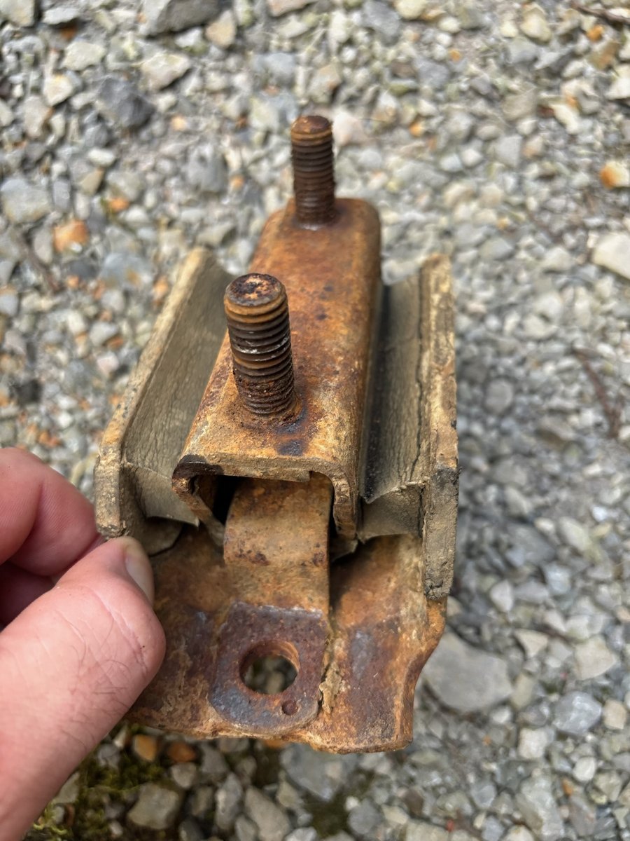

Yesterday I had the Choptop out. New trans mount didn’t fix all of my vibration issues, but it solved a lot of it. Gonna check my motor mounts and still need to make my new trans crossmember but it should now be good for highway speeds again.

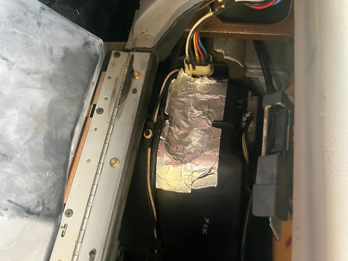

I continued to try to tweak the AC on the Road Ranger. I blew the ducts out with a leaf blower, and I was just about to pull the squirrel cage to see if the screen behind it was all plugged up, or maybe reach in and see if the AC coil was plugged up.

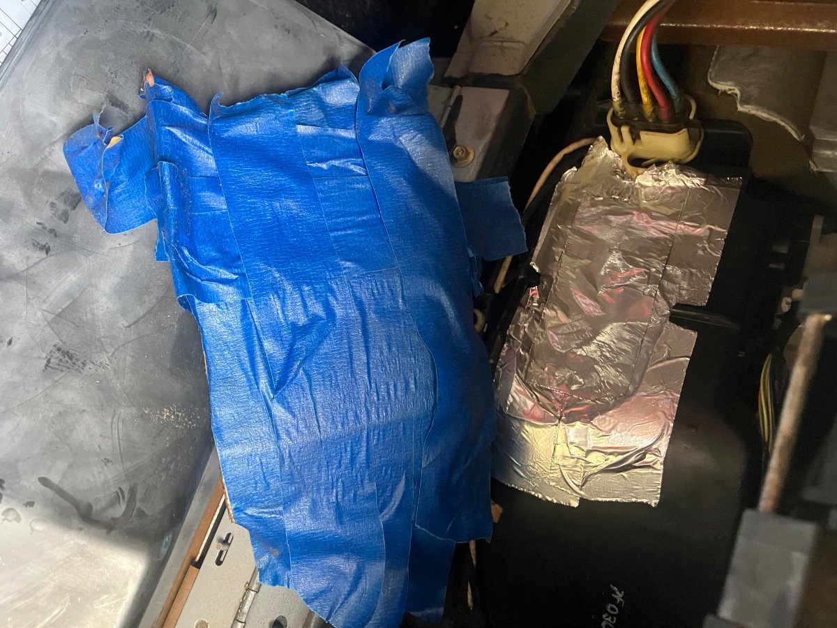

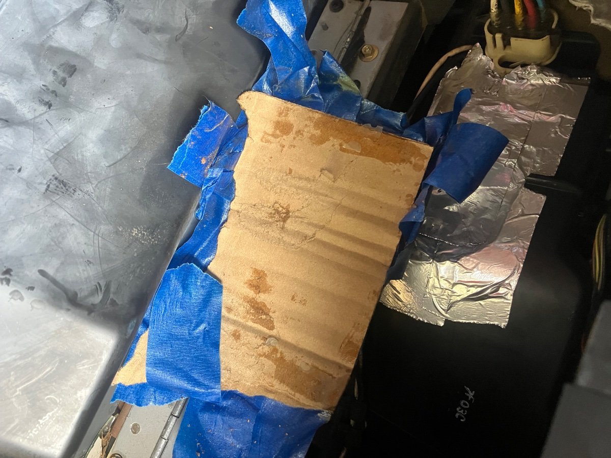

Just before I did that, I dropped the glove box down just to see what I might be able to do from that side, and I found a big surprise. Some previous owner had cut a hole in the ductwork about 5 x 8”, and then capped it off with a piece of cardboard and a bunch of blue masking tape (Blue has the same adhesion as like spit). The piece was just hanging loose. I don’t know if I blew it off with the leaf blower or if it’s just been off all along.
I cut a few pieces of the aluminum HVAC duct seal tape after cleaning the surface of the box and put that on. Now I’ve got twice the amount of air coming out of the dashboard. I guess the problem is solved..

Assuming you don't want to find a replacement, perhaps some aluminum flashing, RTV, and some pop rivets might make for a better long term solution. But what you did will work for now.
