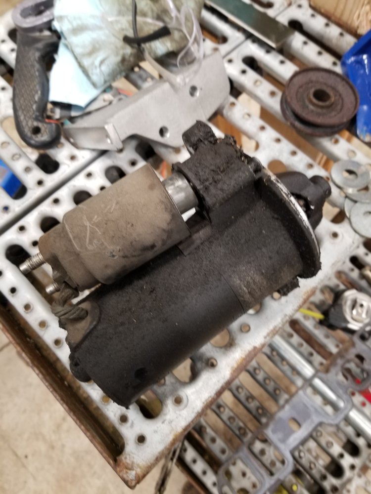

What in the heck kind of Mopar wiring jackassery is up with the starter system in a '97? Oddly enough I think the starter is original on this thing, it's a Motorcraft with an F1 part number...
I've replaced plenty of alternators in different vehicles over the years, but (knock on wood) never had to replace a starter. Some vehicles are prone to going through starters. Most aren't.

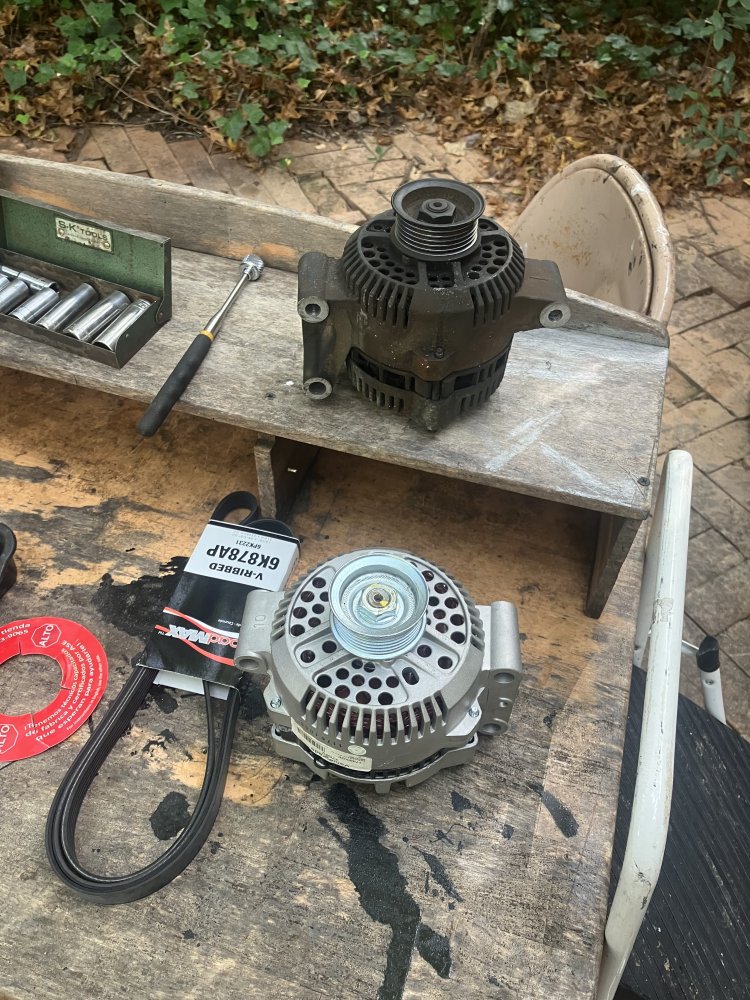

Alternator, tensioner and belt changed. Again, I went with the 130 amp. We’ll see.

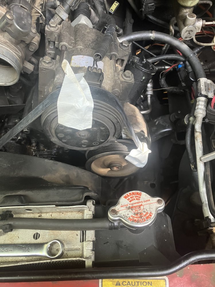

And a little tip for those who might not do something like this: six or 9 inches of duct tape can save five hours when trying to put the serpentine belt on when it’s bent in all the wrong directions from the packaging

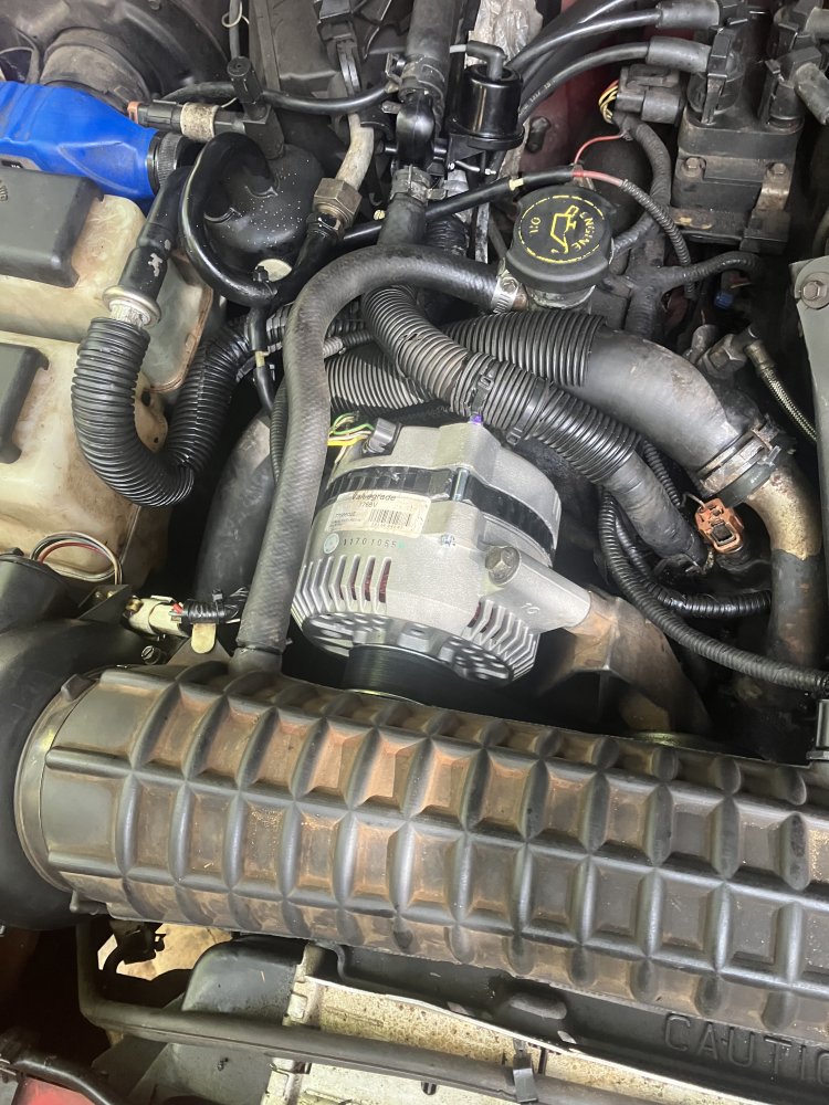

And this is what we have now.
And a “howcum” for the group. Howcum no matter where you are working on the vehicle, I mean, if you were pulling the license plate bolt in the rear, it always falls inside the fan shroud? That probably added 20 or 30 minutes to the job, but it’s done, no red light and the gauge is reading half again higher. Woohoo

The new belt was kinked pretty good. Every time I tried to slip it on something on the left, the right would fall off, etc. I’ve had that before with serpentine belts, so usually when I go to put one on, I just start out bringing the masking tape or duct tape to hold it on while I’m tugging at the other end. Again, old fart factor, I forgot to do it this time for the first however long.
