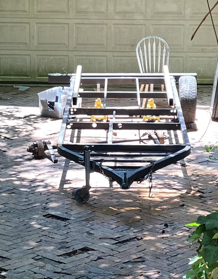

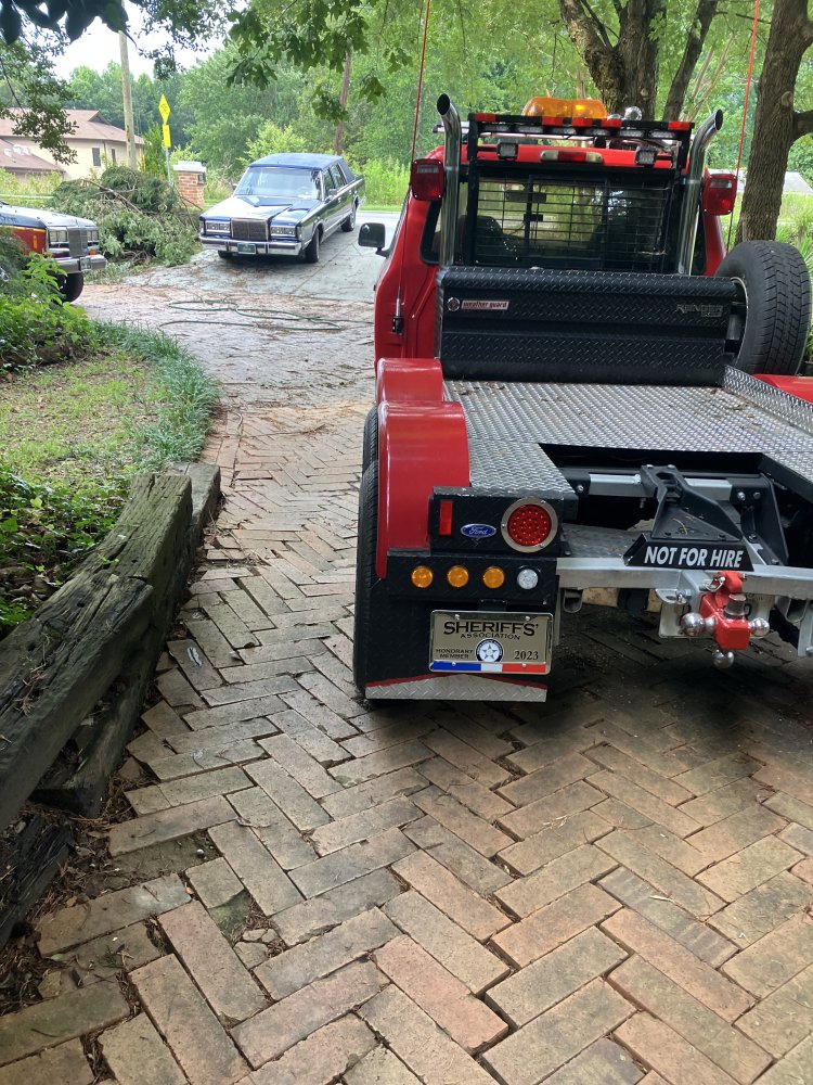

My parking brake has been pretty useless for a while, so I ordered new right and left cables since the old ones were original and in pretty bad shape. As soon as I pulled the wheels I realized my axle seal bearing repair kit had not repaired anything and I am again looking at leaking axle seals. Sigh. Here we go again.
Soooo, between the 95° heat and then the hurricane level thunderstorms every day, normal for Georgia, I finally got the Road Ranger’s trailer pulled over where I can work on it. Before pics:
I shelled out $250 for this trailer, and just by eyeball, it was just about the right size for what I wanted to do, and, of course it had the steel and the brake axle. I was hoping I wouldn’t have to do too much modification.
Before I dropped the axle, I put a Ranger wheel on it, and I was very happy that it cleared the frame by about an inch.
I dropped the axle, and then from the front original axle mound back towards the back bumper, I cut everything off that was hanging below the frame. Again, my plan is to build a truck (like a railroad car), with a double brake axle that will rest under this frame. And of course I want the width of the trailer and the track of the tires to match the Road Ranger.
Well, Murphy’s Law, although the Ranger wheels will clear the frame as it is, the frame is about 7 inches wider than what I’m going to need for the tractor. Here’s pics of my white truck pieces at the right width sitting on top of the camper frame. For the tires to be the right width to match the truck, they would go right through the existing trailer frame:
So I guess I’m going to build the truck at the right width, with the springs and axles, ready to slide under this frame. It looks like I’ve got to narrow about 5 feet of the tail end.
Maybe the good news is that I thought I was going to have to step up the flatbed where it goes over the “fifth wheel.” I haven’t measured it out yet, but I believe I may be able to just use the frame as it is as far as elevation. When I put the double axles under the back, I want the tires completely underneath the bed, but I have to allow 3 or 4 inches of vértice travel for spring compression.
I think I’m going to take the rest of the 4th and drink a little non-Bud Light beer and figure it all out…

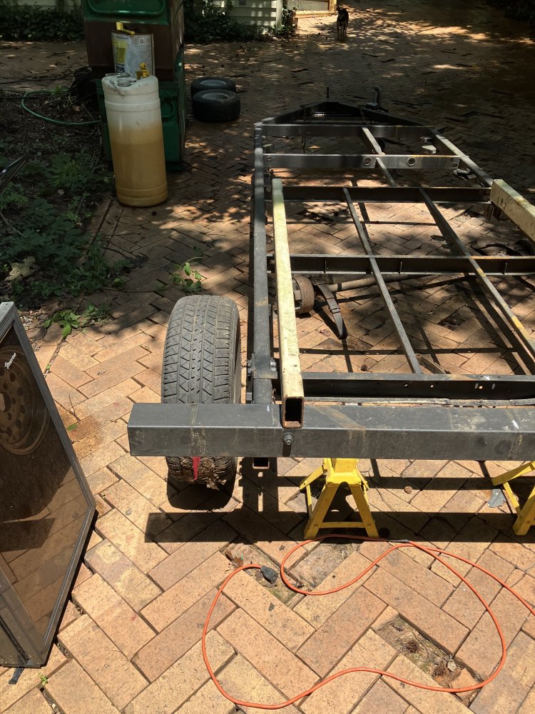

View attachment 94653View attachment 94654
View attachment 94655View attachment 94656

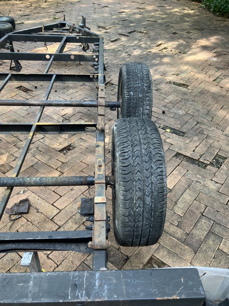

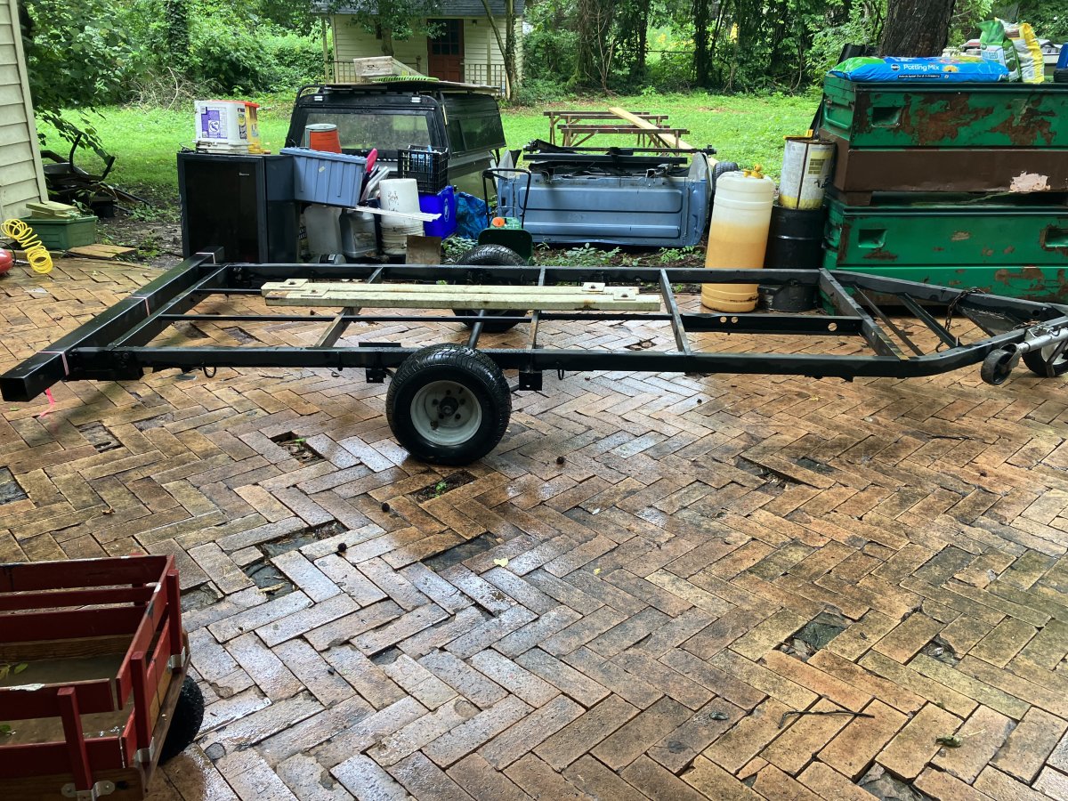

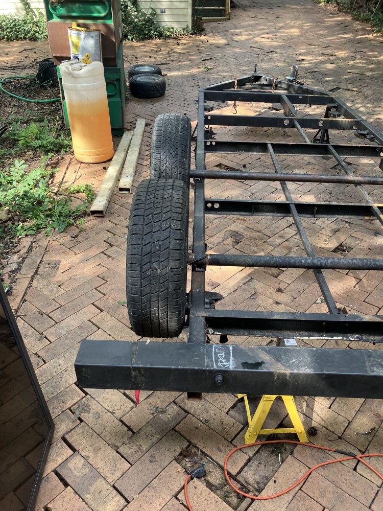

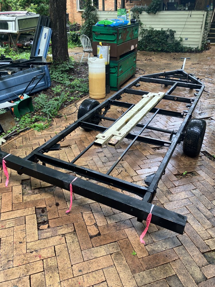

I bought this trailer and the 15 or 20 14” Ranger bullet hole wheels and axles, etc. 2 or 3 years ago. While I hadn’t even started, no less finished, the Road Ranger tractor at that time, I remember doing all the math in my head (therein lies the problem), so I wouldn’t have to modify this trailer. Remember that 3-4 times a week I arrive in my kitchen and I can’t even remember why I came down from the bedroom
When I did the mock up this afternoon, I was using a 15”, 235/75/15 spare tire from the semi. I had completely forgotten that I had accumulated all of these 14 inch wheels, most of which have 185/65/14 tires on them, which are about the same width as the rim. Truck tires are 15 inch and wider.
Soooo, I went back out to the tire pile next to the shed of miracles, and I dug some of these things out, and then I redid the mock up. With the 14s, and the 185/65/14’s, I can keep the trailer frame width as is, and I end up at exactly 70 inches to the outside of the tires, which is exactly the same as the Road Ranger.
The truck’s tires stick out about an inch outside the fenders. So I’m going to rethink the trailer, so the trailer tires do the same thing. I will still keep the tires underneath the deck of the trailer. This puts me back to probably stepping up the deck, quasi goose neck, so the deck rides level when it’s attached to the fifth wheel.
My underlying point is that I really did think this out very well, then I forgot it all, but that was a few years ago, and I forgot that I was smart back then. Something like that.
And yes, I have to cut out about 3 inches from the forward axle so it mirrors the rear axle. Project for another day. Second set of brakes later too.
