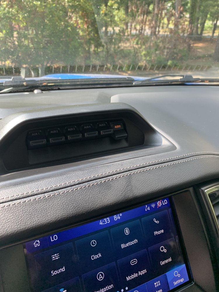

Today I finally got to use 1 of my upfitter switches.

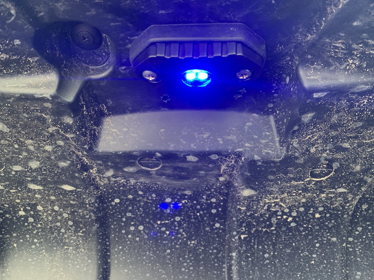

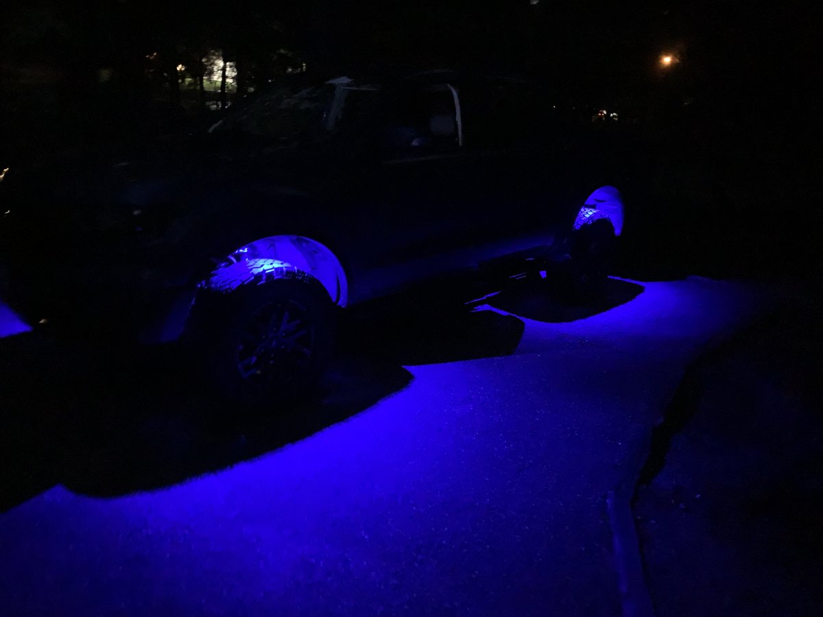

I installed a set of rock lights. I had a spare kit sitting around that was supposed to go on one of SxSs, but never installed. They’re RGB lights with an app on my phone to control the colors. (I only took pics with it set to blue.)

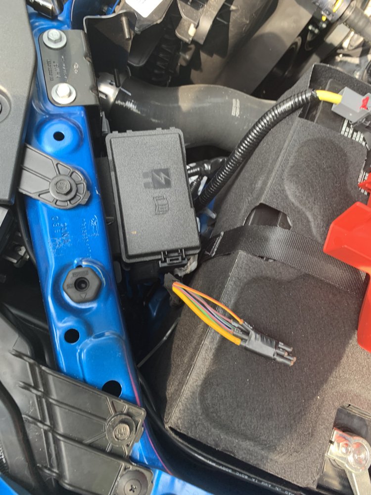

Here’s a pic of the relay box location for the upfitter switches, in case anyone is interested.

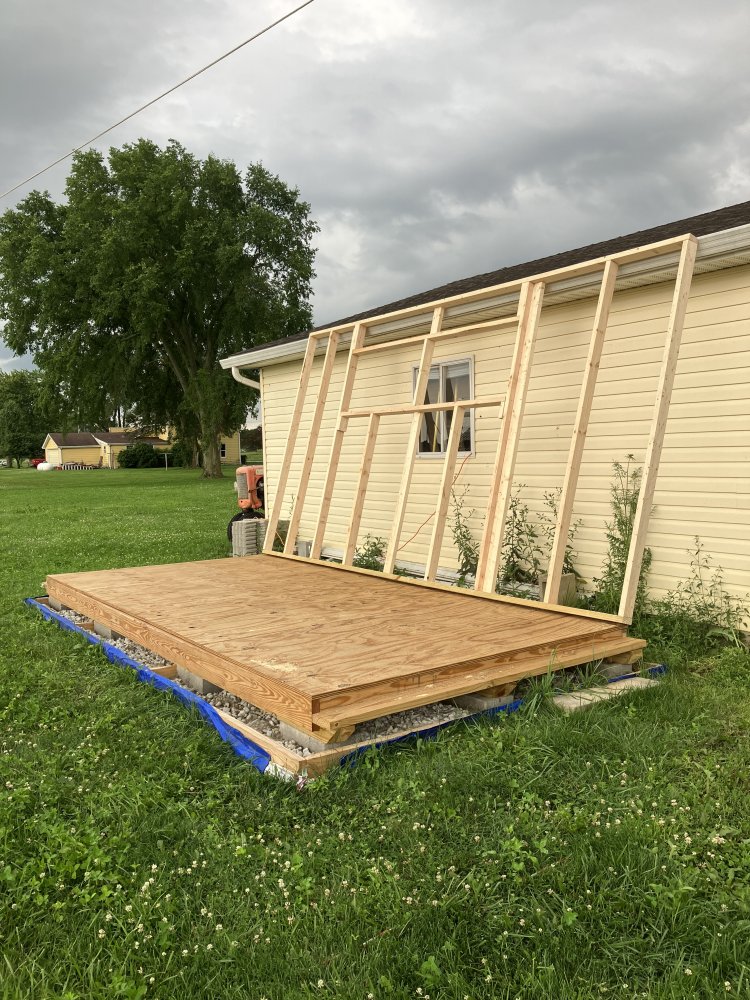

I worked on the chicken house some, tossed some of the 16’ 2x4’s from the trailer in the garage into the ranger then backed it up to my work site. Got 1 wall almost completely framed before it decided to start raining again. Its just as well, in 3 hours the back of my shirt was completely soaked and I feel very drained. Put my tools and hardware up and hit the shower. I really cant handle the humidity like I used to. Small steps I guess.
