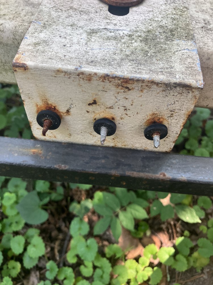

Here’s a better pic of my rectangular tube mounts. Self tapping screws with a rubber washer between the bracket and whatever it screwed into. That makes me think it’s part of a metal building. There’s virtually no damage to the powder coating, it’s just dirty.
It’s no big deal, but I am curious what these things used to do. It all adds to the mystique of the Road Ranger!

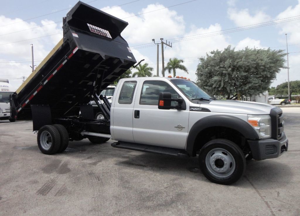

Soooo, I’ve known several Masons over the years, but I didn’t realize they needed such heavy duty hardware to relieve themselves.
Call Or is it a different kind of mason dump?
Other mason dump:
