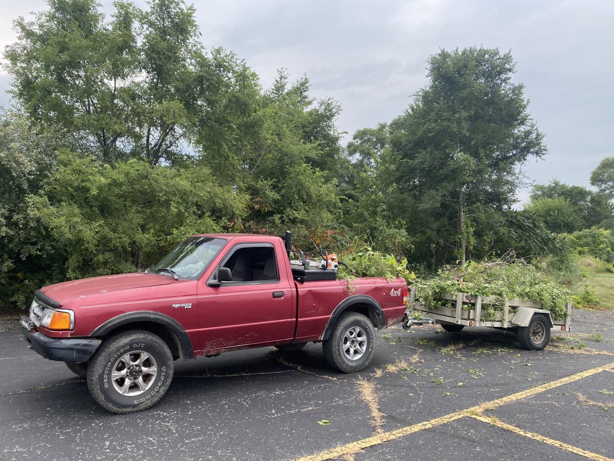

Should be fine. Indiana is flat AF but i was probably in that neighborhood with this load.
Upgrading 1995 Ranger's 2.3 Lime Radiator/Cooling System
temp didnt come up higher than normal.
