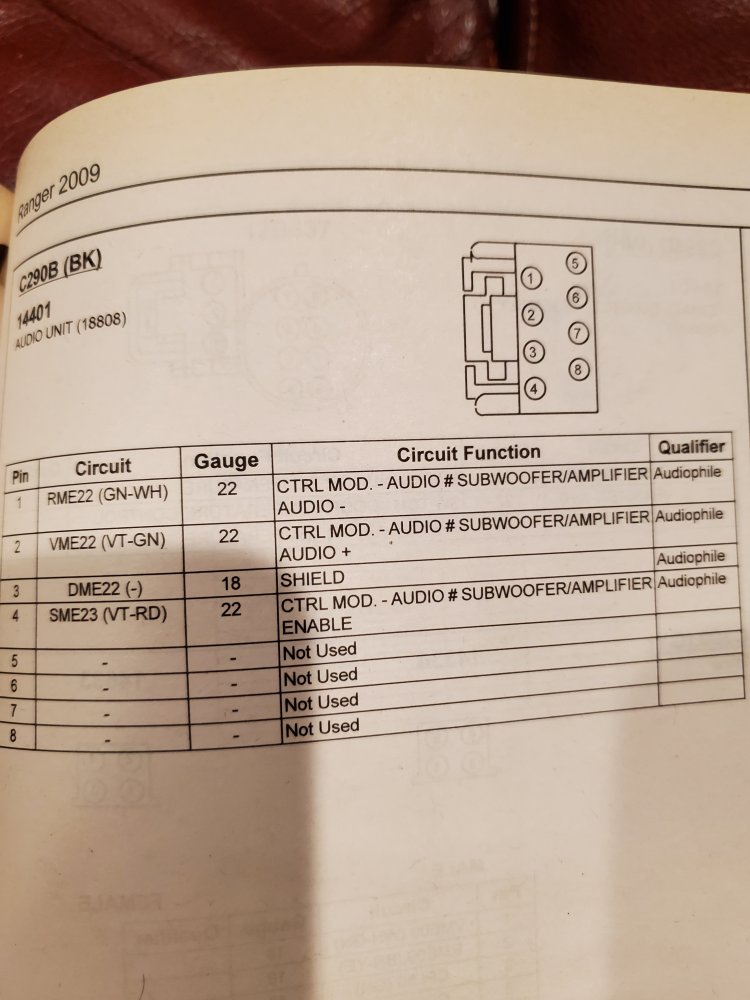

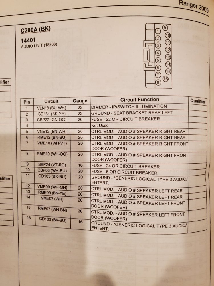

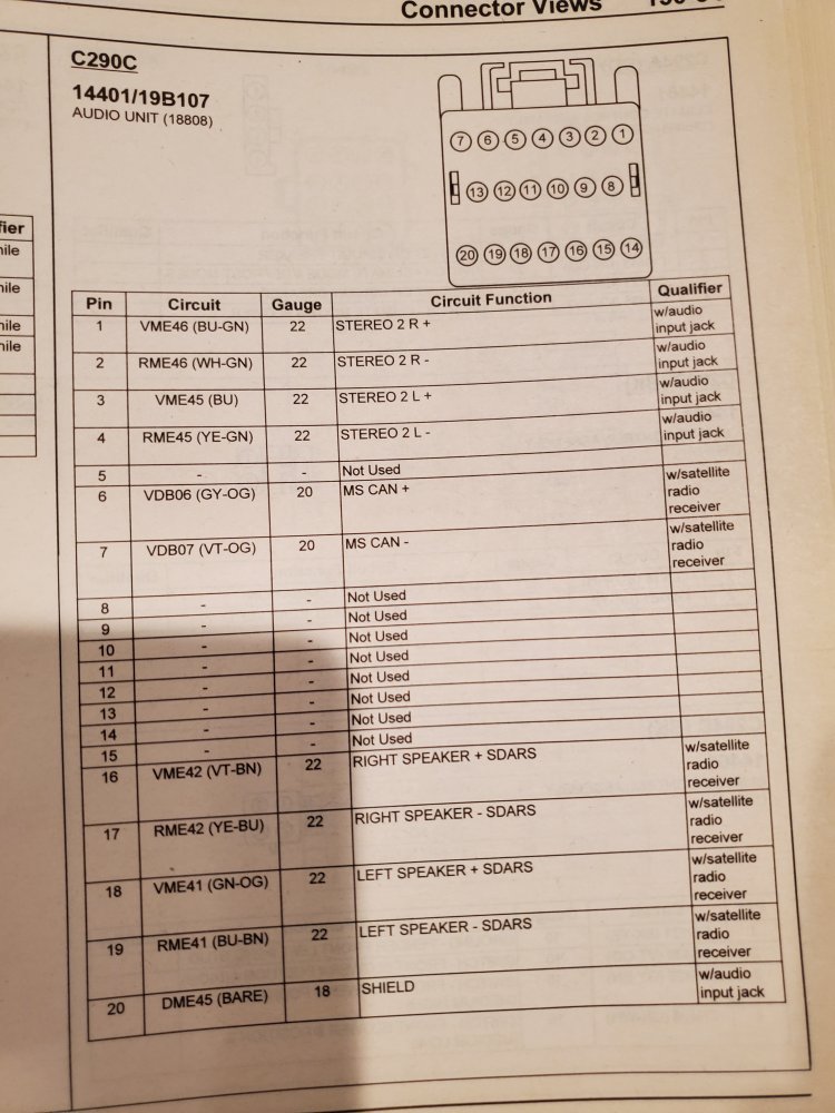

Here are the connector views. C290B is unique to the Pioneer stereo and supplies power, ground, and signal to the sub amp. iirc, that is the one that I had to re-pin to get the wires in the right place.

Rubydist- Thank you for looking that up for me. I do recall seeing that (I think) when I was going through my service manual awhile ago.
