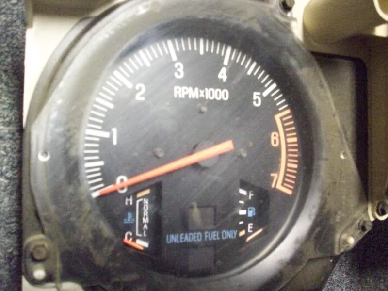

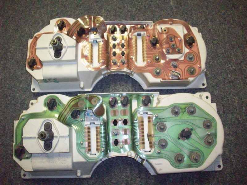

I was at U-pull it and stumbled apoun a factory tach cluster in a '88 Ranger. Looked like new, so I grabbed it and took a $25 gamble.
My truck is wired kinda wierd, most of the harnesses in the cab are a E8 part number, and it took a '88 light switch... so I think most if not all of the cab wiring is out of a later truck and it all points to being the same year as the truck I pulled the tach out of.
I think I have seen threads about installing them, and converting them to work with a V8... but of course I can't find anything diffinative about it now that I have one. It has a aftermarket tach right now, so if I have to run another wire it is already ran. Worst case, I did grab the connectors out of the truck since it is kind of a PITA to get there after I find another one.
And is there a way to either switch the tach to my cluster or put my speedo on the other cluster so the odometer still is still right?
I will make this an educational bump.

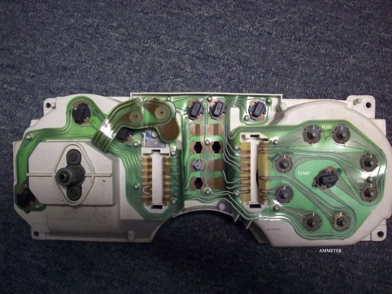

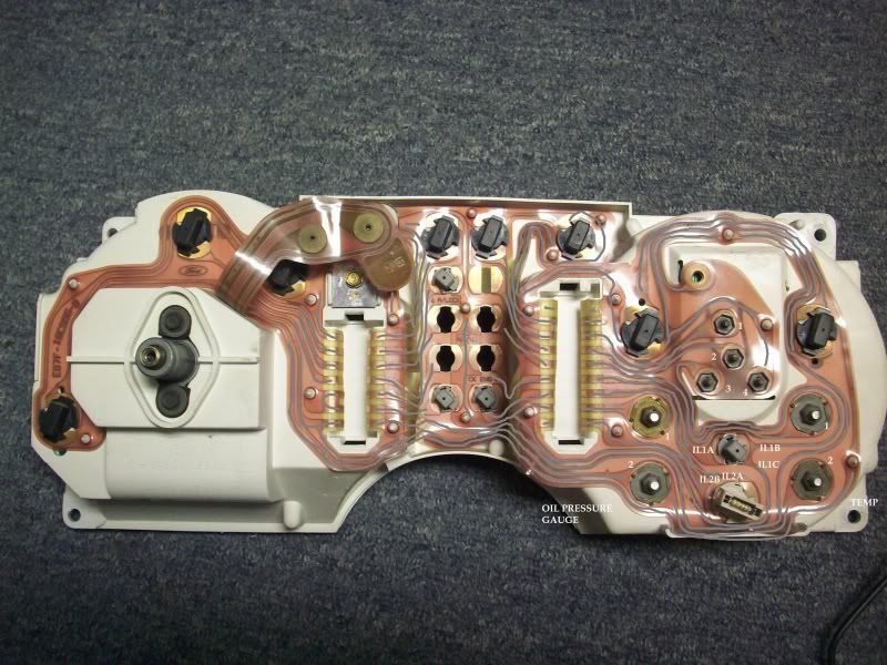

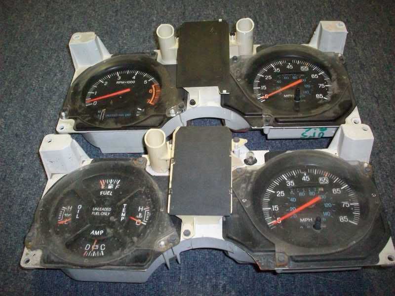

Comparing with the '86 non-tach cluster out of my parts truck.

there was a shop in detroit that set them up. the later models are v8 settable factory...just move the wire
i cant remember the resistor type part to use for v8 with the gen 1 clusters. its was a radioshack thing, you run the signal to the 4cyl side with the part and it read pretty close.
I just found this, sound familiar?
The stock Tachometer will work if you don't mind it being off a little bit and not being linier. You'll have to jump a wire on back of the Tach between L2 and GRD post.
http://sleepinranger.com/misc/misc.htm
Close enough for me if it really works.

And how about getting it to work in a non-tach truck?

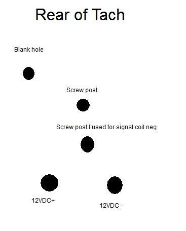

Can someone please tell me where "L2" is at????? I just installed the 88 cluster in my 331 ranger and as everyone knows, the tach is way off. I am wire to 12VDC + DC - and Coil Neg.
Please see attachmet for how I have mine wired.
  • Factory tach upgrade... with a V8
Figured it out
What did you do?
Also, did you swap dash harnesses or repin the factory connector?
Here is what I did. It is not 100% accurate meaning not linear but is close. I ran new individual wires from the back post on the tach to the coil, accessory positive and ground. Did not have to re-pin the left plug at all. Did re-pin the right pin for the gas and temp gauge.

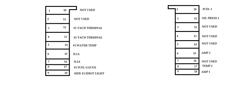

I haven't gotten around to completing the pinouts, but I have quite a bit of it done. There are quite a few things mixed around on the tach side connector. My plan was to just feed the required signals in through the factory connector.

Not quite done yet, I got part of the way into it and decided it would make a good winter project.
