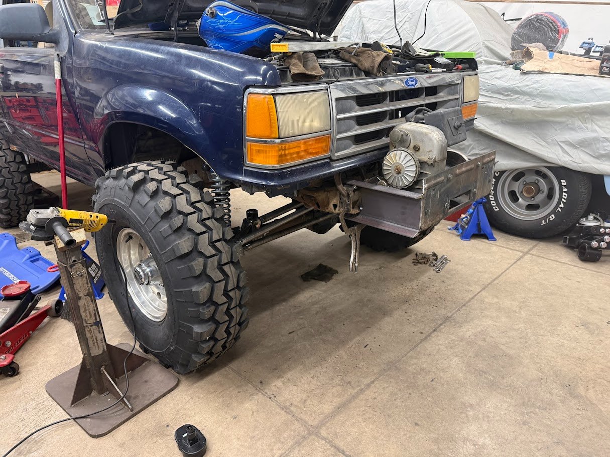

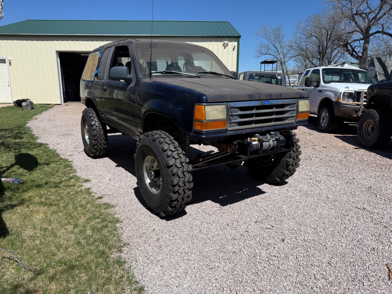

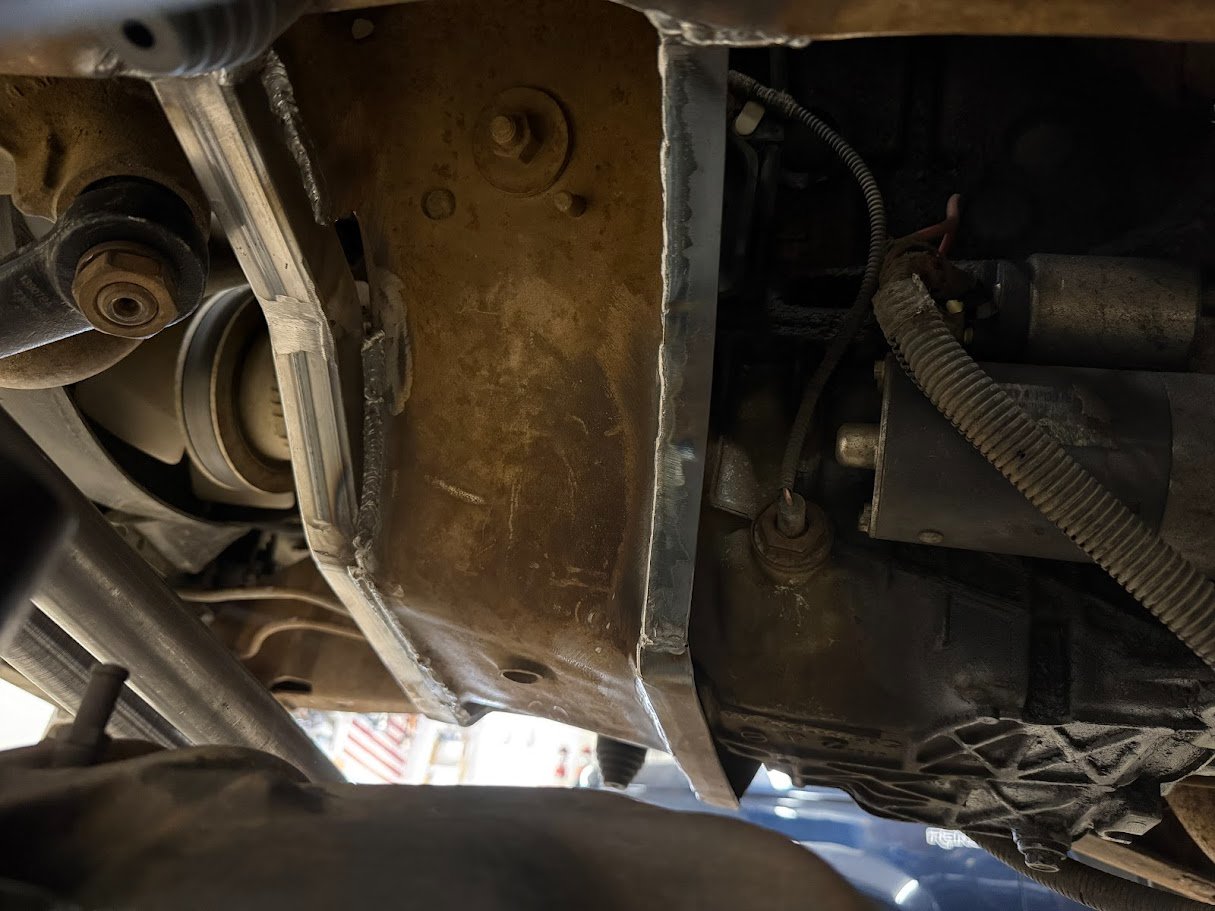

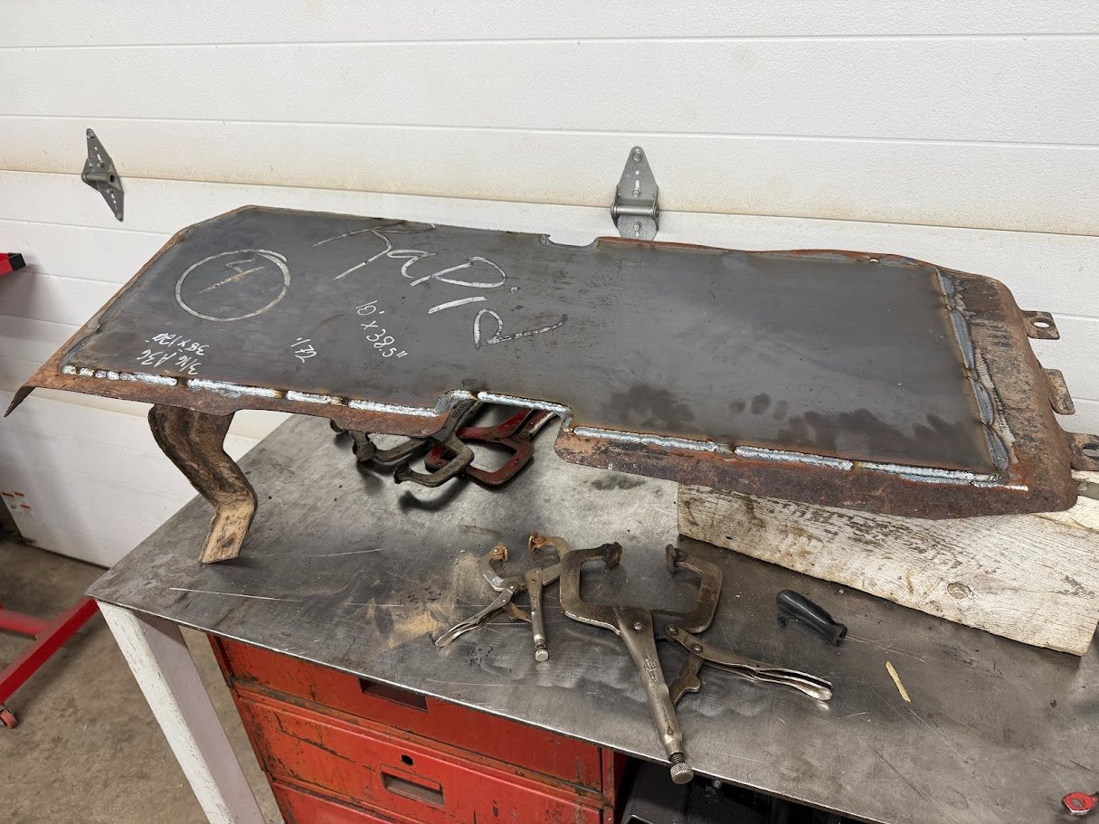

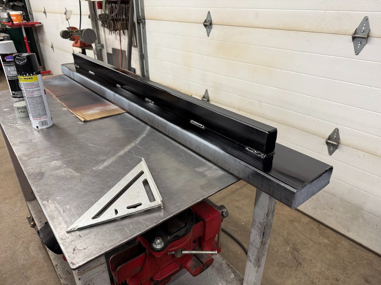

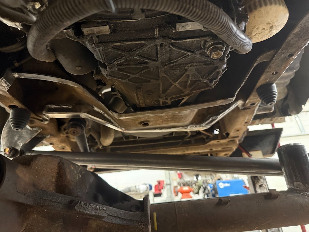

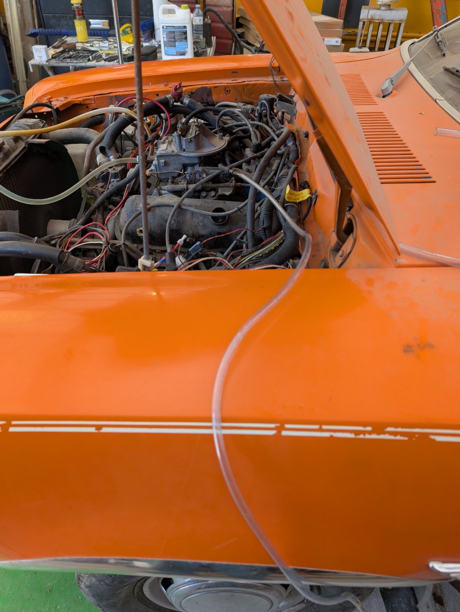

I wire wheeled as much as I could yesterday and am calling it good. Not going to paint anything. Also finished up the engine crossmember. I just used a couple pieces of flat strap on the back side. I might revisit that in the future if & when I have the engine out and more room to see what I'm welding.

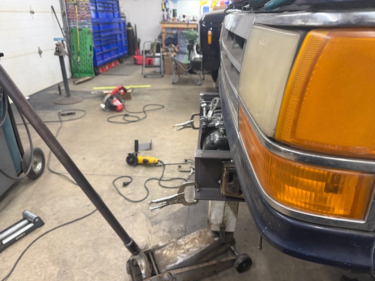

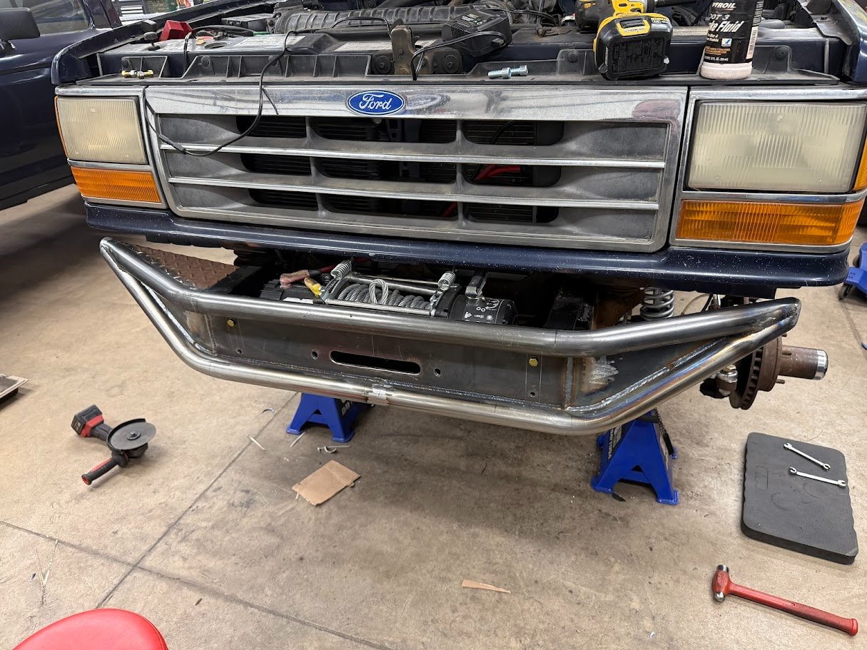

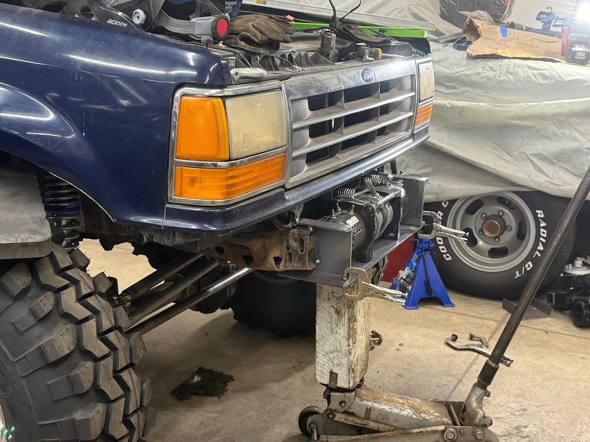

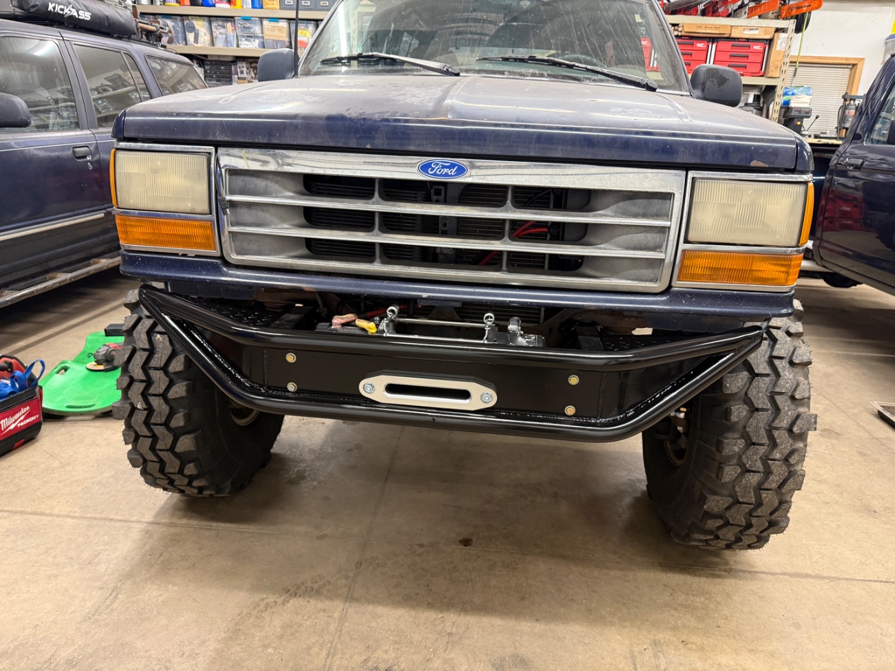

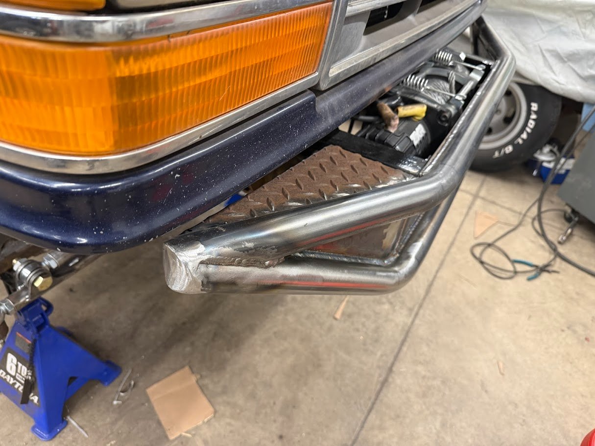

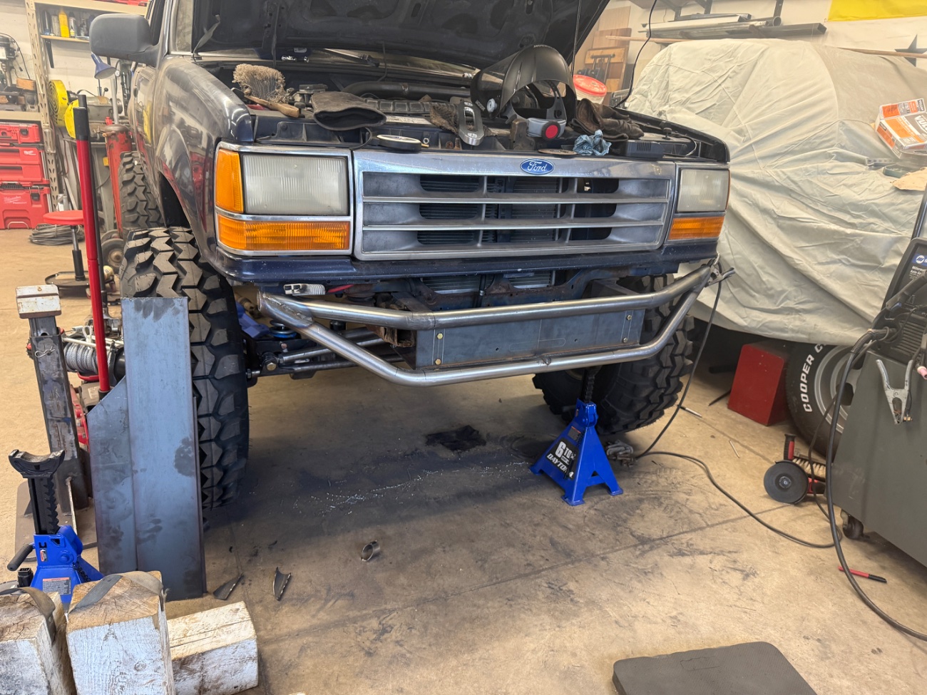

Axle is back under the truck and I am waiting on an email from AccuTune to tell me what springs I need. I have a long list of little things to work on this week. I really want to work on the front bumper and get the winch mounted.
