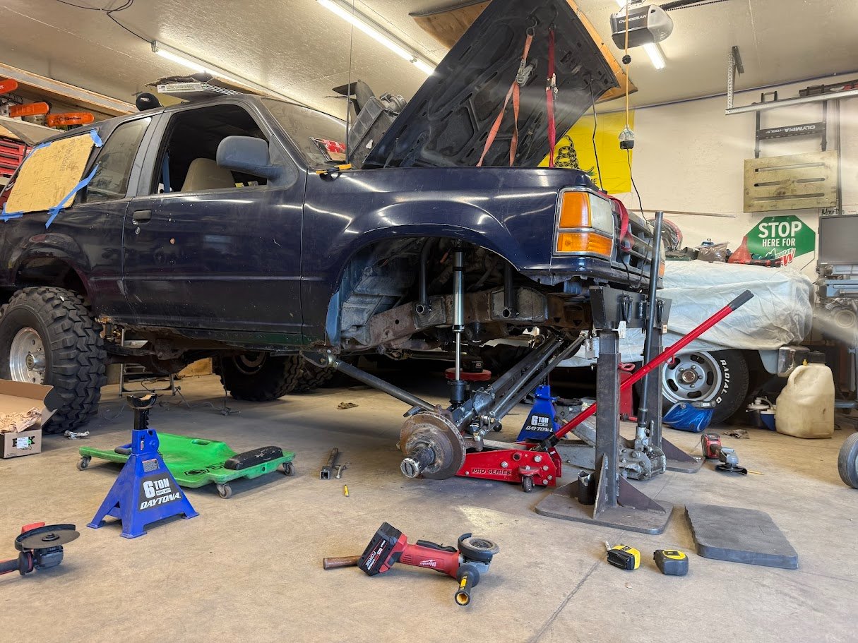

Here are a lot more of the same familiar images but with the addition of almost a full 10lb spool of welding wire.

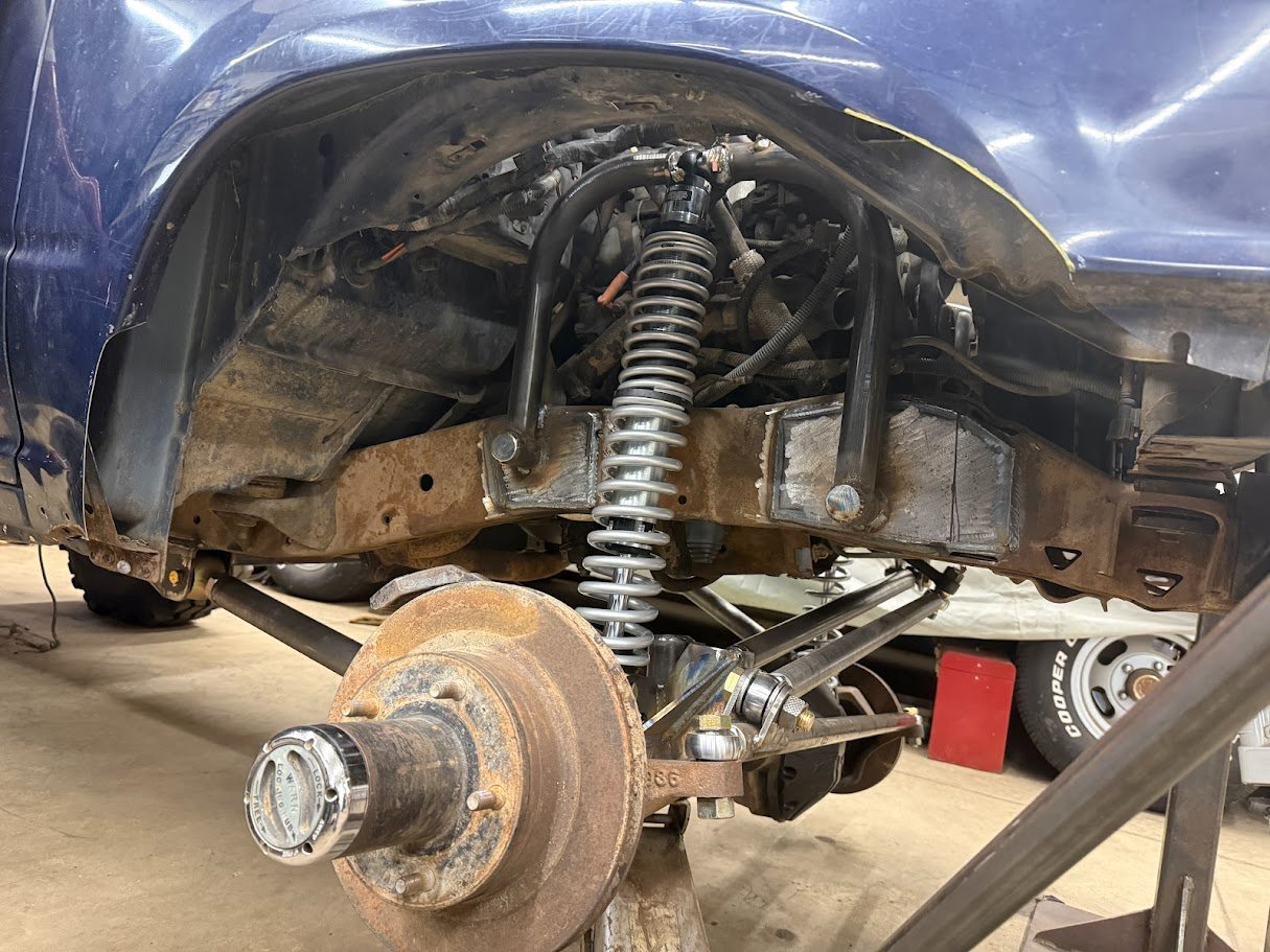

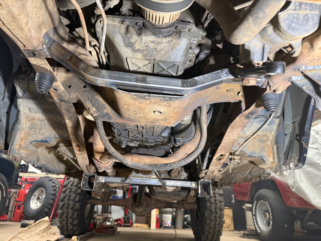

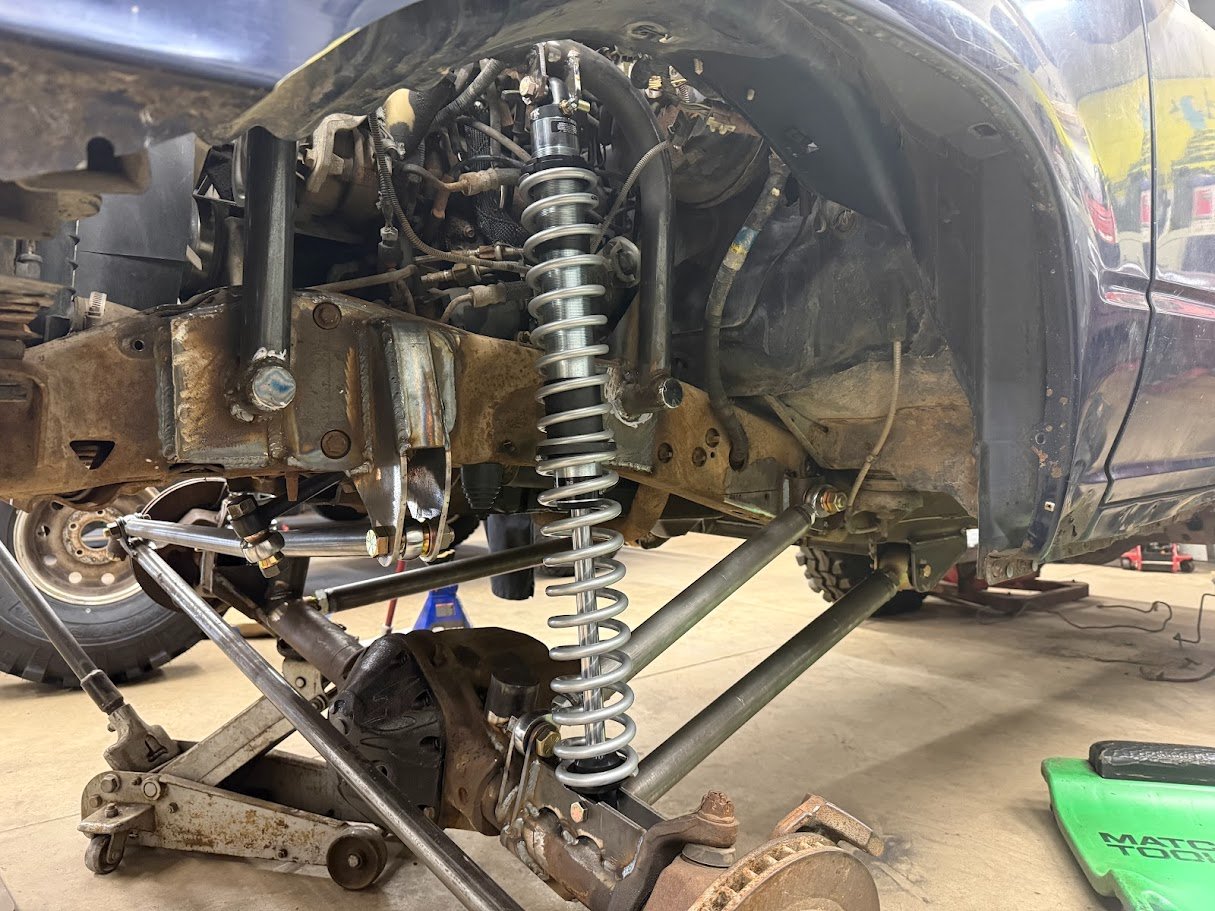

My buddy came over again on Saturday and we got the passenger side shock hoop tacked in. I had cut out some lower tabs so we tacked those in as well and were able to put both shocks in (minus springs) and cycle the suspension fully with the shocks in place. Aside from some minor weirdness with tab angles and hoop locations, everything seems to be very happy. I have just a hair of clearance with the battery box and brake master cylinder. Will for sure need to run a cone air filter.
I spent most of Sunday welding. I am probably 80% done and I don't need to build anything else except some flat pieces to box the frame around the lower mounts, tube caps, and a cross over tube that will go over the engine and stiffen the shock hoops. Hoping to have all of that done by the end of next weekend.
After that I need to remove the axle, finish welding a couple spots that I can't get to, wire wheel off all the dingle berries, and then start reinforcing the engine crossmember that is a lot smaller than it used to be. After that I can put the axle back in and work on front brakes.

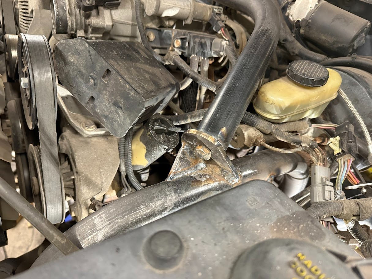

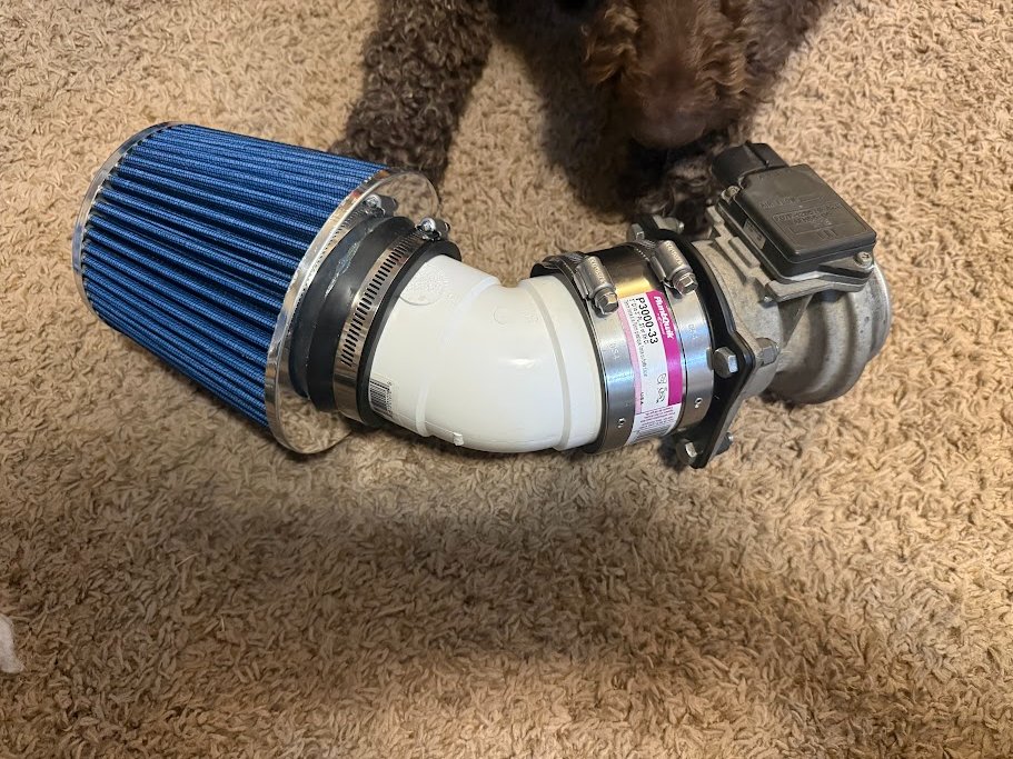

Air filter deal is figured out I think. AutoZone & O'Reilly were useless for having the right fittings. Menard's sewer pipe section came through for me - 60 degree elbow and a rubber boot gave me the angle I needed to clear the fuse box.
Ultra cheap offroad race Explorer turned rock crawler
Looks good. Just be aware that heat, UV and PVC don't play nice together in the long term. That's an easy enough spot to change it every couple years though. And you know the part is available anywhere.

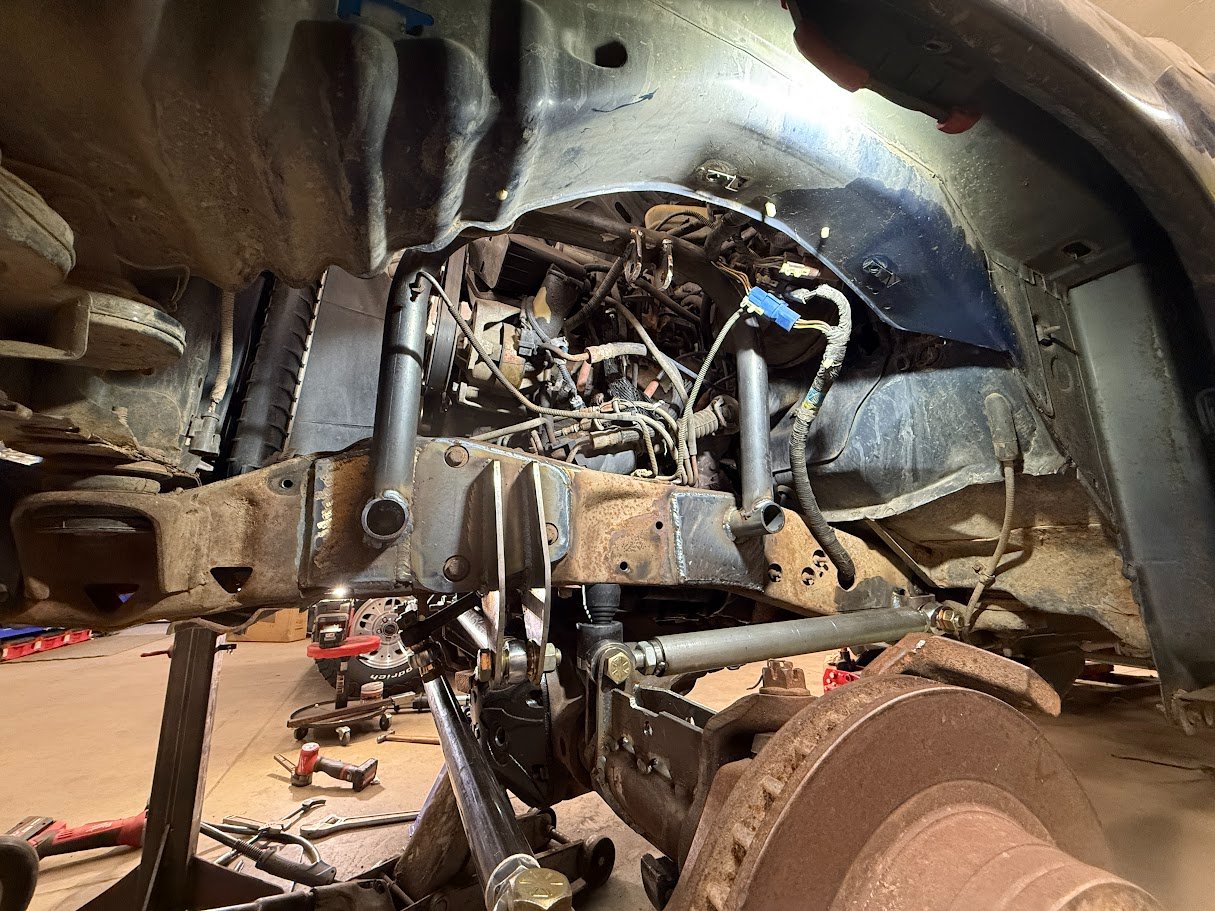

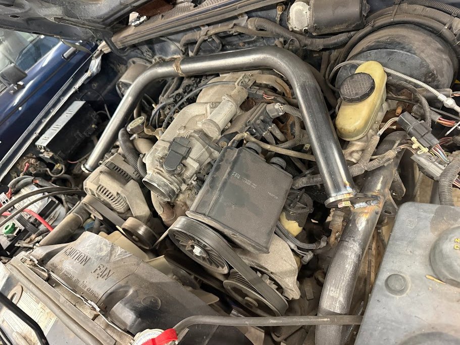

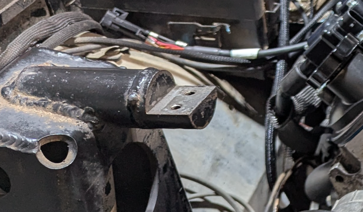

95% of the welding is done now and we got the engine cross over hoop built this weekend. I need to built a couple gussets for the tabs on that and a couple other very small things.

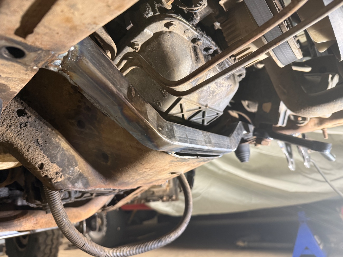

No notcher for the tube? Angle would be a bit of a pain, but then you could plate the outside if you wanted added strength

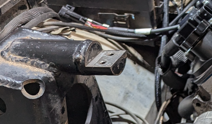

I wanted it removeable for when I pull the engine - or even for replacing an injector or something like that, no room to get the intake off.

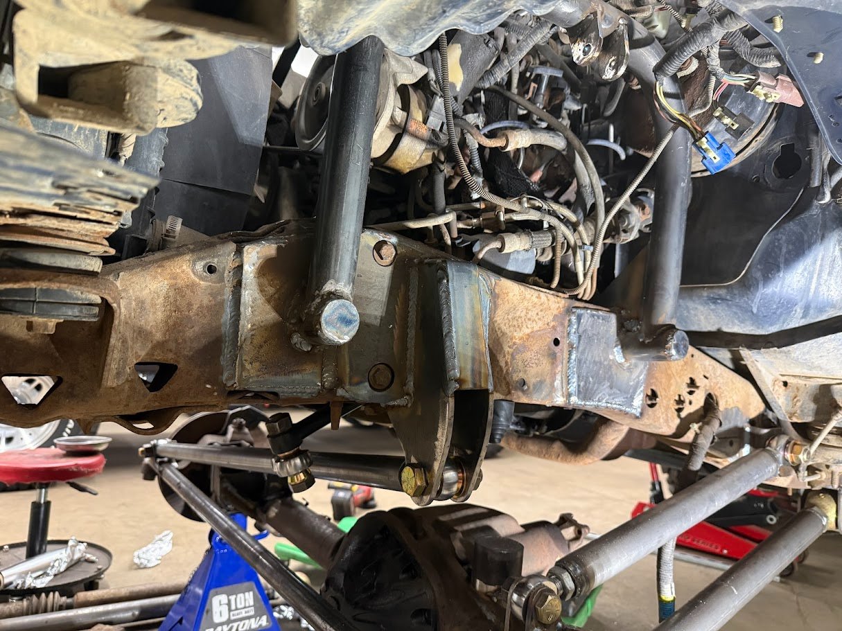

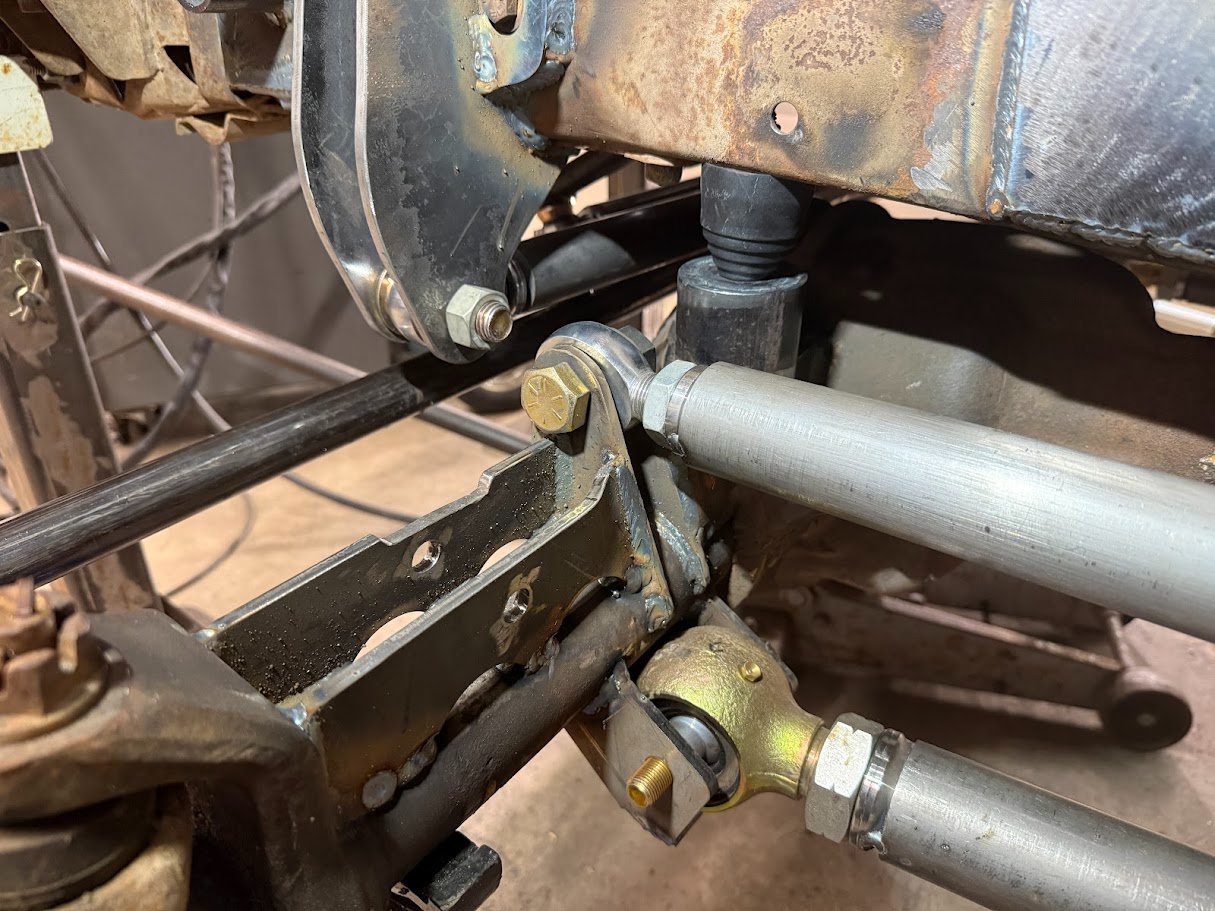

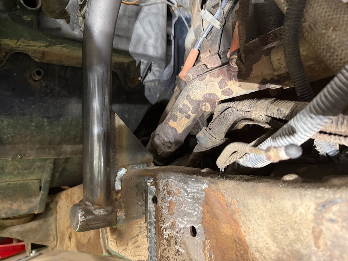

I added some gussets on the tabs last night and also capped the kicker tubes, added gussets to the frame off the shock hoops, and filled in the middle of the track bar mount. Couple little things left to weld and a lot on the frame itself once the axle is out but we're getting there.
Kinda screwed up, I unbolted one side of the cross over tube just to see how easy it comes out and then forgot to bolt it back when I welded in the shock hoop gussets. Everything moved about 1/4" overall and now it's really hard to get both bolts threaded in. I had to hog out the hole in the tube a lot. Should have had that bolted in tight to brace everything... kinda mad at myself about that. I might cut the tab off the driver's side and redo it or it's gonna bug me.

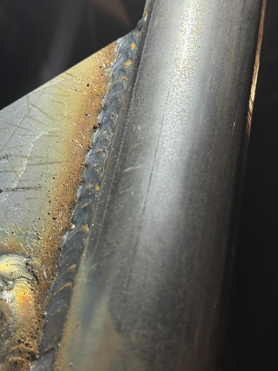

This welding wire I am using sucks by the way. Usually I use some cheap .030 US Forge wire from Menards but I got this roll of ESAB wire really cheap on clearance at Northern Tool. It spatters almost as bad as flux core, doesn't feed very well and is just dirty as hell.

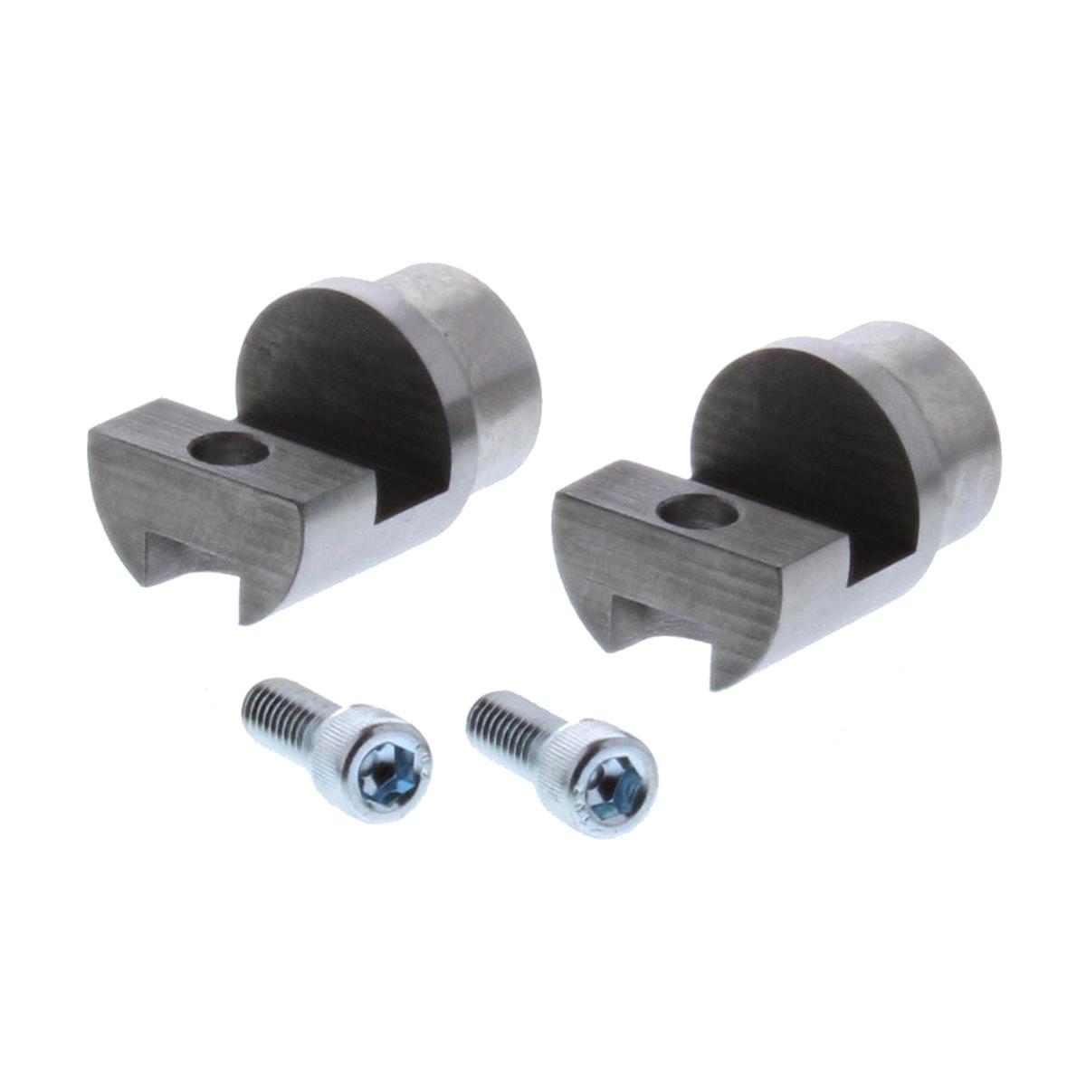

This is what I have on my strut brace, well a similar product at least
I thought about those and opted for a tab and bolt setup instead because my buddy used those on his build and they were very hard to take apart and impossible to reassemble after the truck had some miles on it. Something got tweaked or bent just a little. I think they can work pretty well if a guy knows exactly how to brace them... and I'm not that guy... lol

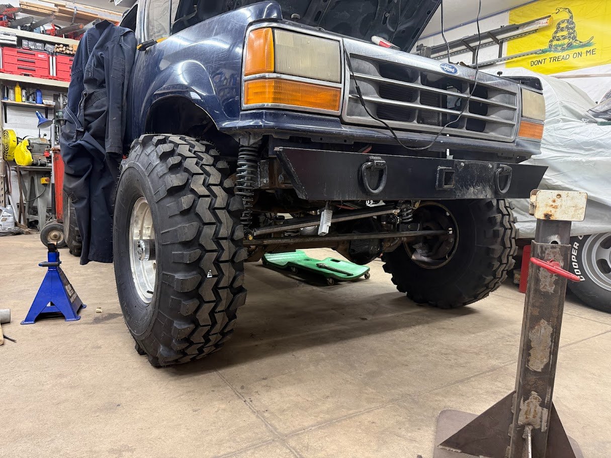

One HUGE step forward last night... one that will be undone right away...but highly motivating in any case! I put the shocks in with springs on them to see where the ride height sits and it's currently not on jack stands for the first time in two years. If I put gas in it, bled the rear brakes, and pinched off the fronts I could move it under its own power.
I'll be disassembling everything to do more welding on the frame. It looks like I will need slightly stiffer springs. I would like at least another inch of ride height in the front, maybe two, and the preload nuts on the passenger side in particular are already down to about where Accutune told me I'd need different springs. I think the passenger side is sitting lower because I have a 100lb winch on the passenger floorboard plus the battery is on that side. No big deal, I was expecting to swap springs at least once.
