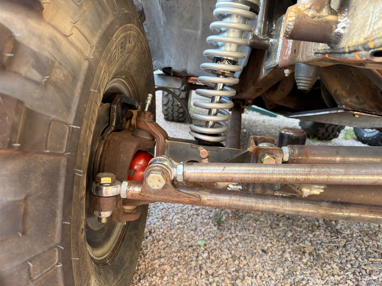

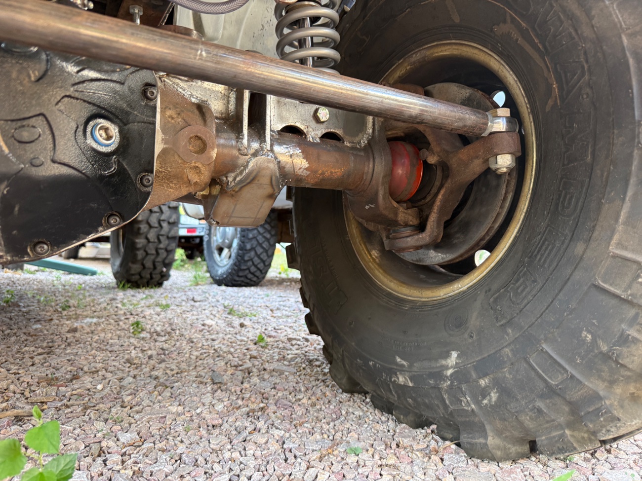

Back in action. I reassembled the front axle, cleaned it up a lot, put new seals in and spring kit for the limited slip. RCVs went right in and the new drive flanges did as well.

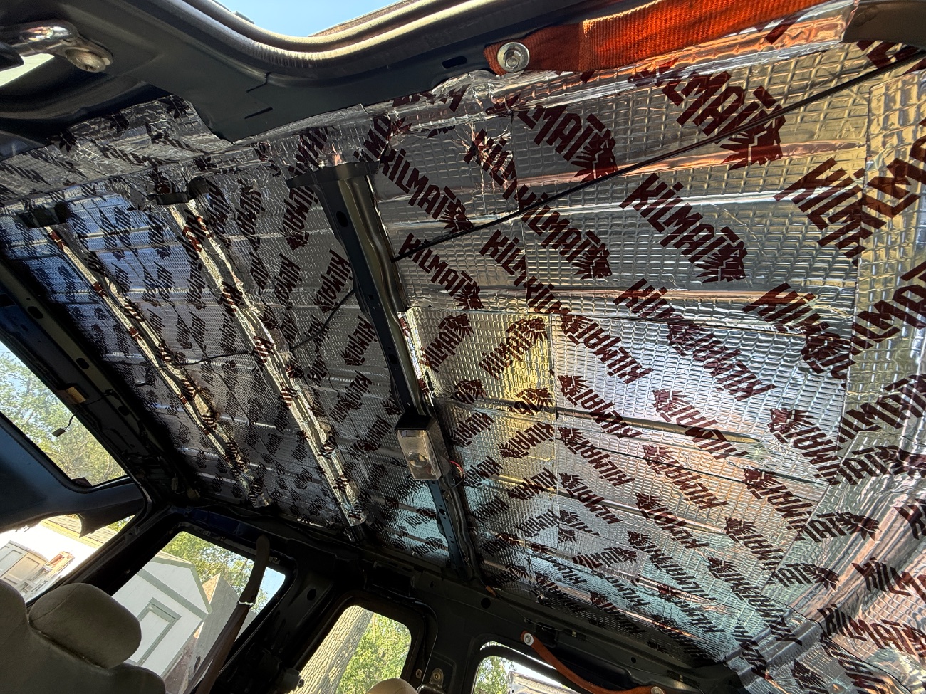

I also have been putting kilmat on the roof to hopefully cut down on the heat since I don’t have a headliner. Not sure if it’s helping much but it was worth a try, it’s like an oven in there.
