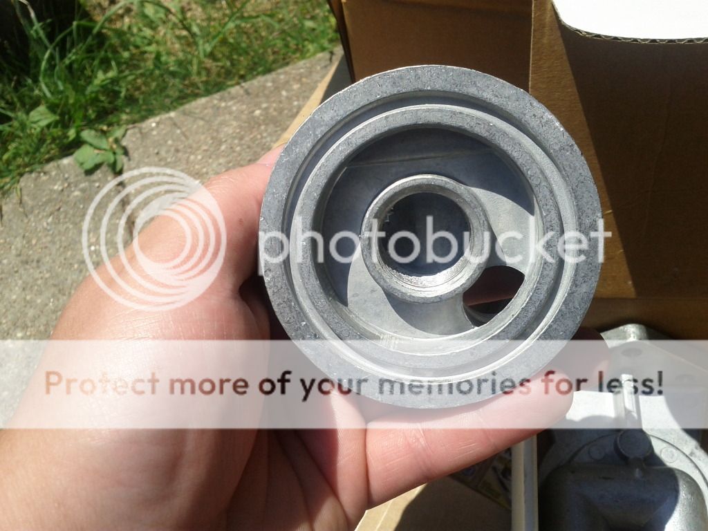

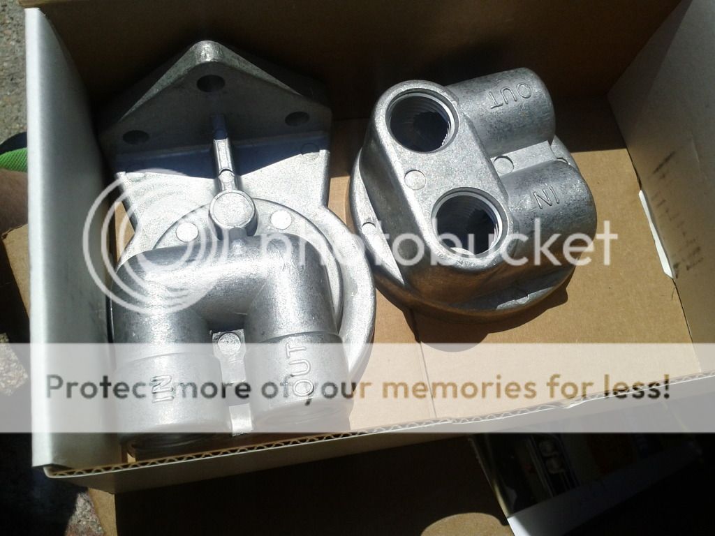

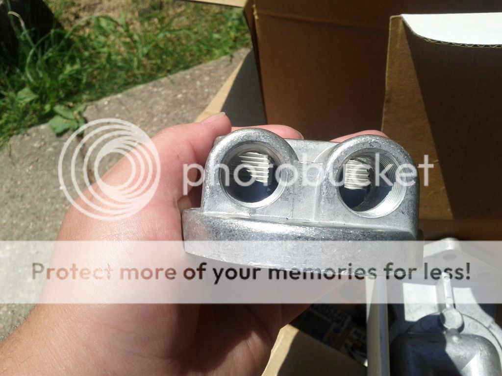

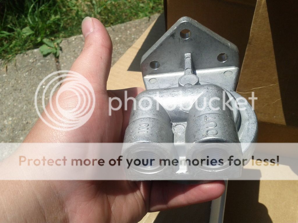

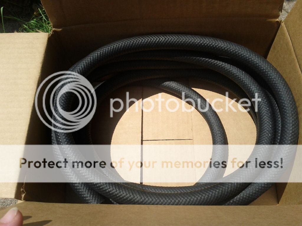

Well the oil relocation kit came today, fastest shipping I've got for free.

I absolutly love the filter mount, you have no idea how many hours I spent on Summit and Jegs trying to find one with the ports like that. :annoyed:
One word of warning on the block adaptor, that thing is thick. Watch it for clearance when you set the engine in there and for sure get the socket style plugs (they take an allen bit/wrench) Mine is pretty tight and it is quite a bit thinner, it is close enough I would try it but for sure watch it.
Yeah i am a little worried about it not fitting, it didn't look as thick in the pics as it does it real life. If it doesn't fit ill just send it back. IT also came with the plugs, there is a bag of hardware i didn't take a pic off.
If i have to order the low profile adapter, it will come out even cheaper than ordering the two trans-dapt pieces, so i think i am sitting pretty good :icon_thumby:
