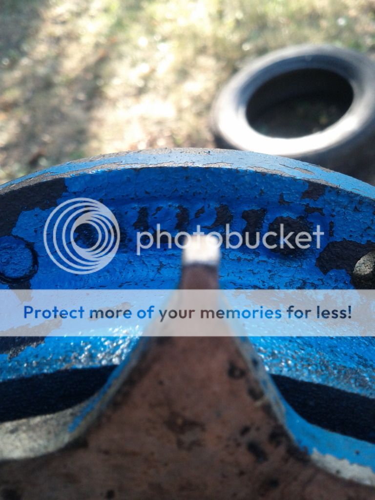

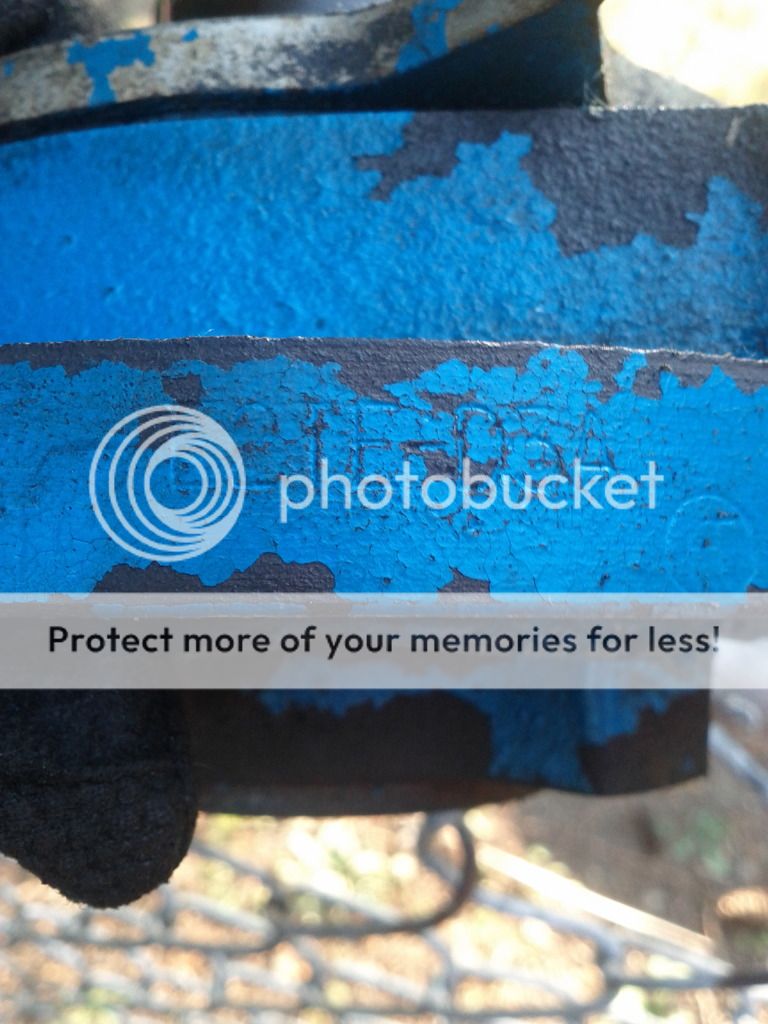

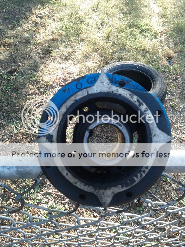

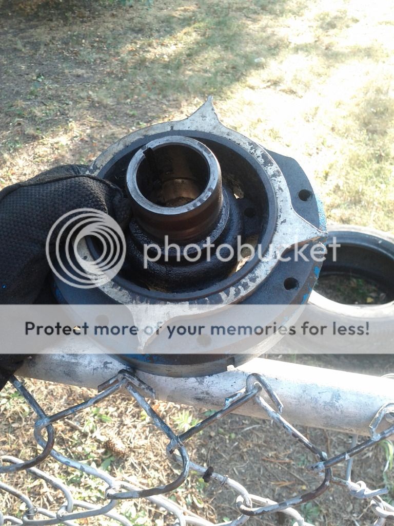

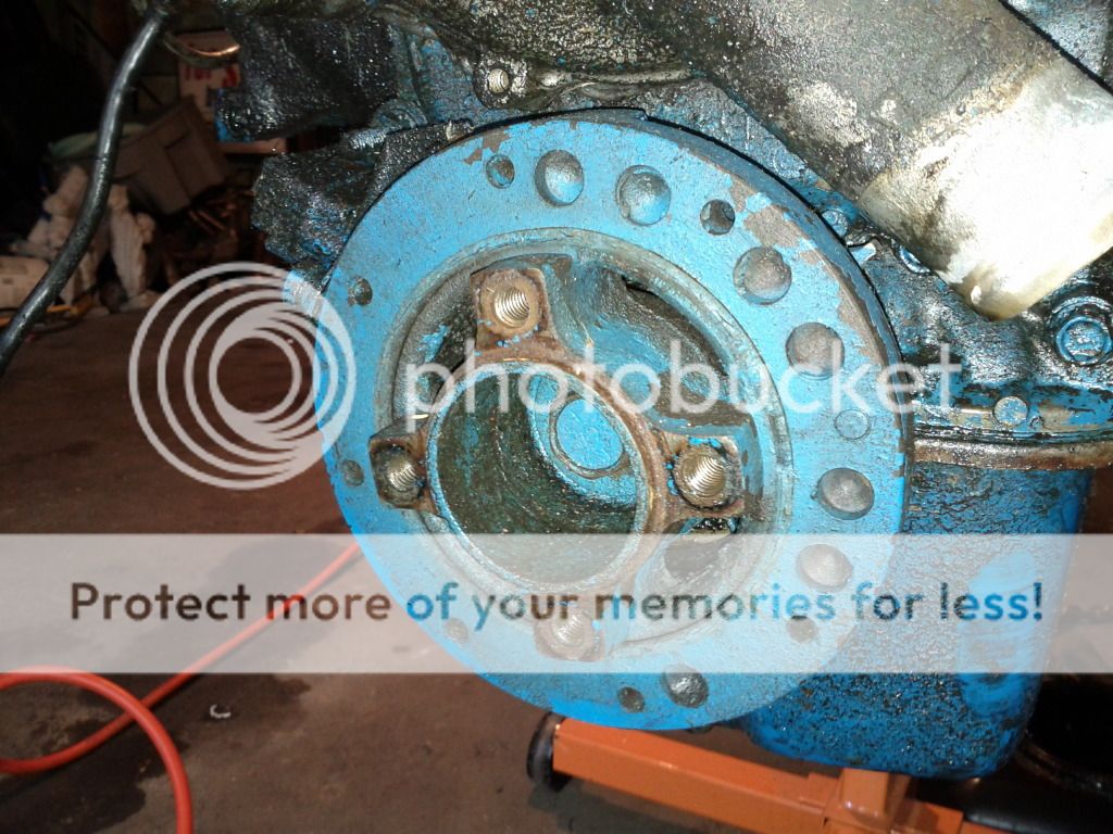

Well, the m5od-r2 takes a 164 tooth flywheel. Since my engine is from 1980, i would want to use a 28 oz flywheel. Correct? I just need to make sure the harmonic balancer is a 28 oz one as well. How can i tell?
I think my friend might have put a different accessory drive on, but i don't know if he changed the harm balancer. I wish i could contact him
