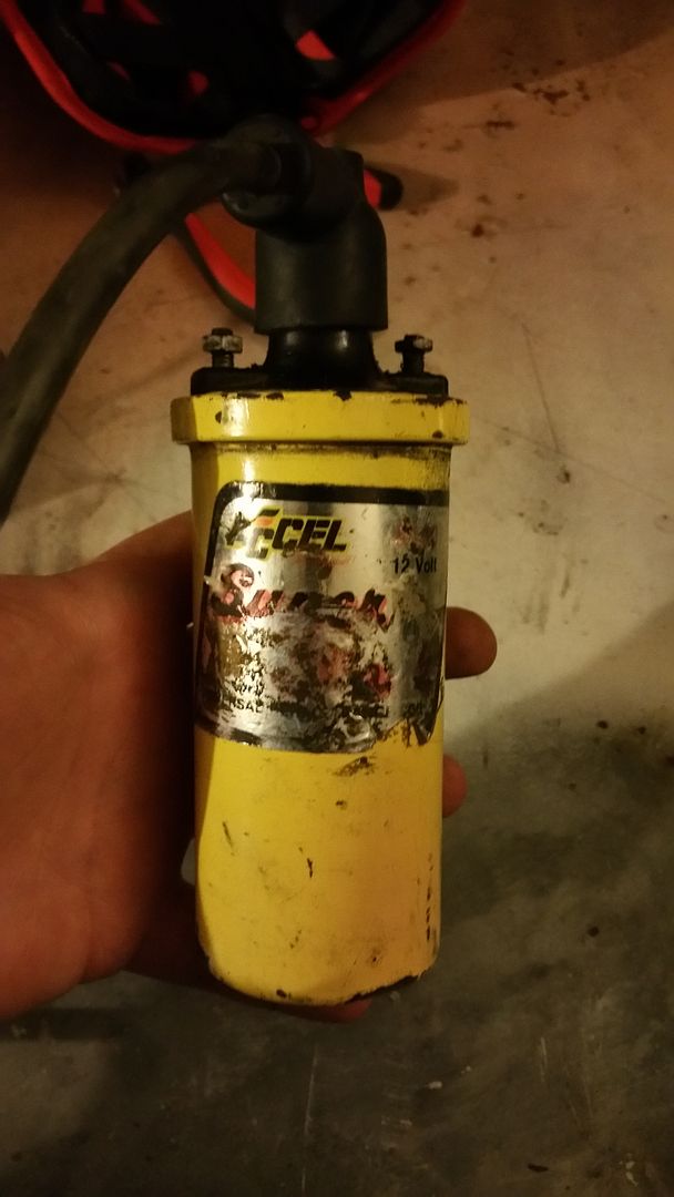

Was cleaning up some stuff in my garage and i came across this coil. My buddy ran it on his mustang. Is there anything special i need to do to use?

If you're running the duraspark setup you need a ballast resistor in line to the postive wire to lower the voltage to 8v from what I've read when using a canister coil. (See the 2.8 duraspark write up in the tech library for info on that).
