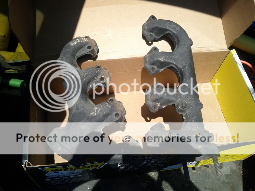

Got some manifolds from 85_ranger4x4 (sorry about being short and not very talkative, im am bad at buying things from people lol :dunno:)

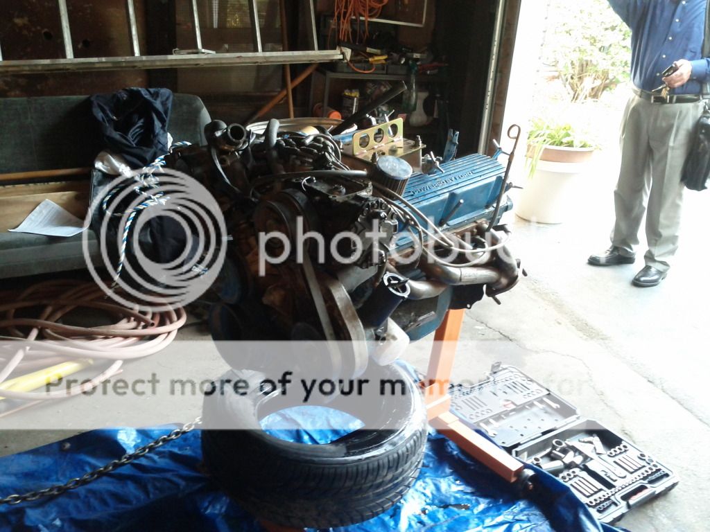

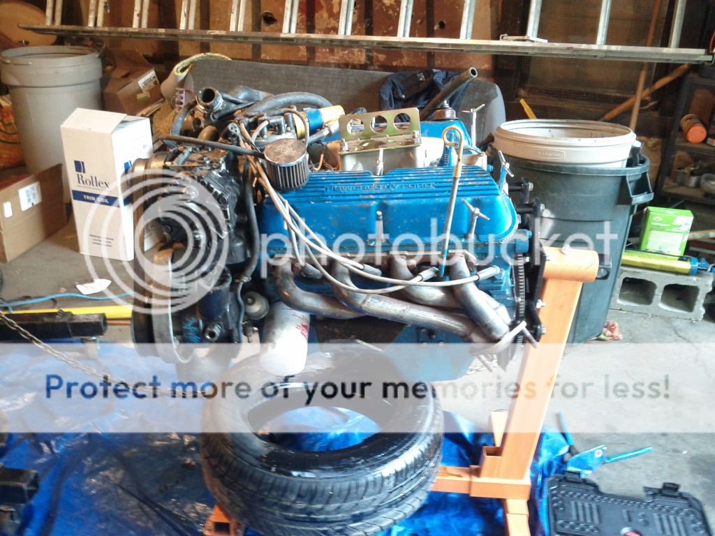

Also got the engine out of my friends garage and got it on an engine stand
