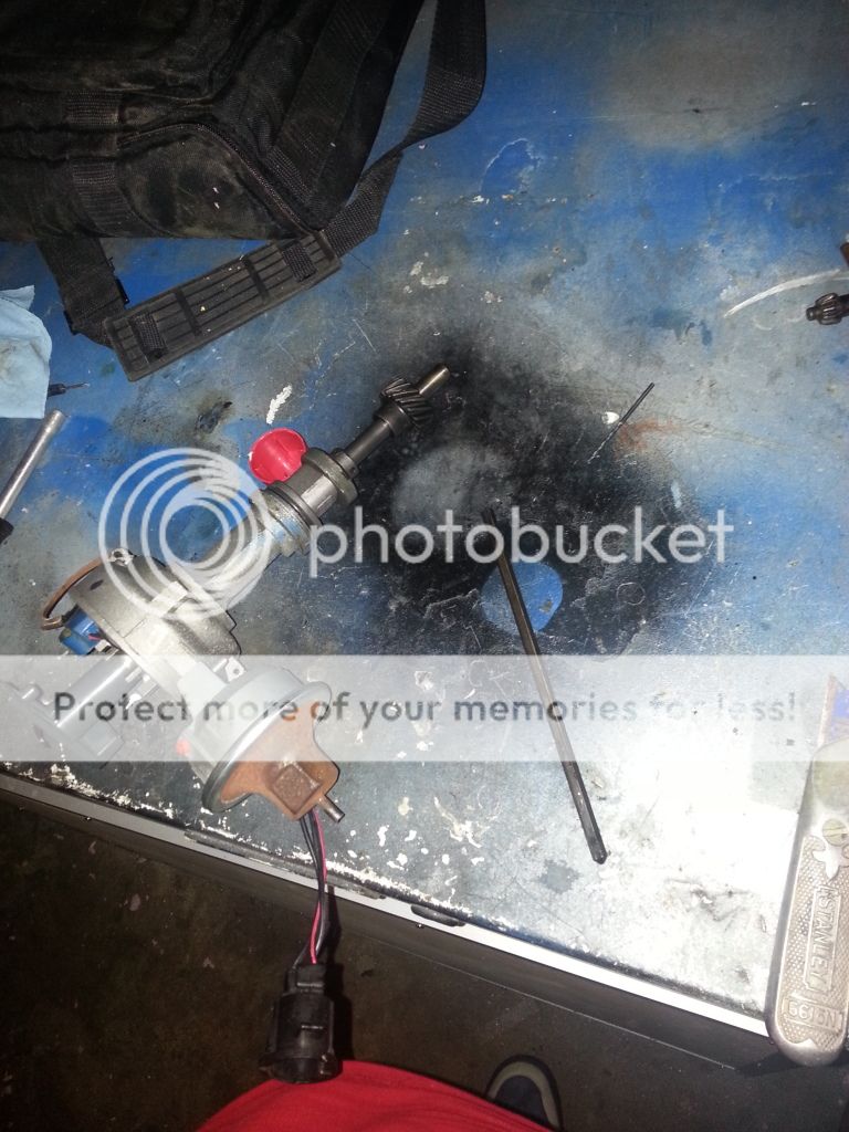

Twister 85 B2 Build
FML, that's not suppose to happen.

What exactly happened, other then the oil pump rod is out of the engine?

That lol, never had that happen and was not expecting it.

Usually it goes to far down and won't allow the dizzy to be able to turn the oil pump.
What to do now I'm not exactly sure. If the top holder thing is there that keeps it from gong into the pan then you are good (if not no biggy get one). It's trail and error to set the depth of the rod but once in, you are good.

Got it back in along with the dizzy.

Waste of damn time. Still didn't start, got the dizzy in near where it suppose to go according to the cap, maybe a little to the driver side. Got it put all back together. Tried both firing orders, using the spot on the cap labeled one and the one to the right of it. Still all I get is backfiring :(

Take the cap off and see if the rotor is turning.

Double check your firing order and make sure it's set counter clock wise. If that doesn't work the the only thing I can figure it could be is your timing chain is off by a tooth.
Hard to be off a tooth since the sprockets are keyed and marked.
