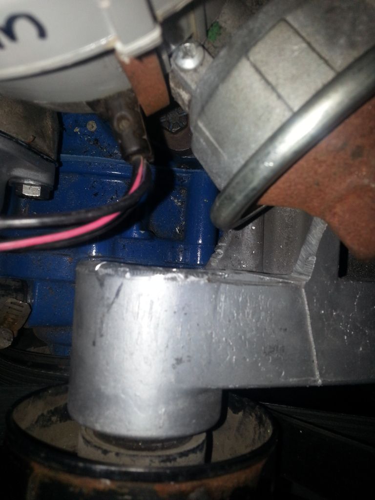

Forgot to clearance the power steering/ ac compressor bracket so I removed it and went to town.
This is with a little grinding.
Put it on and it wasn't enough so took a bit more off.
Anyone know how much of the rounded part that holds one of the idler pulleys I can take off and it still be safe? If I take some more off the back of the round part i looks like I can get more room for proper dizzy placement and timing.
