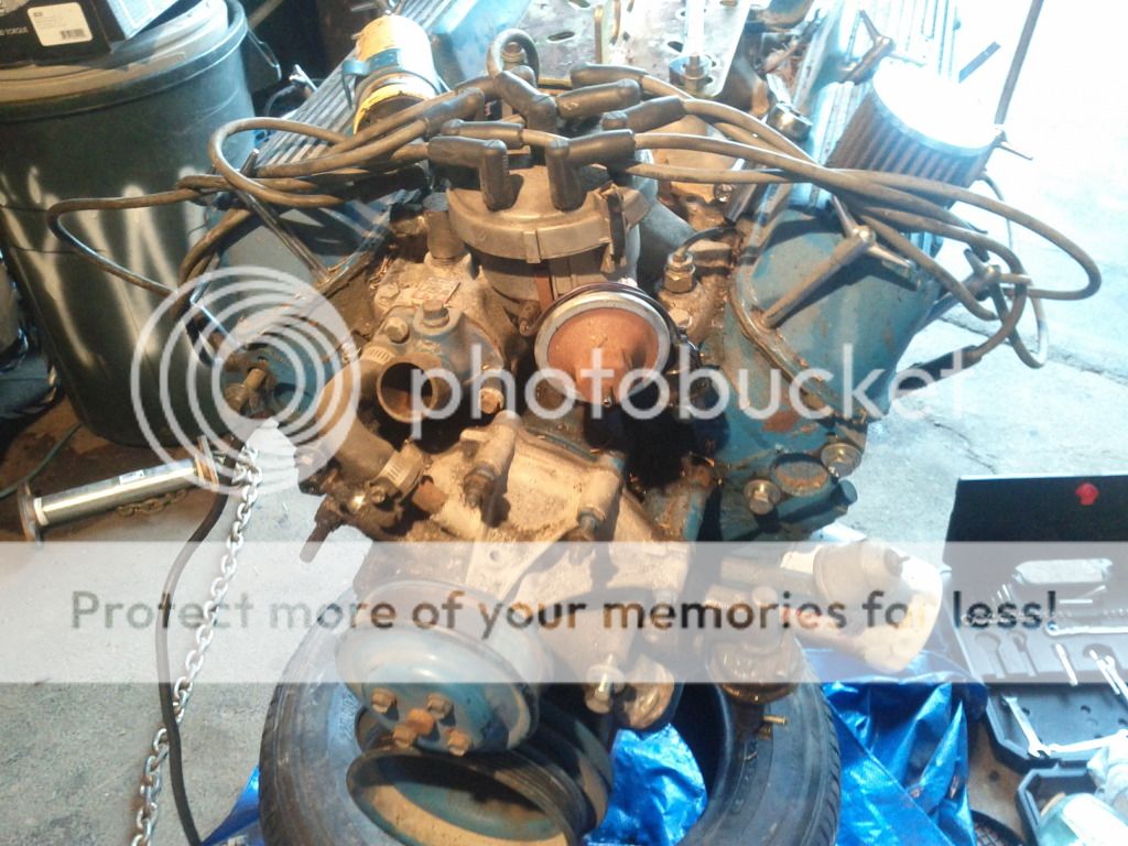

Here is a pic of the engine i dont think i have posted on here and from the looks it looks like it might use the H.O. firing order. This is the engine straight from his mustang and on a stand. The only plug wire that looks like it was unplugged was the coil wire.
After some tracking of two of the wires that I can see going to their spark plugs and where they are at on the dizzy, it is a HO firing engine. The towers I'm looking at are plugs 6 and 5 and they are in that order on the dizzy cap since HO fires 13726548.

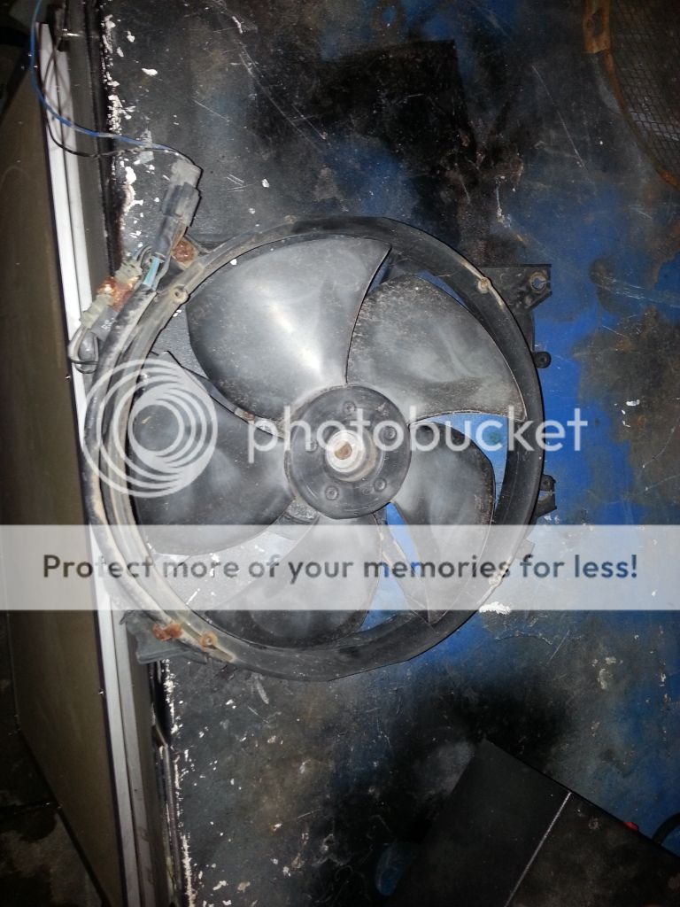

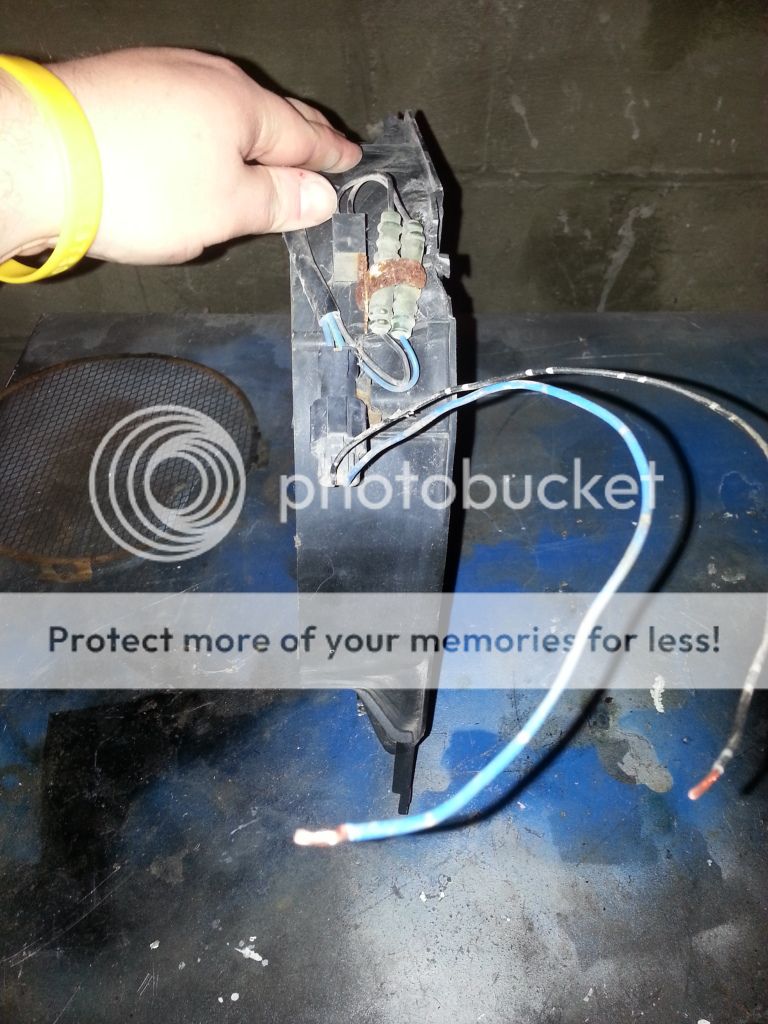

Also snagged a stock pusher efan from an Isuzu rodeo we just junked. Its about 11" diameter. Hooked up to a plug in voltage converter it moved a decent amount of air.
