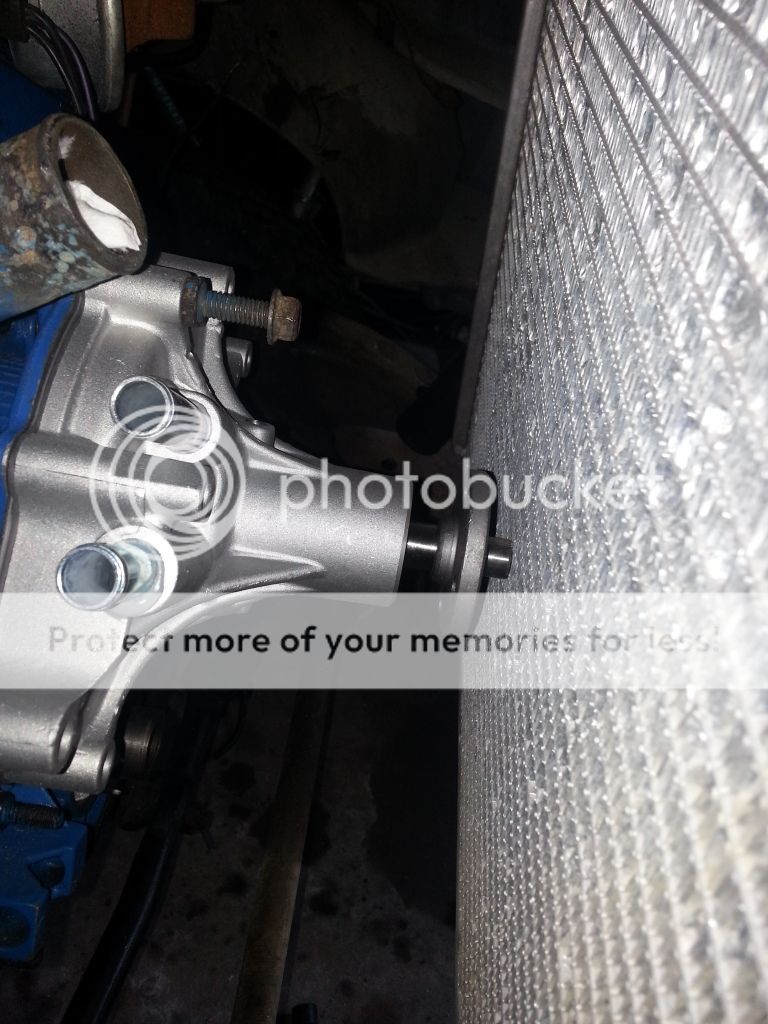

That's OK. Well currently, with the radiator in the stock location I physically cannot bolt on the water pump because it will hit the radiator. I am only thinking about changing FEADs because I don't wanna cut any of by radiator support.

This is the water pump and the radiator in the stock location. It is fully contacting it .

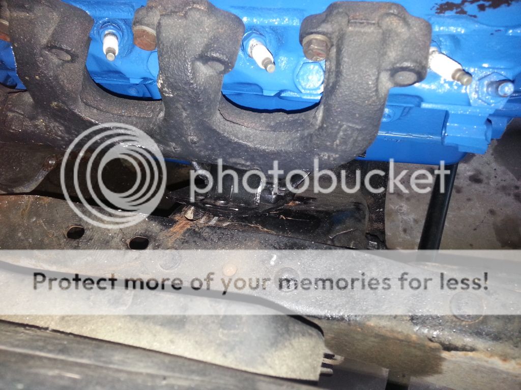

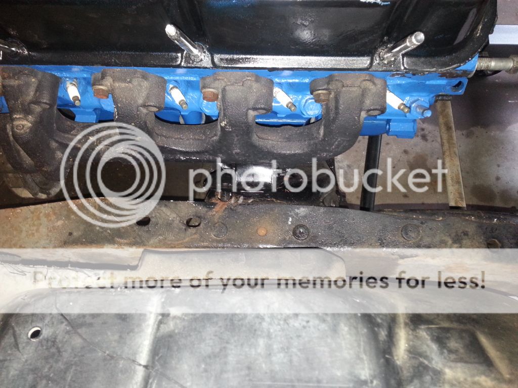

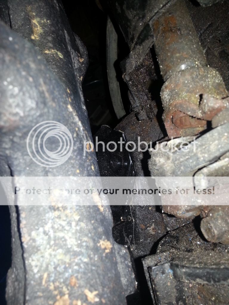

Here are the mounts. let me know of you can't see what you were looking for.
Driver side, which is hard to get a pic of.

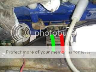

That last photo shows what I "feared". Switching the motor mounts to opposite sides allows the bolt to be in the most forward position, shown with the red line like what I have and yours is the green line because the bolts are further back. Only reason my setup is more forward is because I was in a rush to get things done but if mine were slotted where yours are then it would be in a better spot.

I would take the engine out and swap them to put the engine back further.

I would but the engine would only go back about another inch.
Just went and measures the clearenxe between the cylinder head and the firewall. There is only about 3/4 of an inch of space. So the engine is about as far back as physically possible.
So redoing it would almost be pointless. Thanks for the advice though. It looks like getting the explorer setup and possibly pushing the radiator under the support o should have ample room

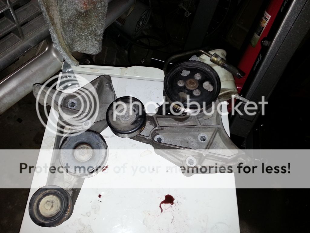

Bit the bullet on the explorer FEAD. Picked up both the major brackets today. Just need the alt, timing cover, water pump and harmonic balance.
