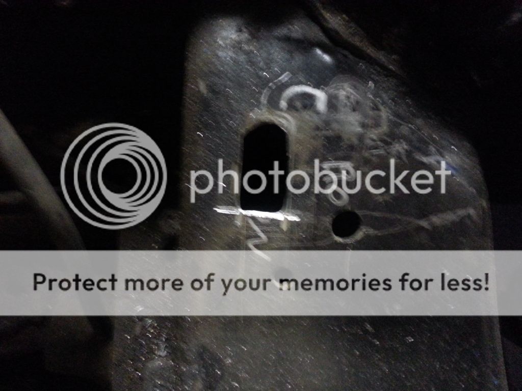

Make yours what you think is a tad short. It is a lot easier to go back and make them longer if need be than to make them shorter.
OK that's what I figured, I'd rather pull it out and put it back in a few time rather than cut to much
Sent from my SPH-L900 using Tapatalk 2
No turning back now

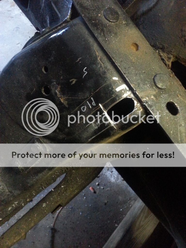

Get the other side done and set that bad boy between the rails for good.
Sent from my rooted SPH-D710 using Tapatalk 2

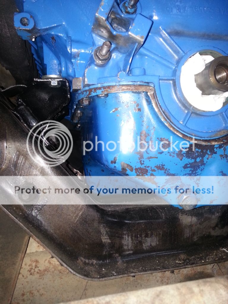

Kind of like this?
Other hole
Twister 85 B2 Build
Here is it set in there, not sure weather it needs mire cut or not. I ran out of time tonight.

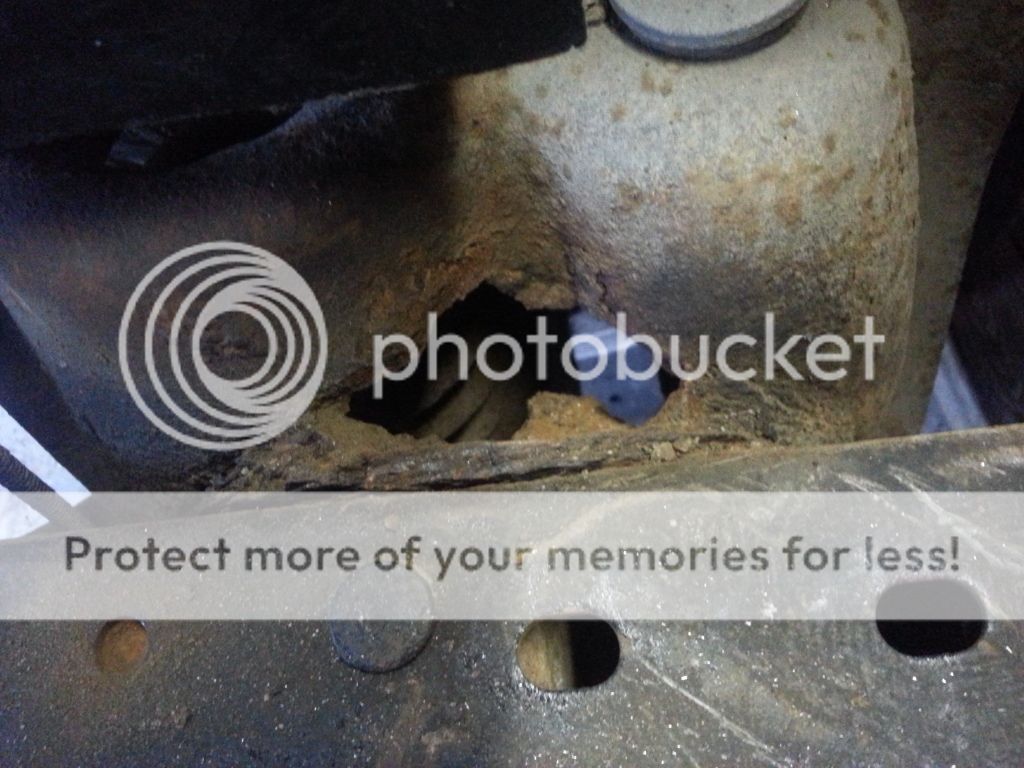

Space between firewall and head on passenger side.
Twister 85 B2 Build
Also this just crumbles away, I'm gonna have to replace after I am done with swap.

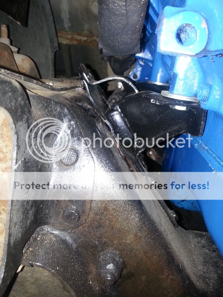

You think I should drop it down any furthur. I slotted it down 1 1/2 in from where I drilled the first hole.
No. Since you have a body lift, you should be fine with any hood clearances, etc... remember, the mustang mounts set the engine lower then the plate mounts would anyways.
Get a picture from the front with the cab sitting on top and I'll compare that to how mine is our you can look at the first page of my build thread to compare heights. The air cleaner on mine is from a 3.8 liter tbi engine, the rod for the cleaner is higher then the to of the cleaner top.
Also what is your clearance to your ttb bracket? You want there to be as much as you can get.

Which ttb mount, the one the rear drain runs into or the one that bolts onto the engine cross member?
The rear sump one, the passenger ttb mount on the crossmember.
I think I can get my hand in-between the oil pan and mount. Ill get a pic of it tomorrow
