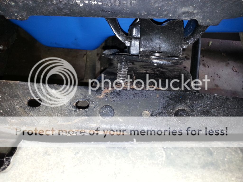

Here's s picture of where my drain plug currently is relative to the ttb bracket. Be sure to get the slots right. My 2 inches would have been to much of I had my ttb setup still.

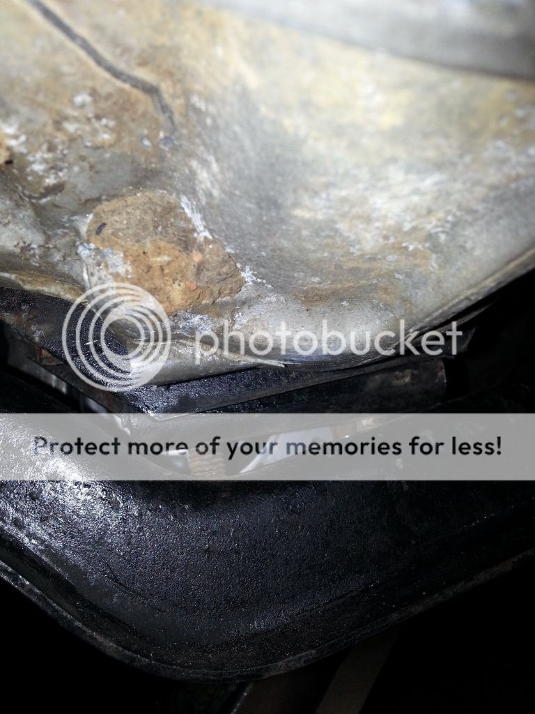

I also shoved transfer case up between the frame rails and it seems like it is going to fit OK, I just need to cut off a weird loop hook on the end of it. I have no idea what it is four but it hits the frame. I would not reccommend the bw4406 unless you have atleast a 2 inch bodyblift.

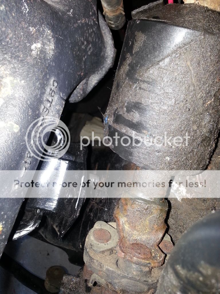

I cut new holes in the tranny crossmember as I thought the old ones would line up but I was wrong lol. But the tranny mount on the transmission doesnt like the xmember.

But the way the engine is sitting in their now, it looks like I am going to clear the v6 mount holes.
If you look you can see the scribe marked where I had the slots set to be made.

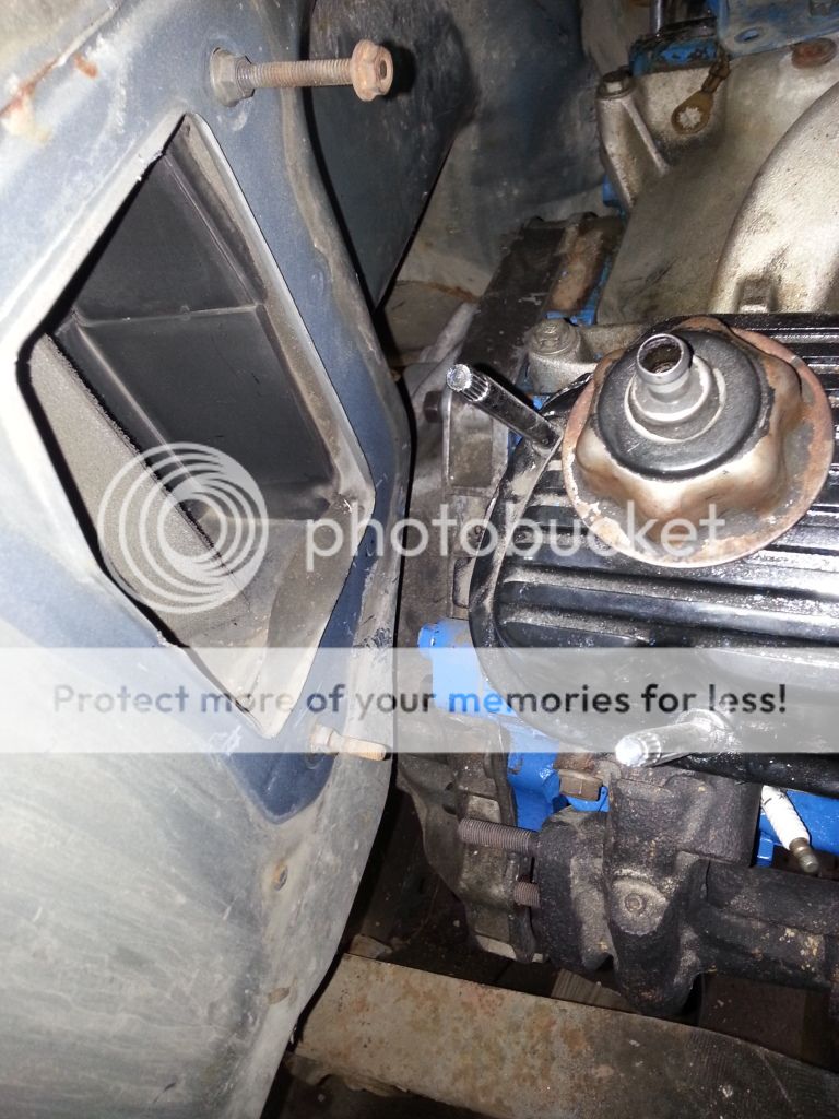

Here the amount of room the engine has relative to the firewall as it sits in the engine bay now.

How your trans rubber mount bolts to the ranger one is exactly how mine looks. I too had to make new slots for it to work.
I did also uses the ranger trans rubber mount on my trans since it bolted right up to the full-size mount holes.
As for the slots, if your happy with how everything is positioned, make them but start shallow and be sure you can get your drain plug out.

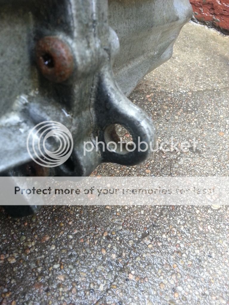

This is one of the tabs I have to cut off or it will run into the frame.
Twister 85 B2 Build
Sent from my SPH-L900 using Tapatalk 2
I heard that there is a tab that you have to cut off to get it to fit but it doesnt effect the case.

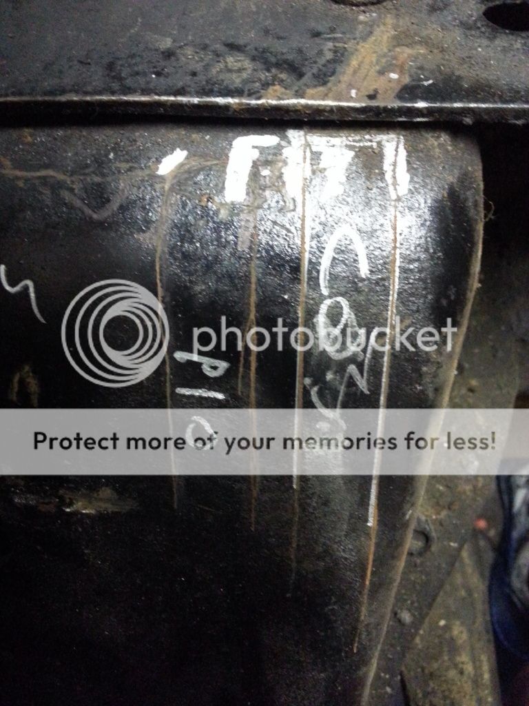

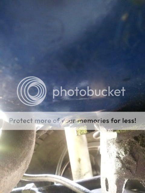

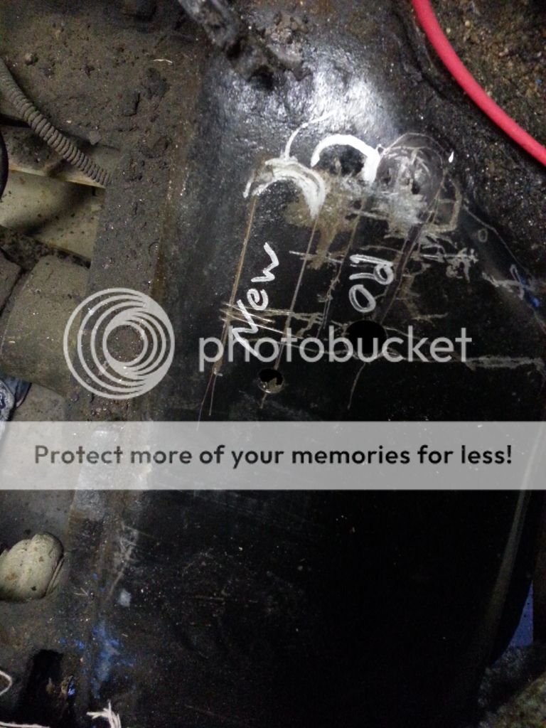

OK so I am planning on taking the plunge tonight and drilling and slotting the engine crossmember. I'm sure I've asked this before but I don't wanna &@$% up my crossmember, but how long should I make slots, is there a general rule or does it vary between swaps? Here are pics of where I marked the new lines.

It varies by swap.
Make yours what you think is a tad short. It is a lot easier to go back and make them longer if need be than to make them shorter.
