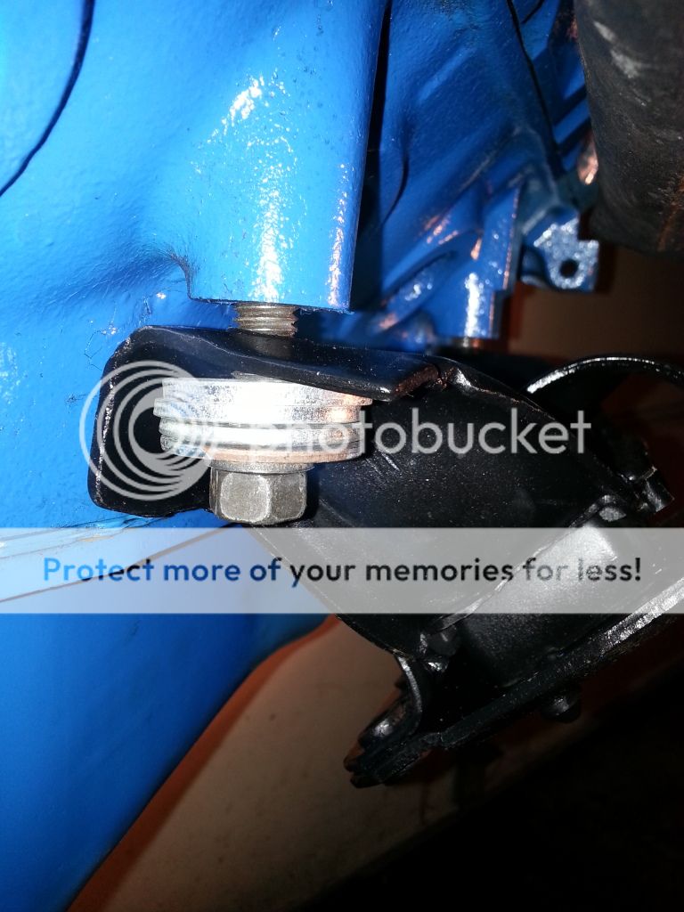

Need your guys opinion, I put on the motor mounts with the bolts I scavenged from my friends mustang. There are two different style bolts, 2 OE looking ones and 2 hardware store looking bolts. The OE bolts have about 1in to 1 1/16 worth of washer, and the hardware ones had about 3/4 in of washers. Should I just use these bolts and get more washers to take up the slack, or get slightly shorter bolts and use less washers?
Here is a pic of the motor mounts put on the engine with the OE bolts.

Bolts are cheap, just get the right length bolts.
My OE bolts fit prefectly. It's one of those test fit a free times in the vehicle to find out what is needed spacer wise.

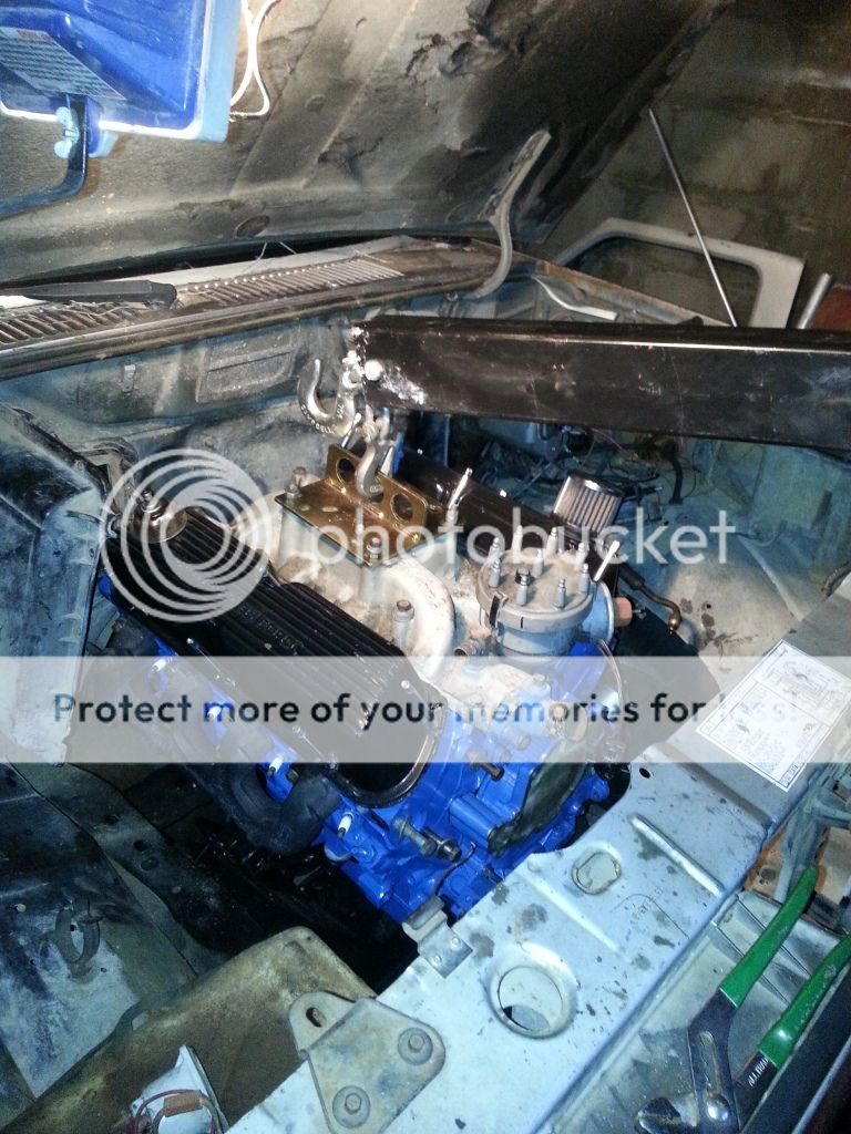

Well for fun i stabbed the engine in my truck, i didnt have anyone to help me with the tranny.

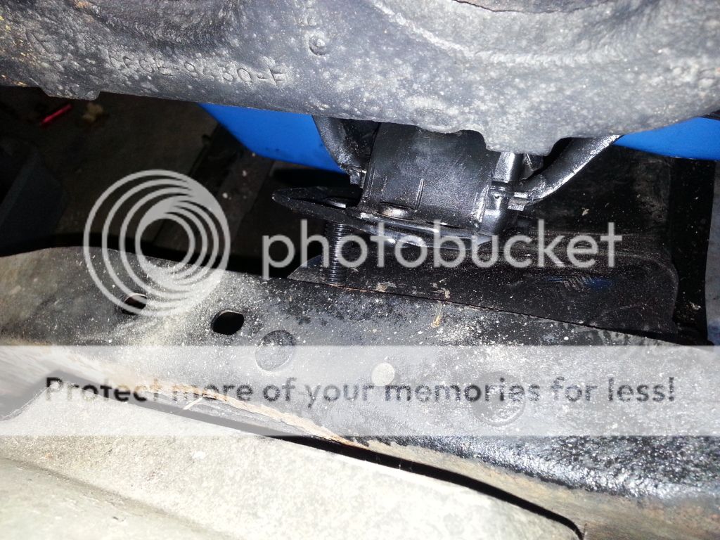

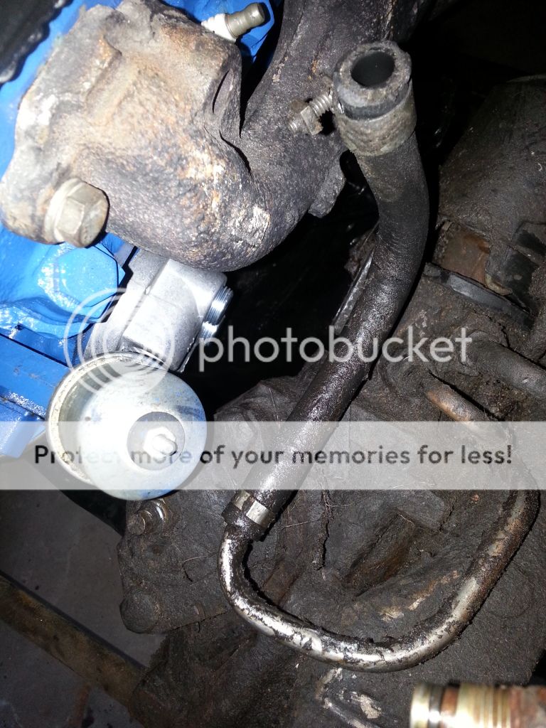

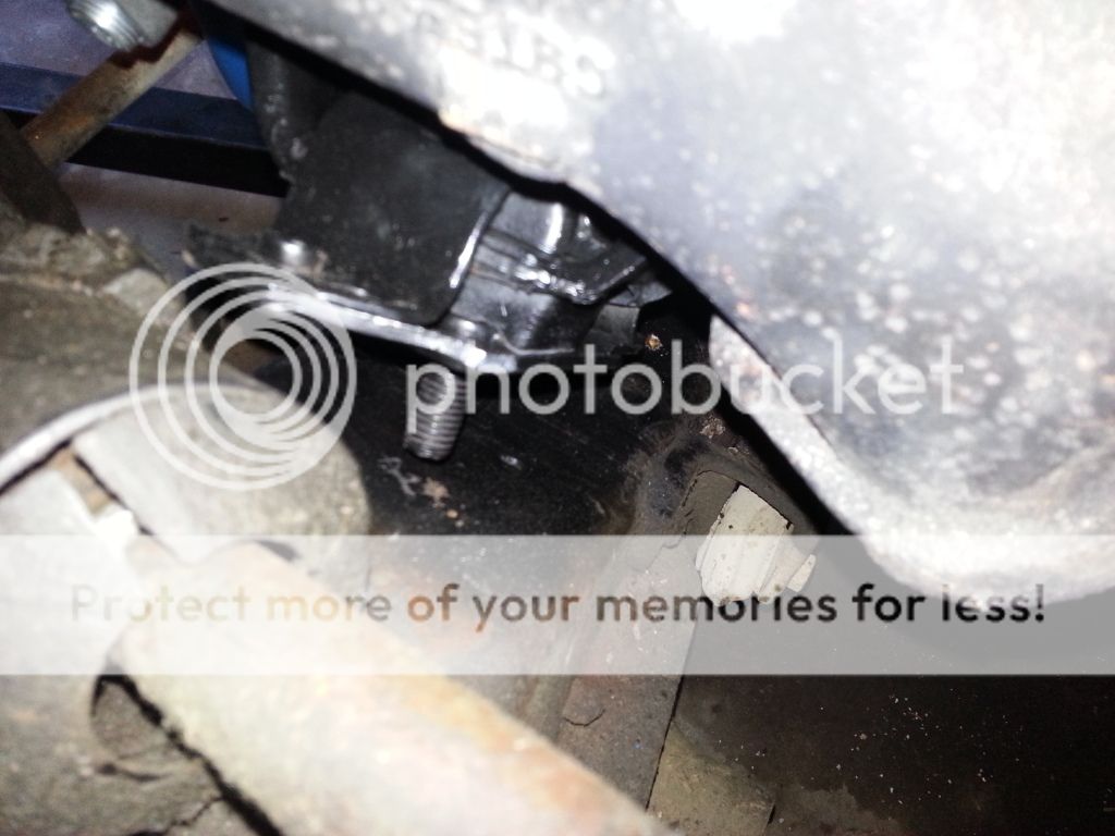

Here are some pics. The Oil relocation bung seems like it will be ok, but i wont know till i fully seat it down. The passenger side mount seems a bit high on the cross member than the driver, also the exhaust manifold on the passenger side seems like a very tight fit.
I am really looking into grabbing a body lift to make things much much simpler.

Passenger side mount:

Driver side mount:

Oil Filter Thing sandwich:

The manifold on the passenger side will be a bit of a tight fit but has enough clearance. If one side sits lower or higher, then that's where the longer books and washers come in place to even stuff out.
I recommend having the FEAD on to help with knowing the final location of the engine for space clearance on the front to the rad.
