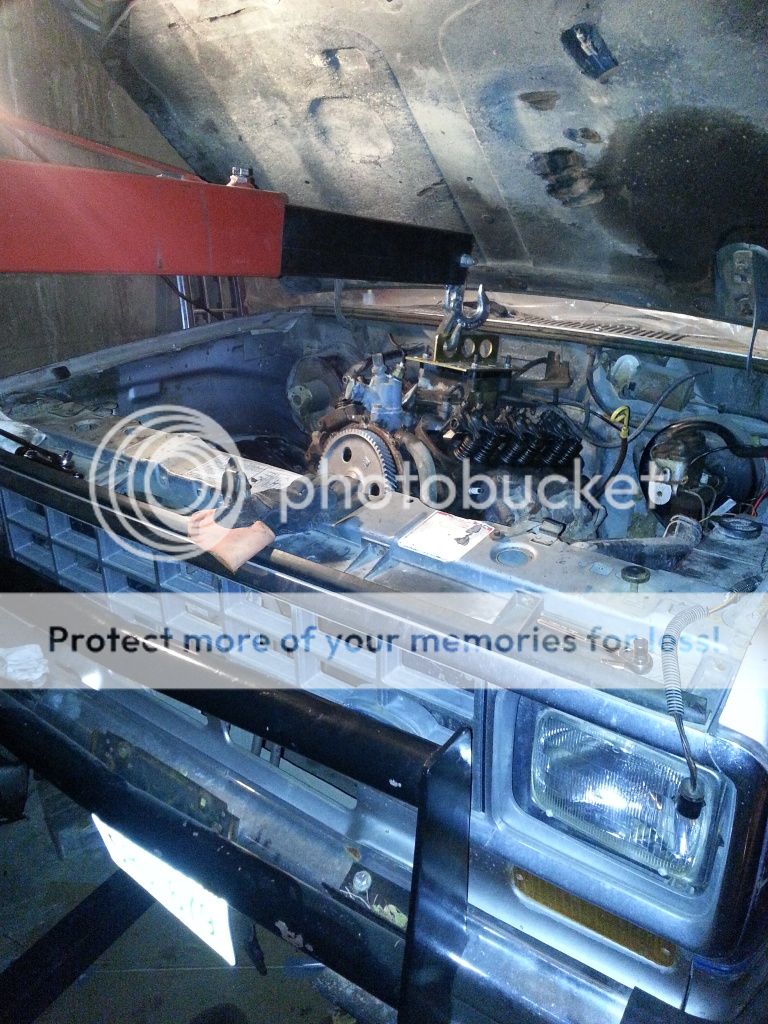

Some progress :yahoo:
Twister 85 B2 Build

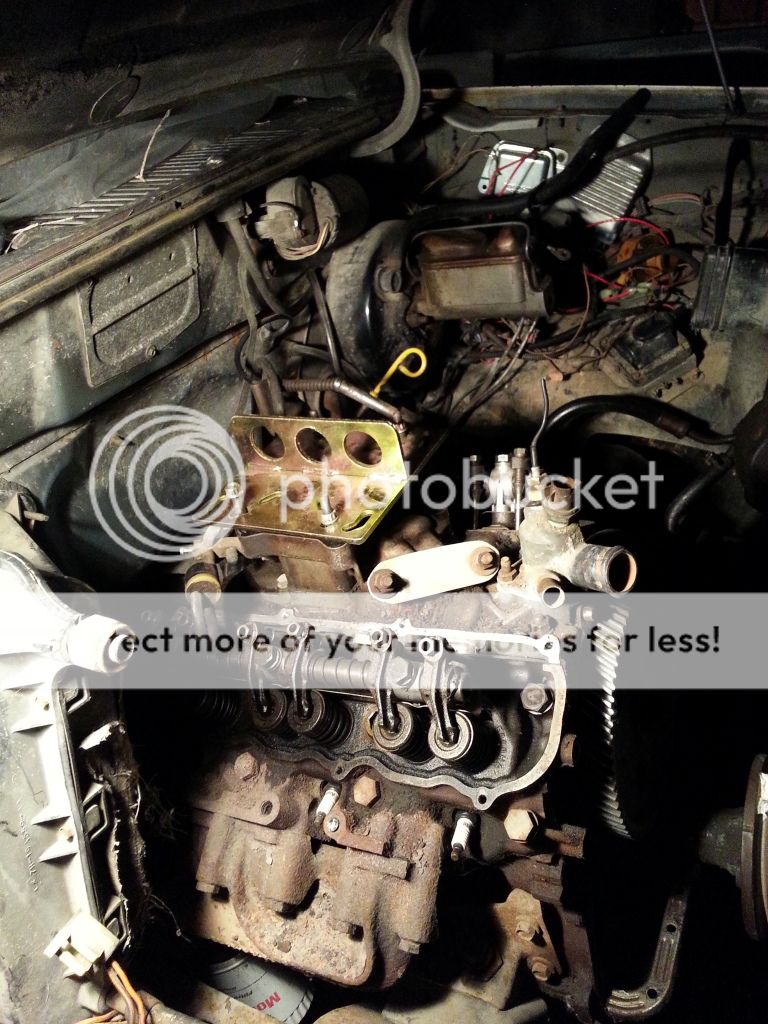

It poking its head out.
Twister 85 B2 Build

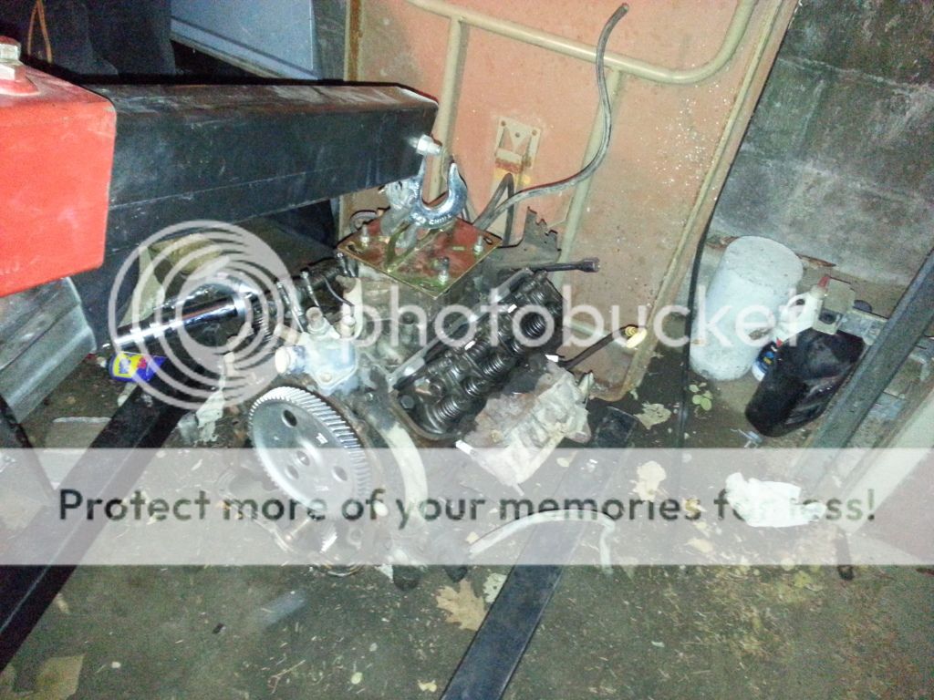

What have i gotten myself into :D. I dont know if it was the power steering or the engine oil, but there is a lot of sludge on the driver side.
Twister 85 B2 Build
Good ol' 2.8... if there is no oil under 'em there is no oil in 'em. :icon_thumby:
That's British engines, not German ones.
My oil leaked from the fuel pump due to the steel and aluminum construction of it.
Sent from my A500 using Tapatalk 2

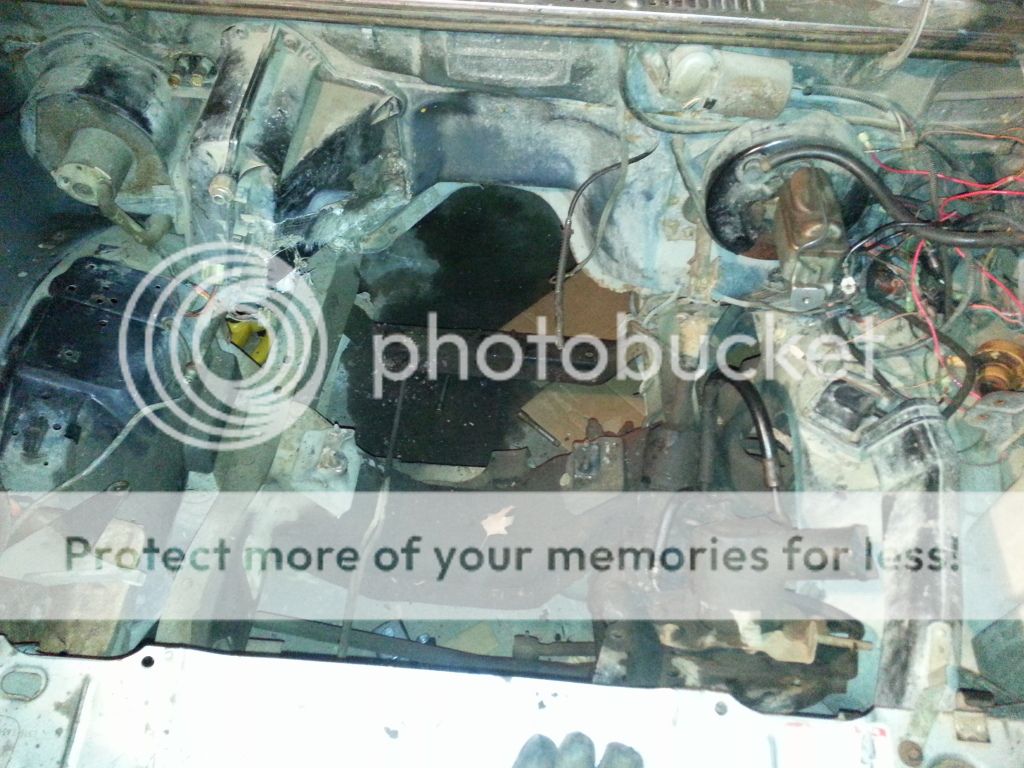

Well went back to the junk yard and picked up the plate. Was only $7( $11 if you include the price for me to get in both days). Much much cheaper than buying one online. It is a little rippled and one of the bolt holes on the bottom is broke, but I think it should work out OK.
