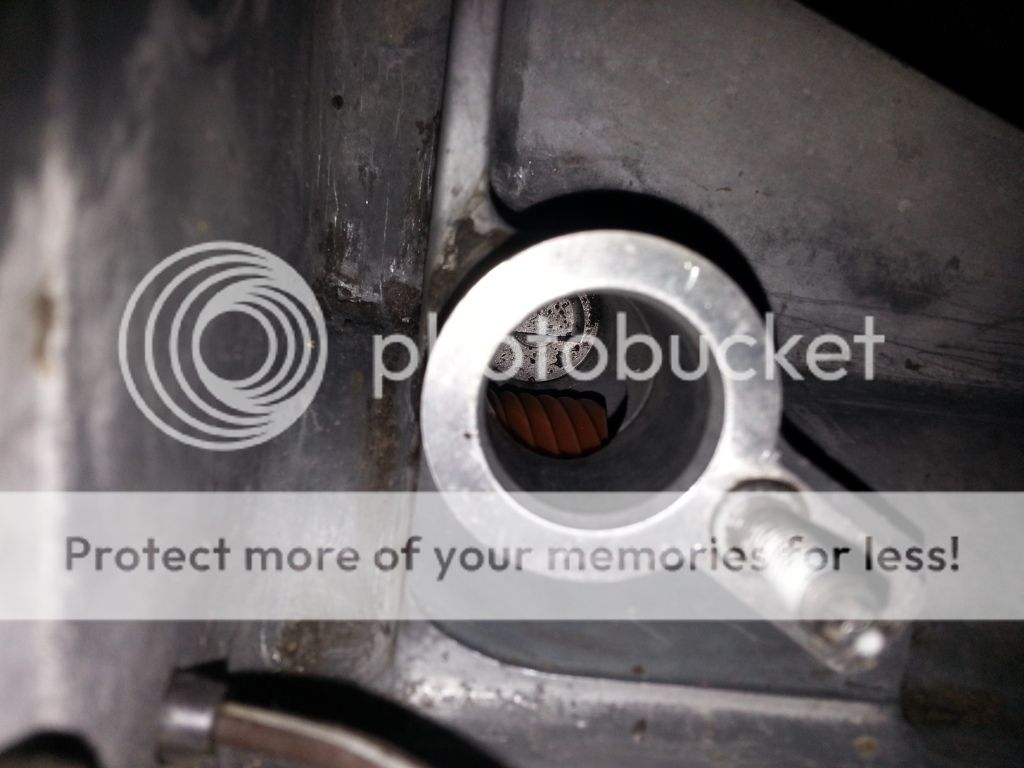

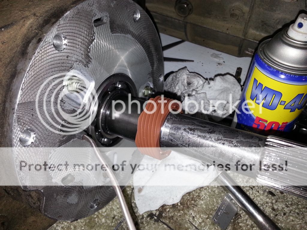

Went to the junkyard and found the tail shaft from a 98 f150, one that uses the gear driven speedo sensor. Got the gear as mention before for $10. I got the t case almost finished, just need to cut a very shallow hole for a small ball for the gear to slide over.
I had to cut off this ring

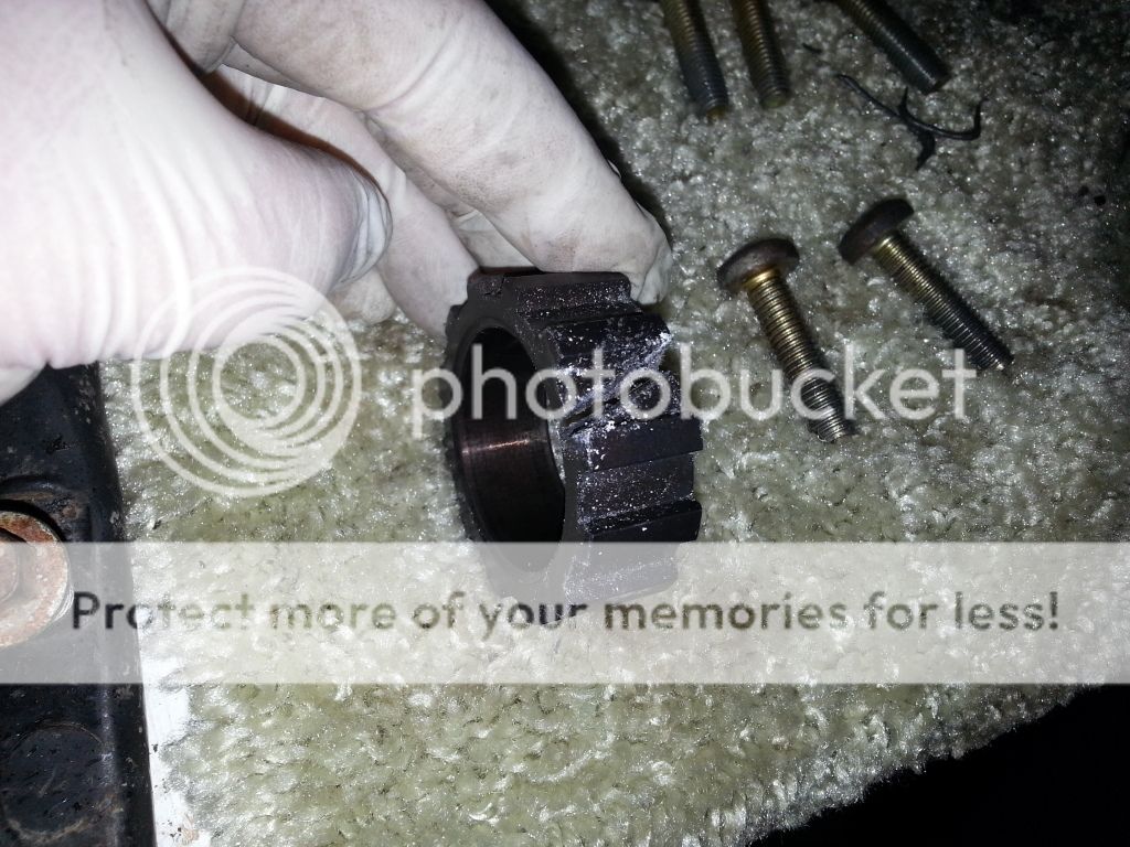

Then slide the new gear into place, it have to cut a very small divit to house a ball bear that the gear slides over.
Twister 85 B2 Build
I put the sensor from my bronco, and it fits and turns great :headbang:
Twister 85 B2 Build
That would make a great tech article IMO. :icon_thumby:
