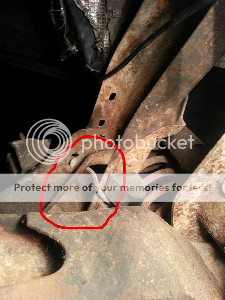

How did you guys get the passenger side motor mount off? The nut is in a place only a contortionist would be able to get to.
Jack up the frame so the axle beam drops more out of the way. IIRC wobble extension, long normal extension and a lot of patience.

Got it off :headbang:
Went in through here:

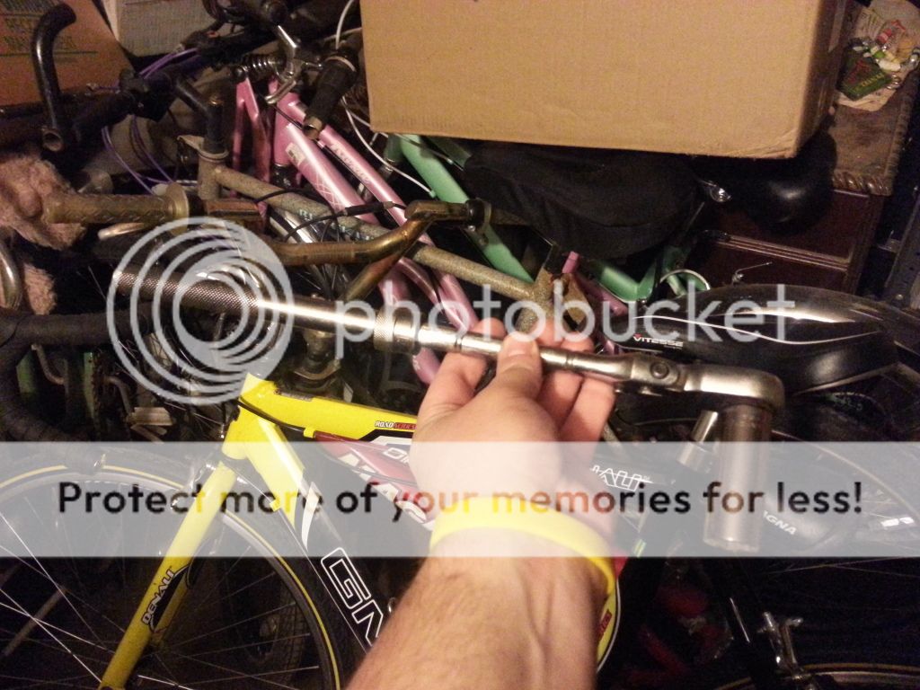

Using nothing but this:

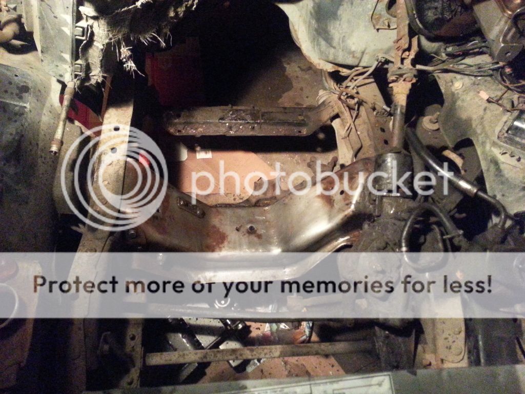

Also cleaned up the engine crossmember a little bit so i can get some paint on it.

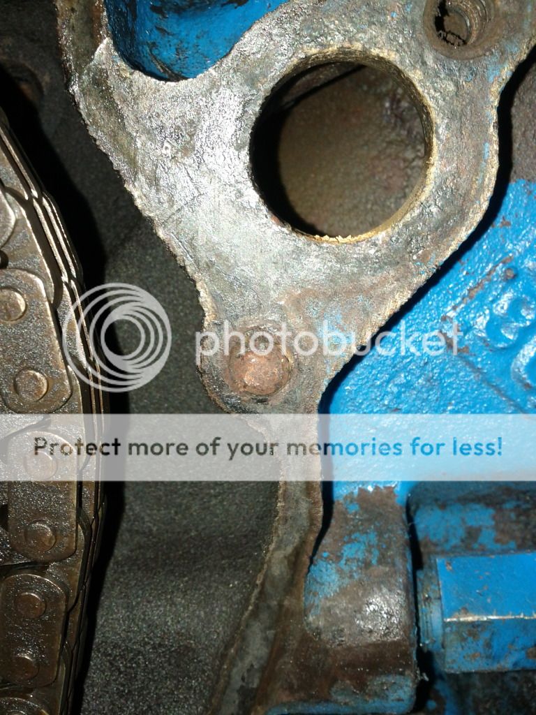

Also, all i need to do before i can set the engine in the truck is get a horribly corroded water pump bolt out, i think i post a pic of it before but here is another look.
The bolt, either get those things that you put in the bolt by drilling out the center and tapping them in then rotating them till the bolt (if your lucky) comes out or drill the bolt out and tap the hole.

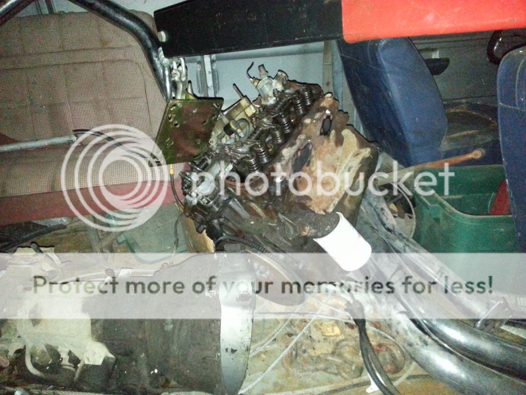

Well the machine shop can't take my engine right now, they have to many they say. So for the time being, I am gonna bring home my engine tomorrow, hook the granny to it and set it in the truck and maybe get the holes for the motor mounts drilled and slotted.

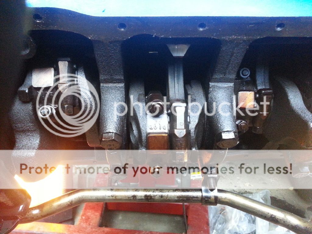

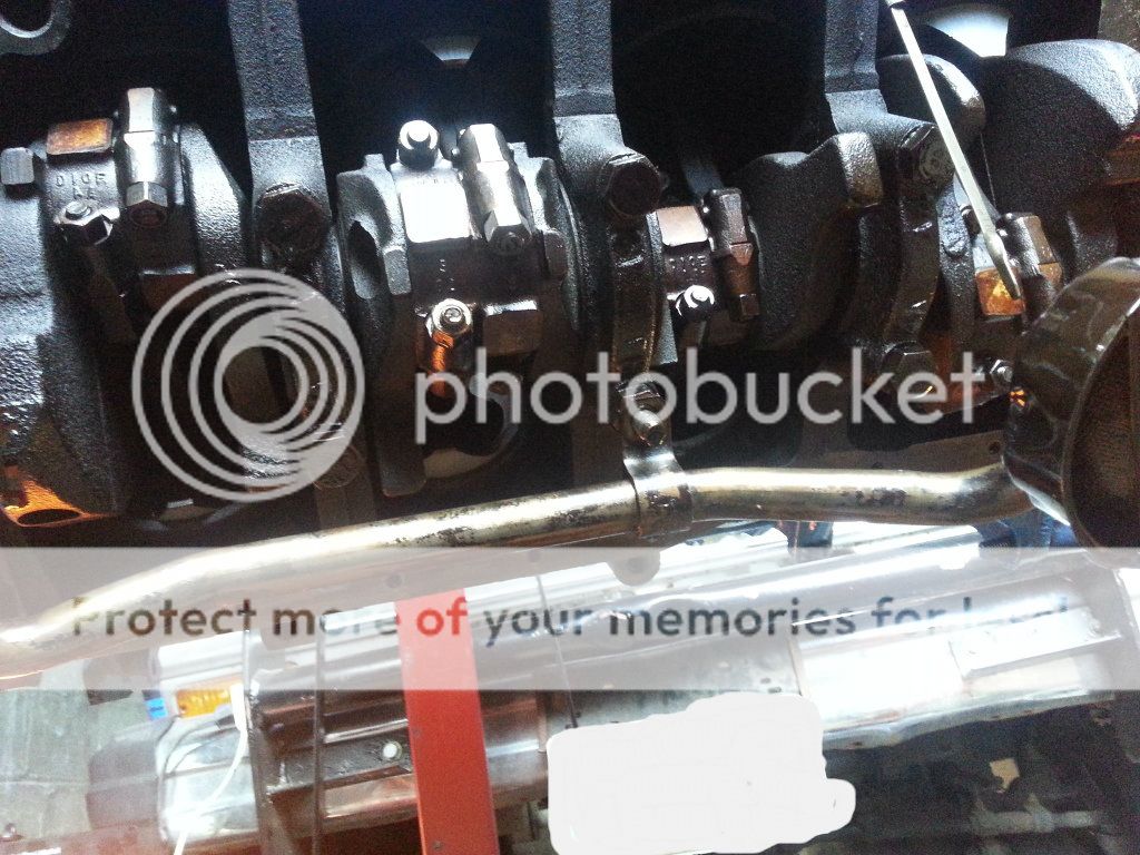

But with the oil pan off i got to look at the bottom end of the engine
