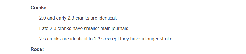

also found this on this forum, i'm guessing the 'smaller crank journals' are being compared to the early 2.3 and not the 2.5...? - And thanks for the response

Yes it’s the main journals that need to be matching and the 2.5 has a single diameter used for its years of production while the 2.3 used, for various years, two diameters. The block you have would need to match the donor crank diameter. I don’t know the years for any of it.

the crank journal thing was in like '88 so not a huge deal on this depending on what parts are used...
2.5L cranks have more stroke than a 2.3L crank but have the same bore so to use 2.3L rods and pistons you need a 2.3L crank, things are designed around piston pin centerline and crank stroke to get compression ratio and so forth...
