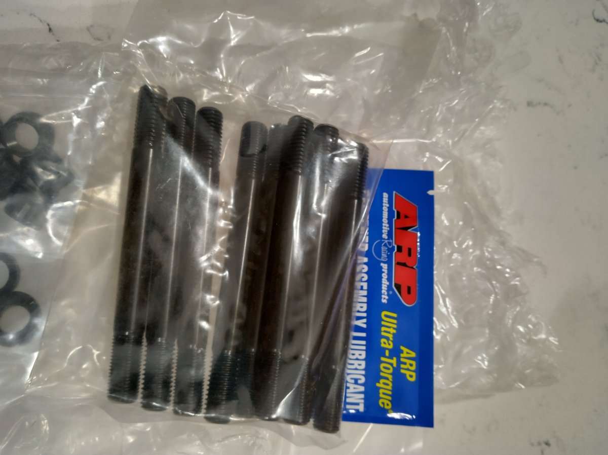

But I've pulled the engine and trans, bought another daily driver car (Ford focus) and started buying parts. Got crank resurfaced, pistons, rods, ordered rings, the gasket set, among some other things. I started painting the engine bay too. Just some rustoleum black. Also just got an email telling me my lowering kit arrived today. I'll post my 15inch wheels for sale and try to get some mustang rims sometime. I should be focusing on the engine aspect of it, but the rings (bought the turbo 2.3 rings from esslinger) are out of stock so they are gonna take a little longer than expected to arrive. While I was on essliner i ordered the ARP head studs too

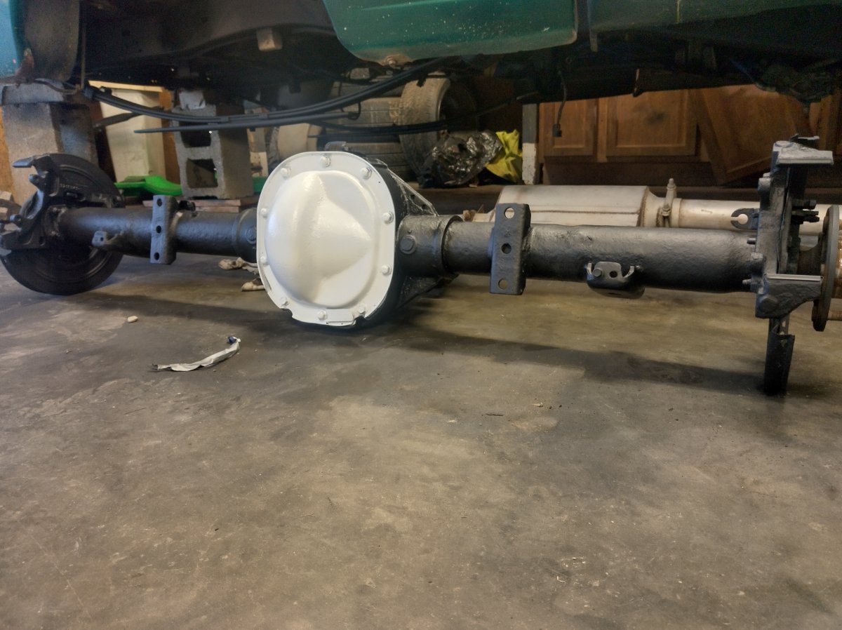

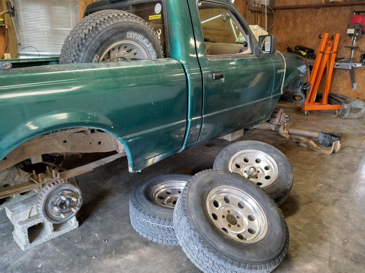

I actually think I figured it out. I returned the low impedance injectors and swapped them for some high impedance of similar power. The seller told me that most injectors are.universal? They fit my injector plug in my harness so I guess they will work. I have been making a lot of progress on my truck, the engine is ready to be assembled but I've been working on painting the frame and other things. Explorer axle that I bought was super rusty I got that cleaned up and it's ready to be fabbed up and installed after the clear coat I put on it.
This is the old axle in the pic.

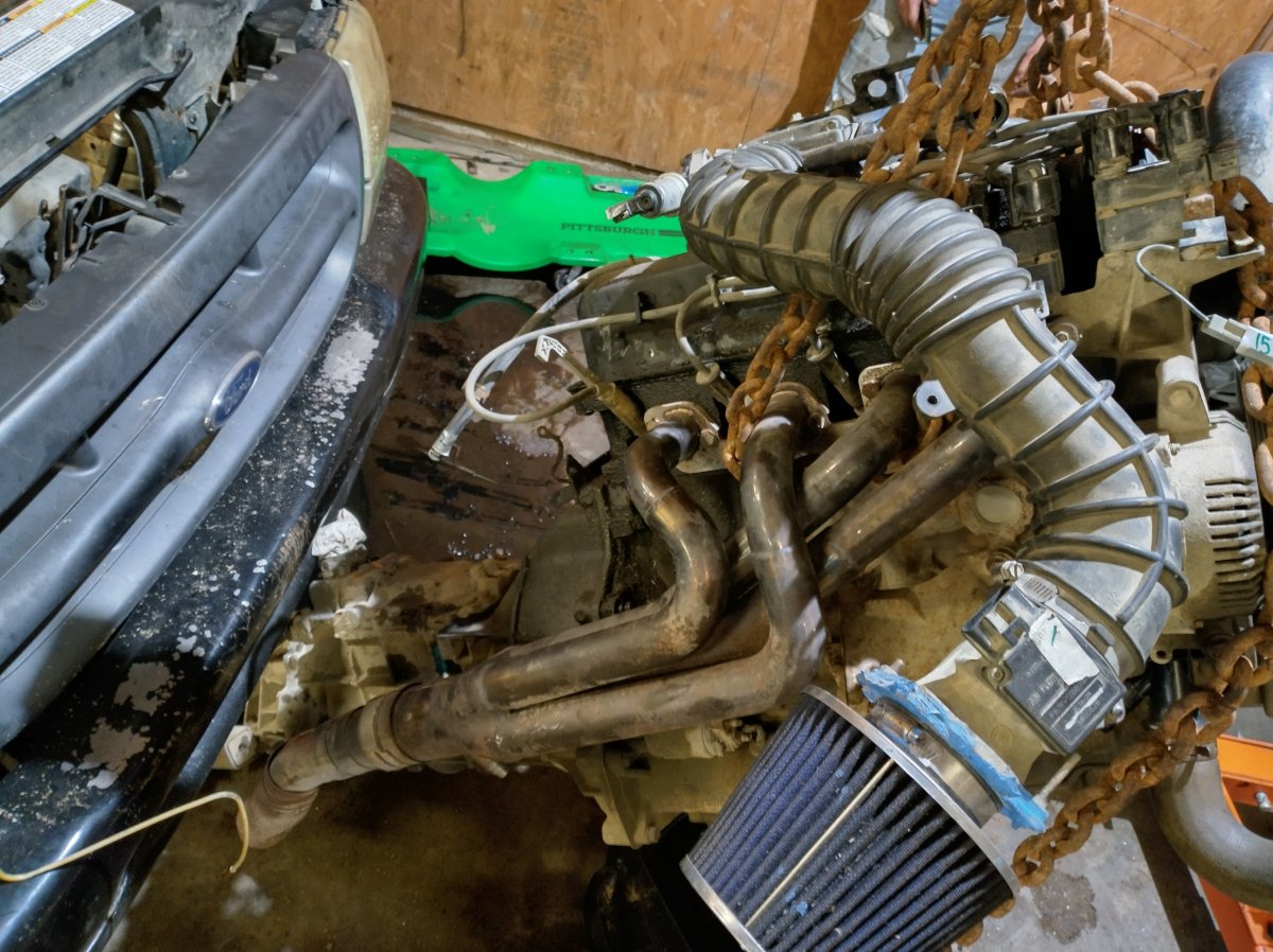

Some before pics plus a turbo I bought, the new explorer axle with 3.73 gears and disk brakes

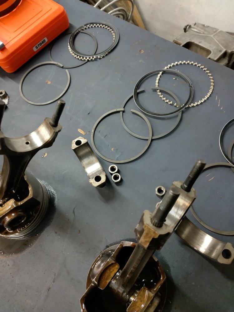

do you understand the rings and setting the gap right after reading the books?
