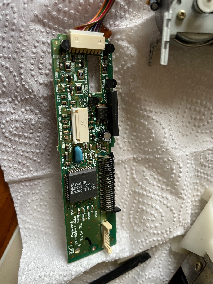

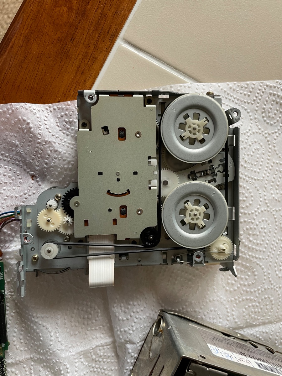

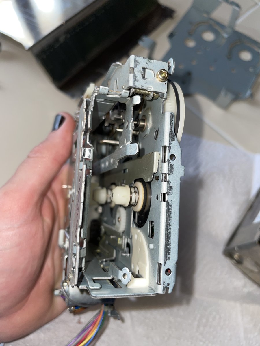

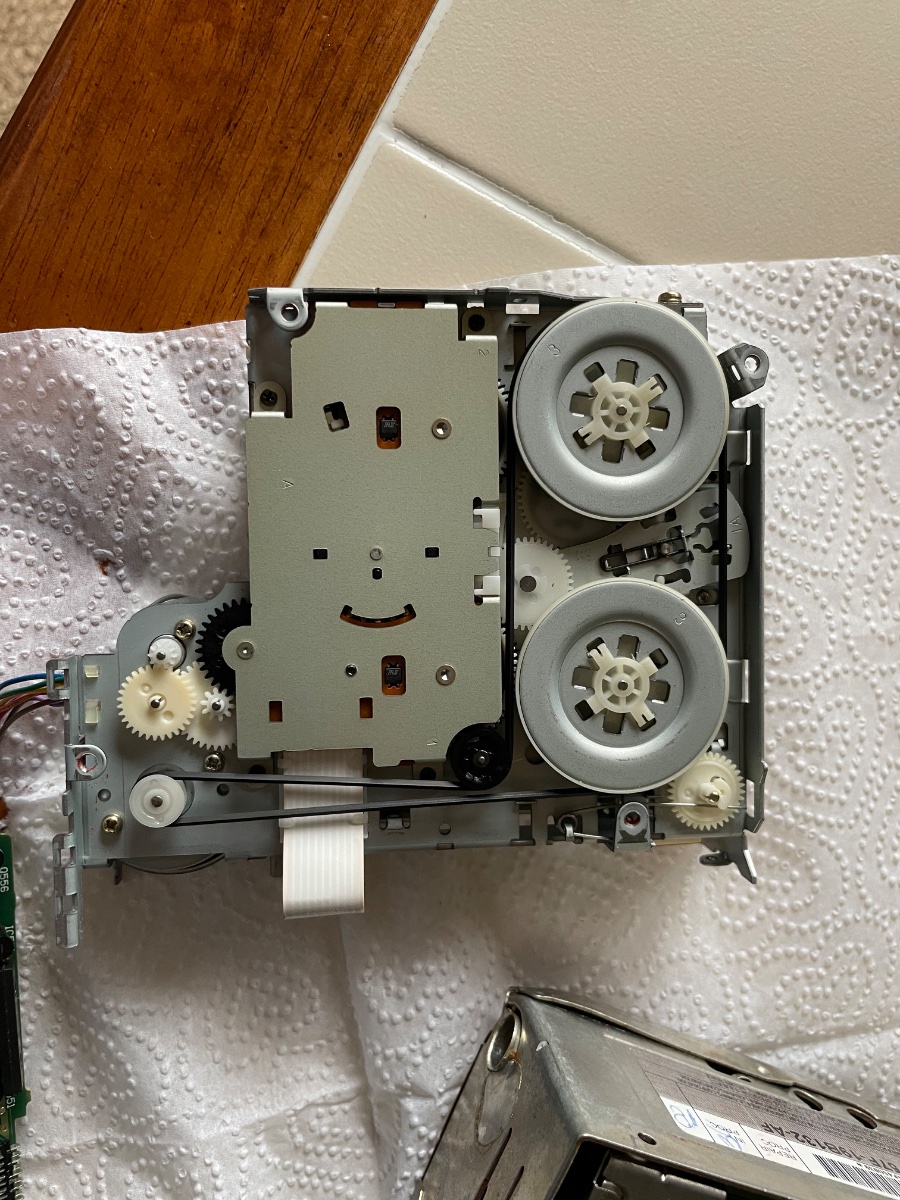

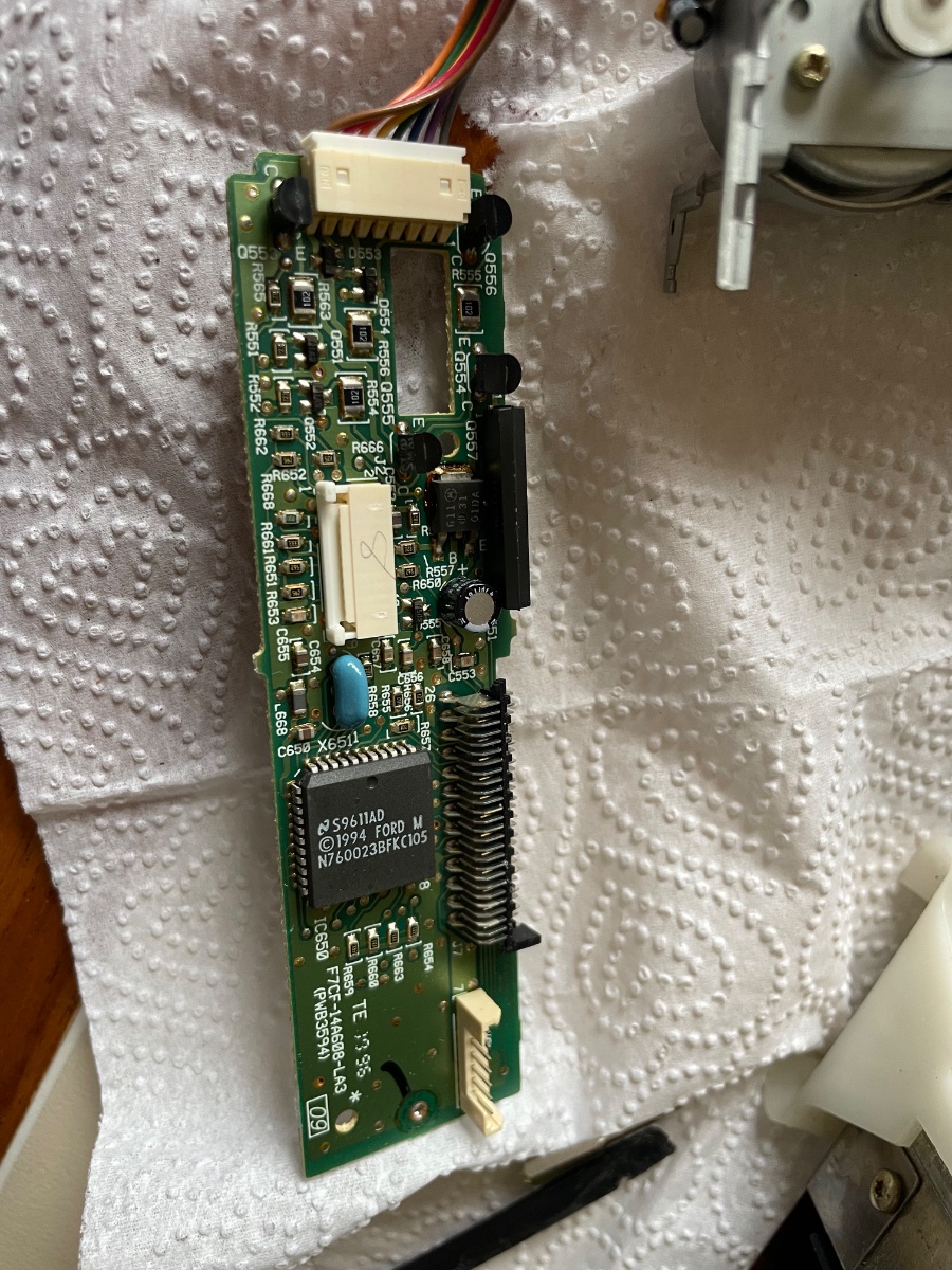

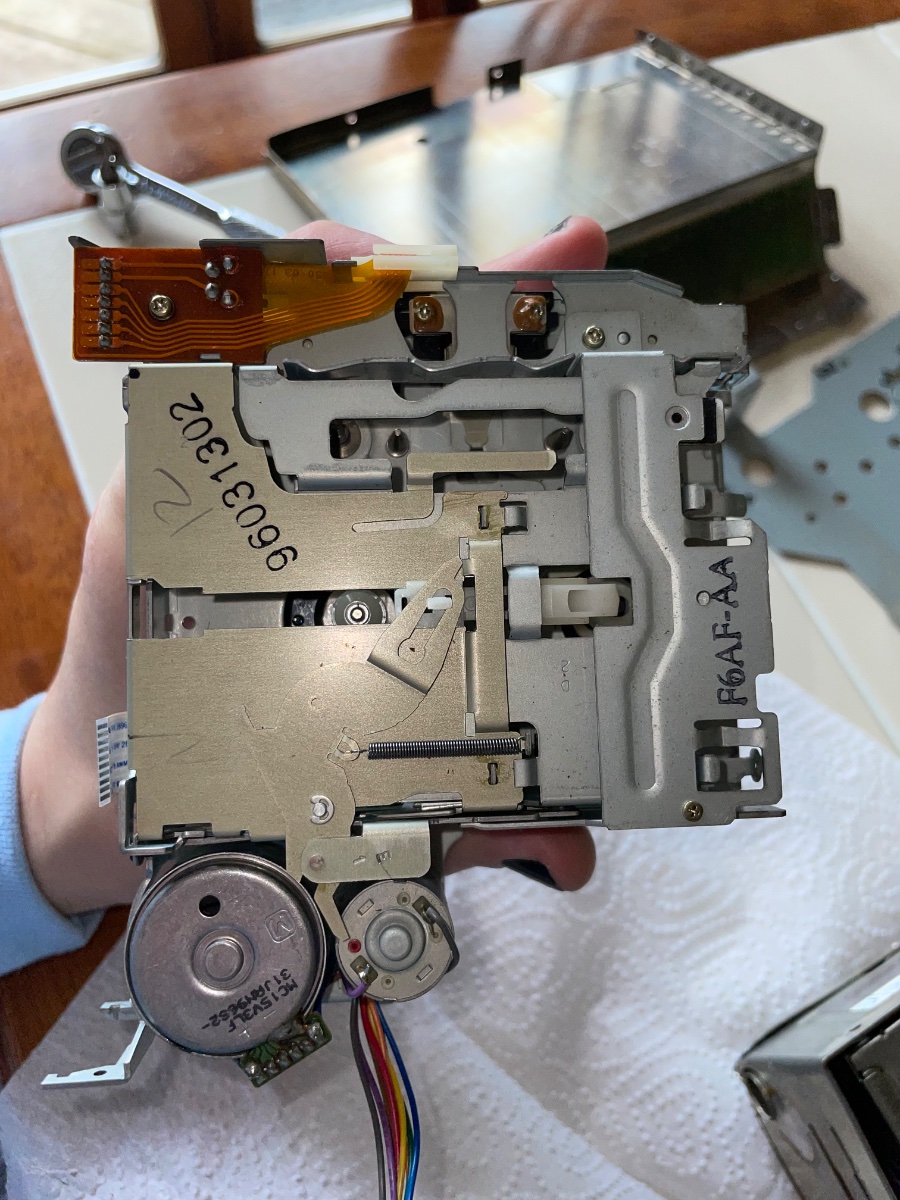

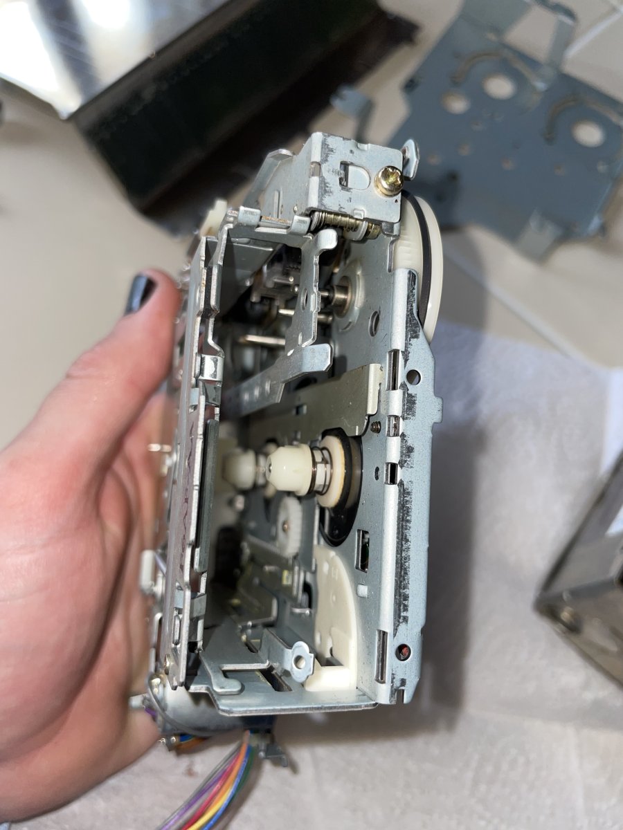

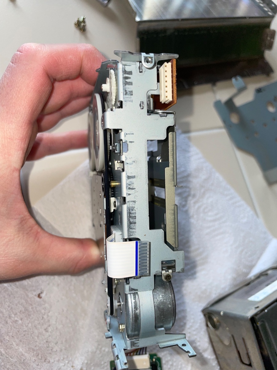

I don’t know if this helps but finally got picture of the inside. No broken gears and the belt seems okay?

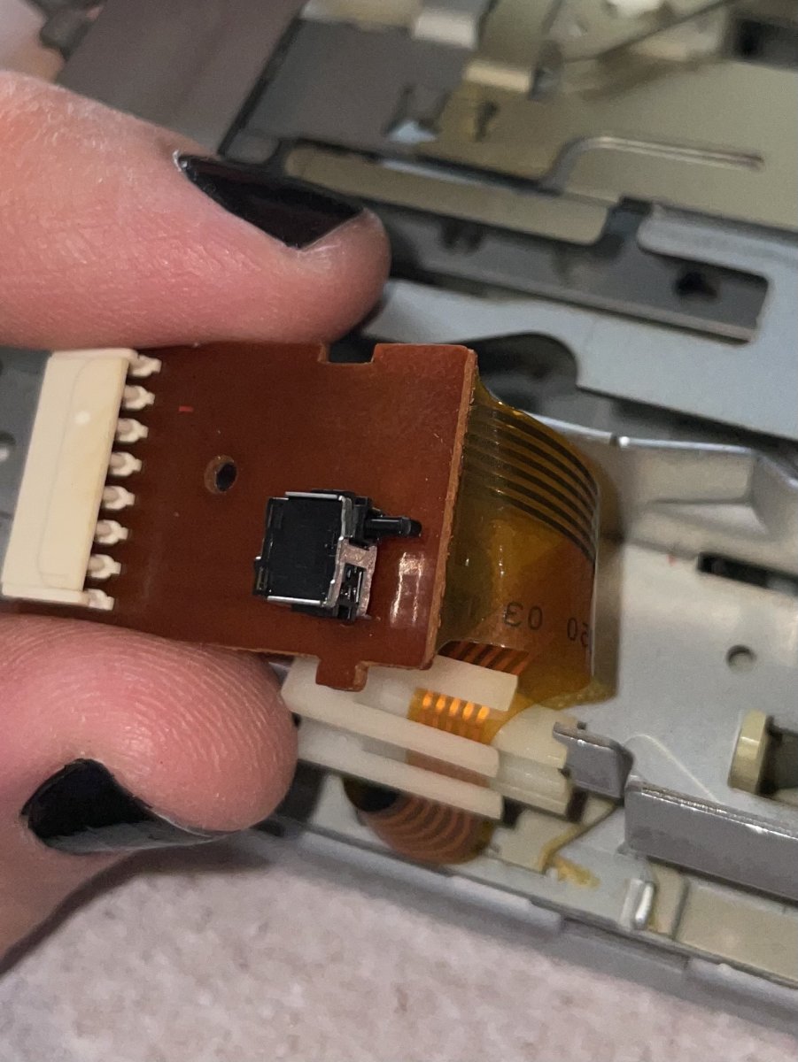

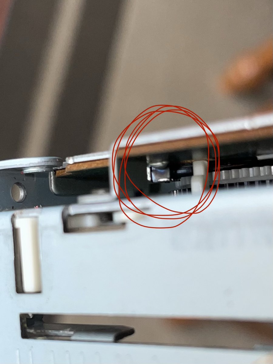

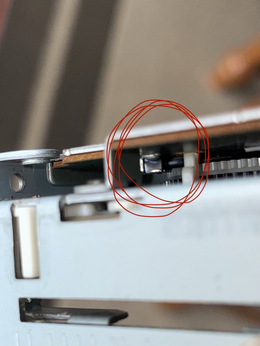

Could this be what’s needs cleaning? Seems to be a pressure switch
I don't know that particular mechanism but that looks like a likely candidate. If the cassette mechanism didn't get used much it may just be light corrosion and may come back to life just by operating it manually a couple dozen times. If you happen to have any contact cleaner such as deoxit or similar, that wouldn't be the worst idea. Just don't get it on the belts or capstan or rollers.
The belt isn't gummy? It's still supple and a bit stretchy? Capstan rollers, if you can reach them, they should have a bit of give if you poke them with your thumbnail. The fact that the belt is still there is a good sign - the bad ones just turn back to crude petroleum.
I used some contact cleaner on the two switches and pressed them in 20 times maybe. The belt seems to still have elasticity. Rollers seem okay too. Reassembled and seems to be working now 🤞
