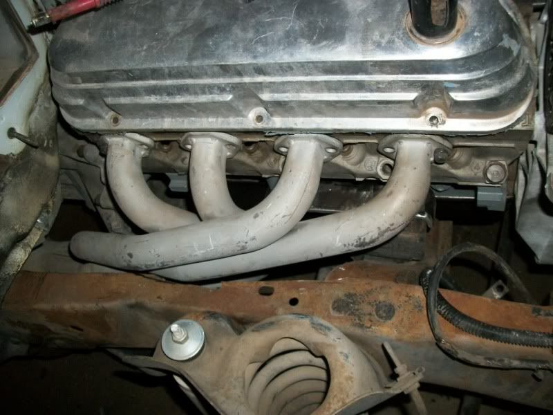

I have been making some Mac long tube headers fit my 83 5.0 project. For the most part the passenger side fits good with a little frame triming and the driver side only fits with the two back tubes so I have been redoing the front two pipes.

Fordmike what size are the tubes on your headers?
They are 1 5/8" headers. I was able to pick up some U bends at a local exhaust supply shop here so it made it alot easier to cut up some good Mustang headers. By the way these headers were for a Fox body with an AOD trans.
