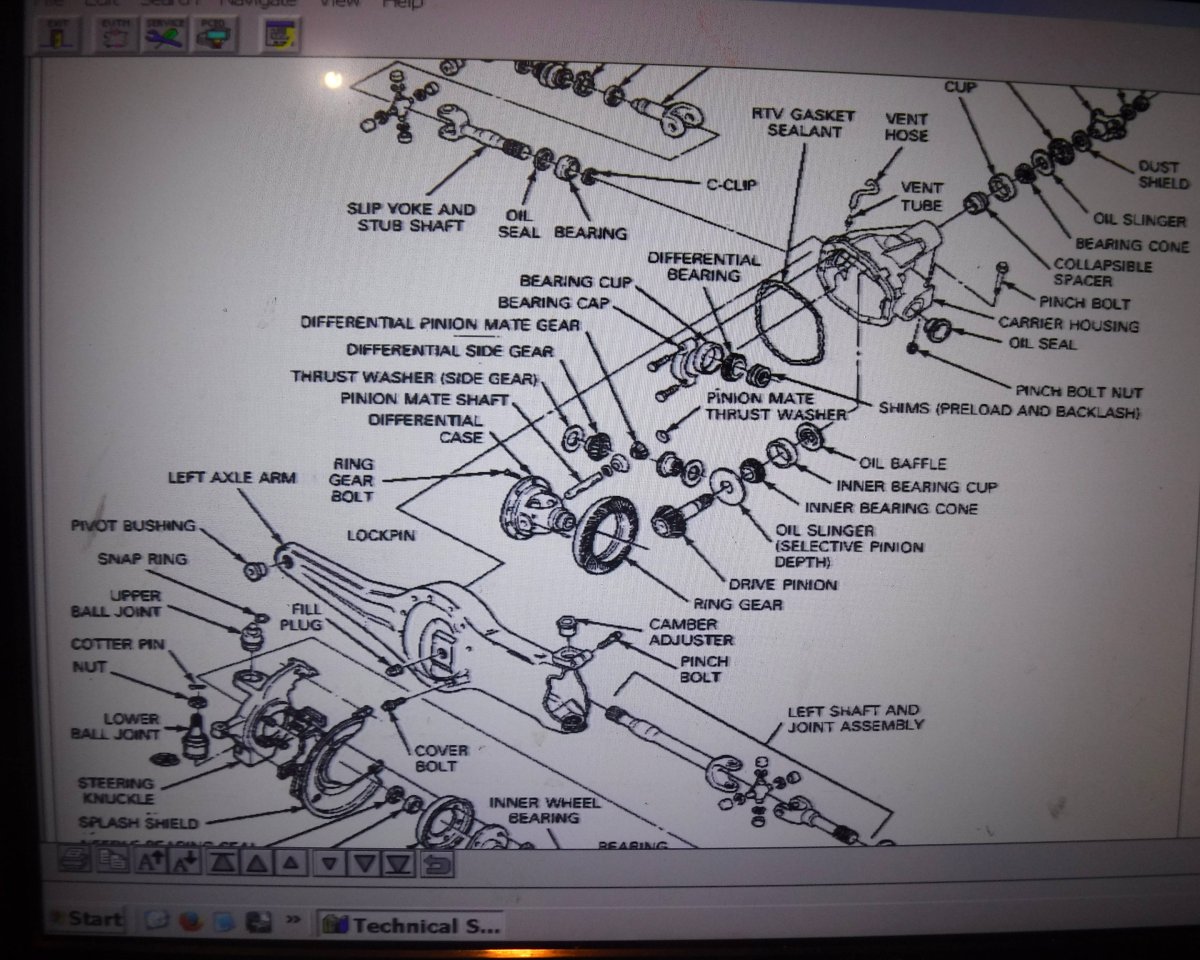

Even when I started digging I started on the wrong page which cleared it up for me. I first went to the Limited Slip Differential (Rear Axle I soon realized) First photo, you can see the Clutches and the Spring, which together provides the limited slip function.
Then after realizing it was the rear axle there, I looked at the front axle and there is nothing that can slip between the Transmission and the wheels, nothing, which yields a direct gear drive with no slip.

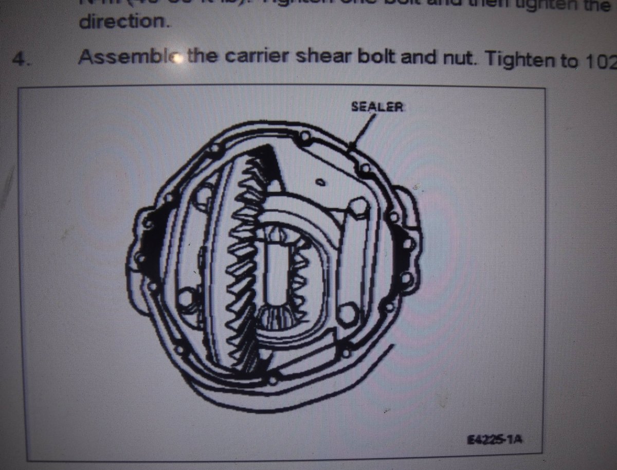

Photos 2, 3, and 4 of a Dana 35 8.8 front differential and axles

Your Dana 35 front axle is an open differential. It DOES "slip" or allow differential action between left and right sides. I'll see if I can find a video for you to see how that works.
Up above, in post #29, I believe, you list the numbers from a rear axle tag. 3L78 88. If you clean it and look closer, you will see that it really reads 3L73 88. That is a differential with an 8.8" ring gear, 3.73 to 1 gear ratio. The L stands for limited slip. That differential has the clutch packs and it limits or reduces the amount of slip between left and right side when turning or driving on surfaces with varying degrees of traction.
In a clutch type limited slip differential, the spring and clutch packs put pressure on the side gears to try to force them to turn together with the carrier and ring gear. More spring pressure = less slip. Some people try to force extra clutch discs or shims in it to increase the pressure. When the friction material in the clutch packs wears out, the effect is reduced until it finally operates as an open differential.
