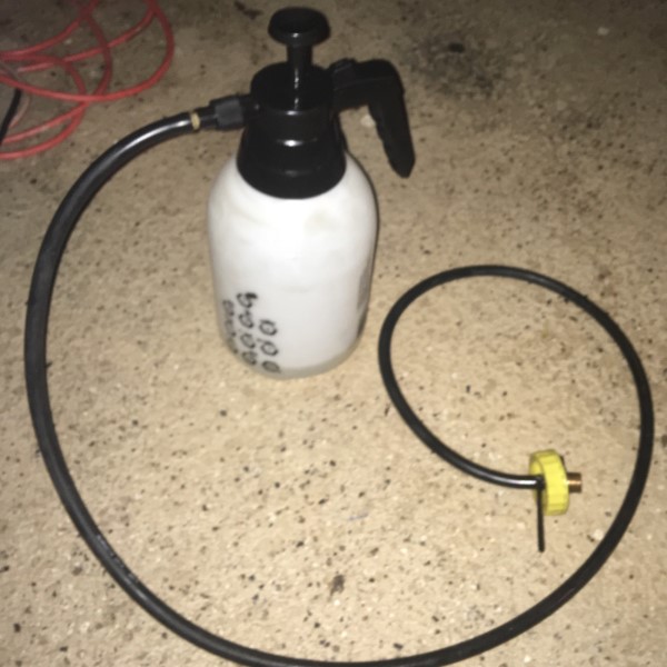

I'll take a picture of it next time I'm out there, but its just a small hand pump canister attached with some line to a reservoir cap that I've drilled a hole through and installed a hose barb. I just had the whole hydraulic system off the truck and reverse bled by pumping the slave cyl and was rewarded with some air bubbles. I'm thinking I didn't get them all, will take cylinders and res back off this afternoon to do some more.

I attached a picture of the bleeder I made.

Your pressure bleeder may be pushing air right back in where you're trying to remove it,. Don't know, just throwing it out there for points to ponder.
